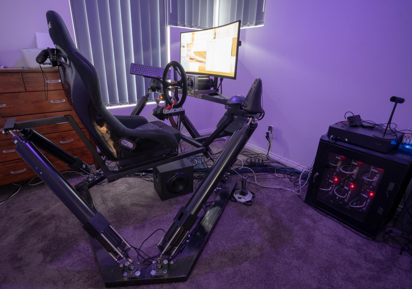

    Hi, very nice project !
    I have been waiting for a long time for someone to build a 6dof with these servos.
    Could you share the plan of your rig ?
    I don't know how to use design software but I know how to use a welding machine :)
  3. Peacemaker105
    Jul 18, 2017
    197
    Perth, Aus
    2,023Coins
    +361 / 2 / -0
    Hey, sorry for the late reply but I don't have any design files either. I literally draw everything up on paper and model what i need to and go from there. I have my rig dimensions on the page before this and i mention what size steel i used and from that you can figure it out. I basically just started cutting and welding and making things up as i went with the upper frame. lol. If you need me to measure certain, specific parts, then i can do that as you need, no worries.

  6. Patwo
    Patwo New Member
    Mar 10, 2020
    13
    98Coins
    Hai Chris,
    First of all a BIG THANX ... for your excellent and detailed explanation 1-7 :):thumbs, I read it a while ago but was quite busy till now.

  10. Peacemaker105
    Jul 18, 2017
    197
    Perth, Aus
    2,023Coins
    +361 / 2 / -0
    Sorry guys been a bit MIA lately.
    @cedric33 The Angle is 120 deg. it is in line with the angle of the base. So you could always just sit the top frame over your base and do it by eye if you wanted to, you would get it close enough.
    @mshockey22 No i haven't really looked into them too much as the price is a bit of a worry for me. I got a wedding to pay for haha. but you could always just go by brand name.. usually a well reputable brand is a good start. HIWIN maybe worth looking into. I'm currently looking at building my own ballscrew nut with delrin ball bearings every second ball to help reduce noise. i read somewhere it can help alot with that. I'll probably just stick with cheap ballscrews for the future as well and just get them from the same supplier this time and hopefully have a bit more consistency.
    The motors are fine. i'm only using 100w per motor and im 105kg with alot of peripherals. probably 180kg total weight.. they dont struggle at all. going 10mm pitch will make a difference but i cant see it maxing them out. PT actuator use these motors on theirs with 2510 ballscrews no problem.
    You get the metal enclosure for thanos controller from PT-Actuator, email shao and ask.
    As for spending more money.. i dont know really.. perhaps a nice chunky polished chrome rod for the actuators, perhaps 20mm screws.. work on a dampening noise, perhaps higher quality unijoints etc. I'm pretty happy with it really.
    @MrWolf I have a plastic donut like spacer i 3d printed which goes on the end of the ballscrew rod and held on with a C-Clip It has about 2mm clearance all the way around so its not always touching but at long extensions under load when the shaft does want to flex a bit it will restrict it's flex and have a rounded surface to avoid binding or damaging the inside too much while travelling.

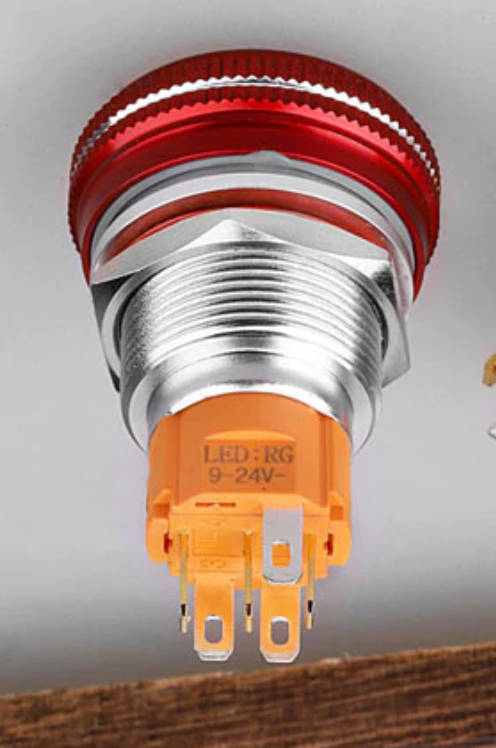

    I saw on your Explanation Video of your SIMRIG.... you have a shot of the 3D Printed Emergency button.... : 6dof Motion Simulator DIY - Q&A - What is 6dof? How did it come to be? at 1.10
    Could you tell me where to find the 3D Print file... and the wiring of it, Button , LEDs to the Thanso 15AASD ....?!.....
    I found some nice Emergency Buttons with Red and Green Lights as well ...but I need to know if the WIRING uses a common ANODE or CATHODE... ;)
    https://nl.aliexpress.com/item/33058030932.html?spm=a2g0o.cart.0.0.559a3c00KDKQu2&mp=1
    If you have some more info or a link to the info... much appreciated !
    Maybe Thanos is reading this as well.. as I saw the Emergency Button on his videos as well...
    Regards Patrick

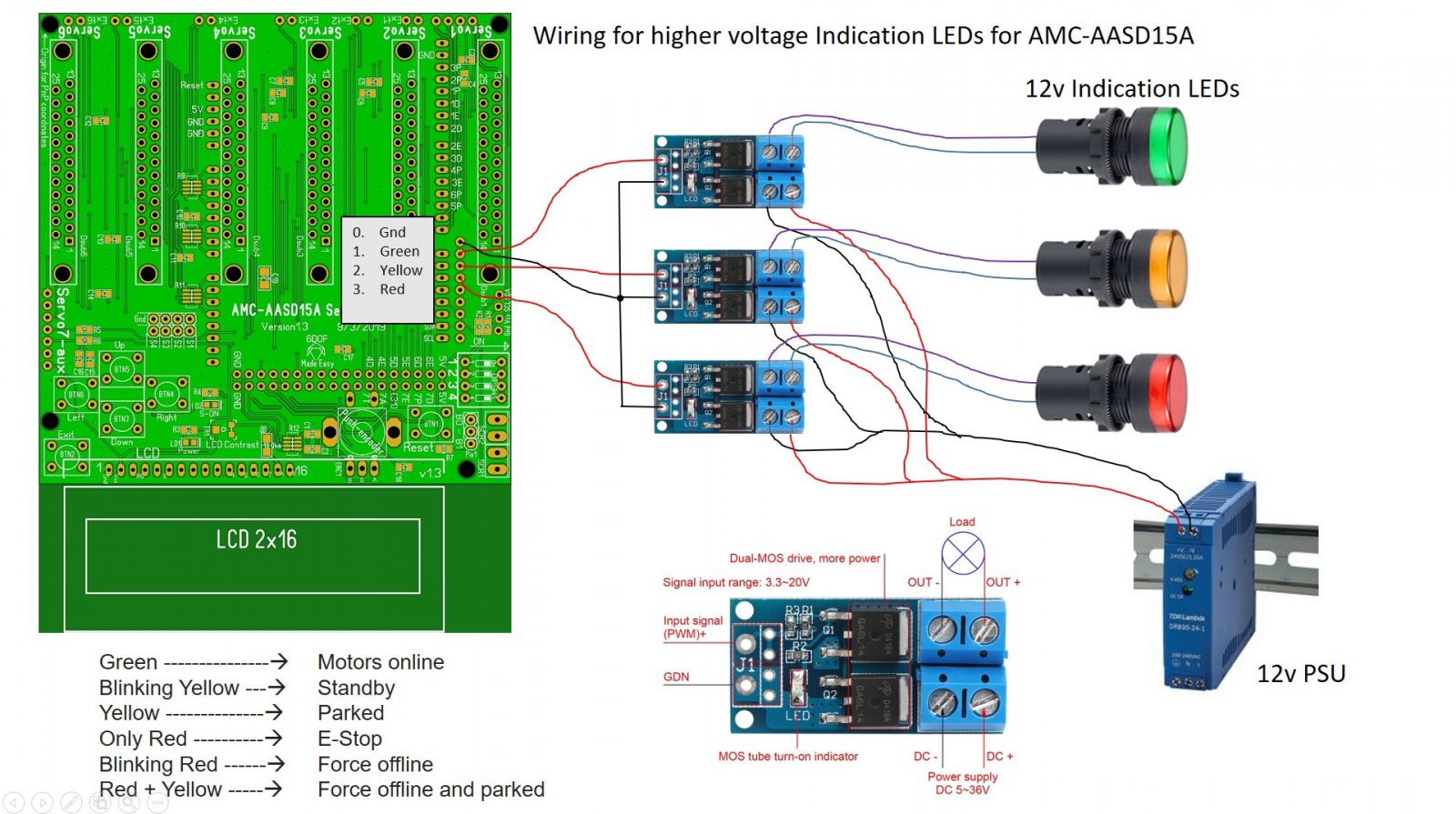

  17. noorbeast
    22,045
    153,866Coins
    +11,153 / 57 / -2
    You may find the FAQs helpful, see here: https://www.xsimulator.net/community/faq/emergency-stop-switch-wiring.56/
  18. Thanos
    Jul 6, 2017
    1,379
    Electronics Engineer
    United States
    2,907Coins
    +1,078 / 10 / -0
    The AMC-AASD15A uses Common Cathode led connection, but you need to wire 470 Ohm resistor for each led, if it does have usual 3v leds. And the e-stop itself is pull-down (connects the KLM signal to ground). There is no separate positive lead from the AMC-AASD15A...
    But the leds on this switch are not going to work directly to the AMC-AASD15A. They are rated for 24v...
    You would need to add some mosfet drivers for the higher voltage plus external power supply:

  19. Patwo
    Patwo New Member
    Mar 10, 2020
    13
    98Coins
    Perfect ! Thanx ....
    That is exactly what I was looking for ...,
    I have years of experience with building electronics and LED's, so the 470Ohm does make perfectly sense on 12V....,I did build my own Emergency Button for my (also self-build) OSW DirectDrive , including LED's...,
    I have a lot of 3 or 5 mm LED's laying around, all kinds colors, ...I think I can wire those up with the AASD15A directly, or with a small resistor, as they should light up from 1.7-3.0V....i will measure the voltage coming from the board.....
    I could also "open" up the LEDS as shown on your image or the E-Button...as they probably have a resistor/small electronics build inside to make them work on 12V ...or 9-24V.
    Ordered the common kathode version ...let see what arrives :)
    Thanx a lot once again :) ...
    I am going to connect and test your AMC-AASD15A and my first Servo within 2 weeks with my first TEST Actuator getting ready for assembly !!
    Is the 3DPrinted model for the E-Button and LEDS available somewhere? Otherwise I will design my own to work with simple 5mm LED's...
    Regards Patrick
