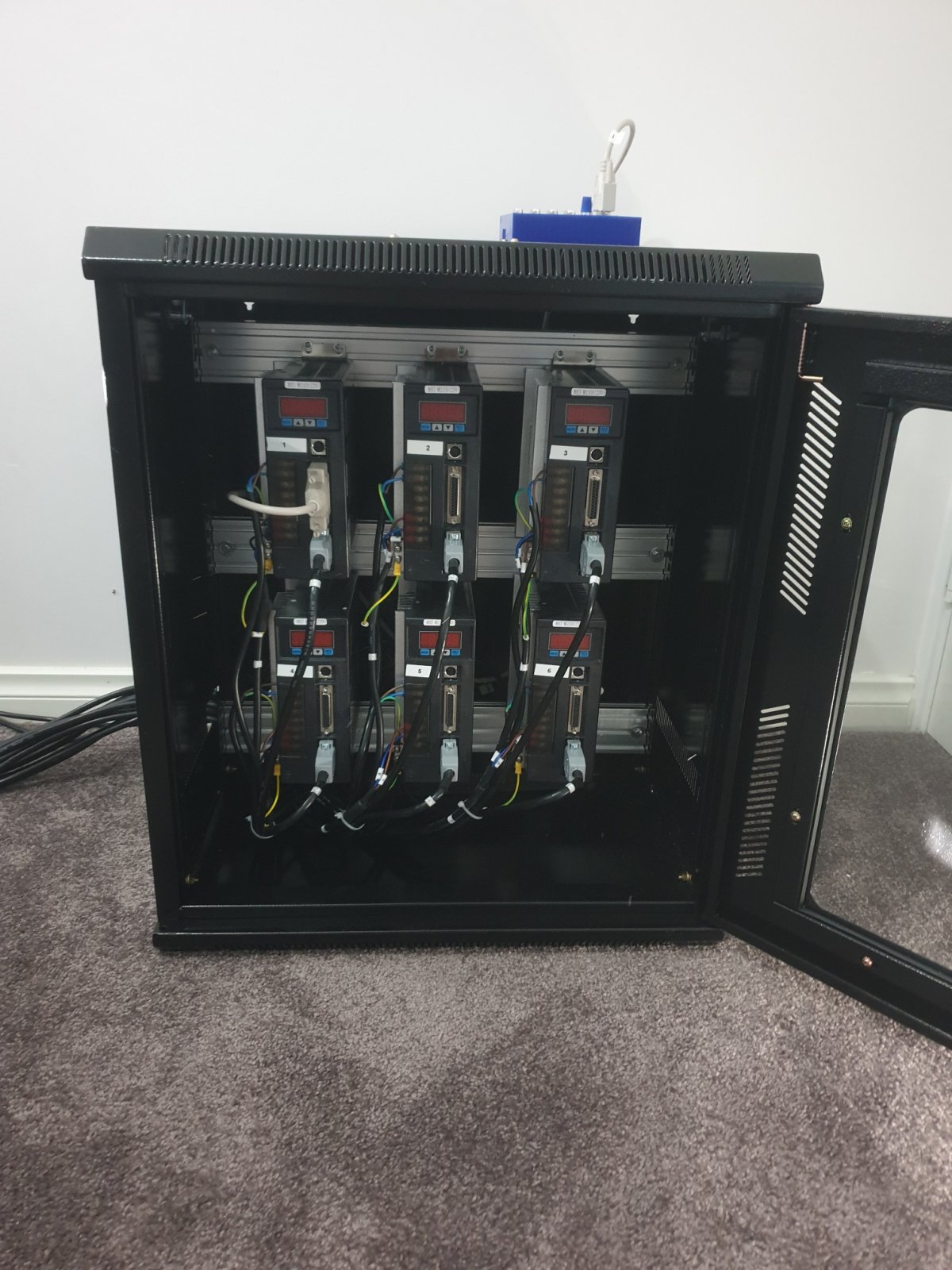

    What have you used to mount your servo drives? i've been trying to find a nice rack to mount them in but cant find anything?

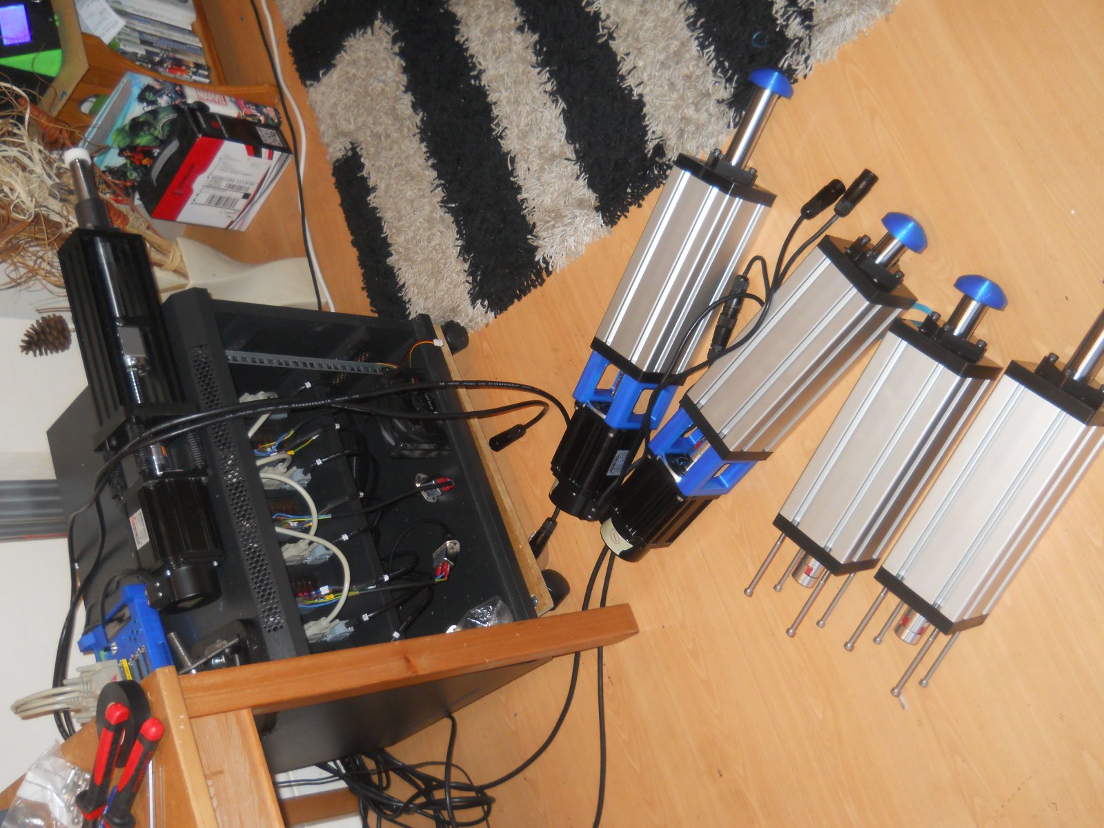

    Hi @Peacemaker105 loving your progress , keep up good work , i bought a 9u rack via amazon see attached pick cost about £60.00 and its big enough for me to fit 6 servo Drivers when the time comes , at the moment i have 4 drivers but will be buying another 2 soon ( post xmas bank account depletion recovery mode :) )

    Cheers for that,that cabinet looks perfect and they pretty cheap on ebay!

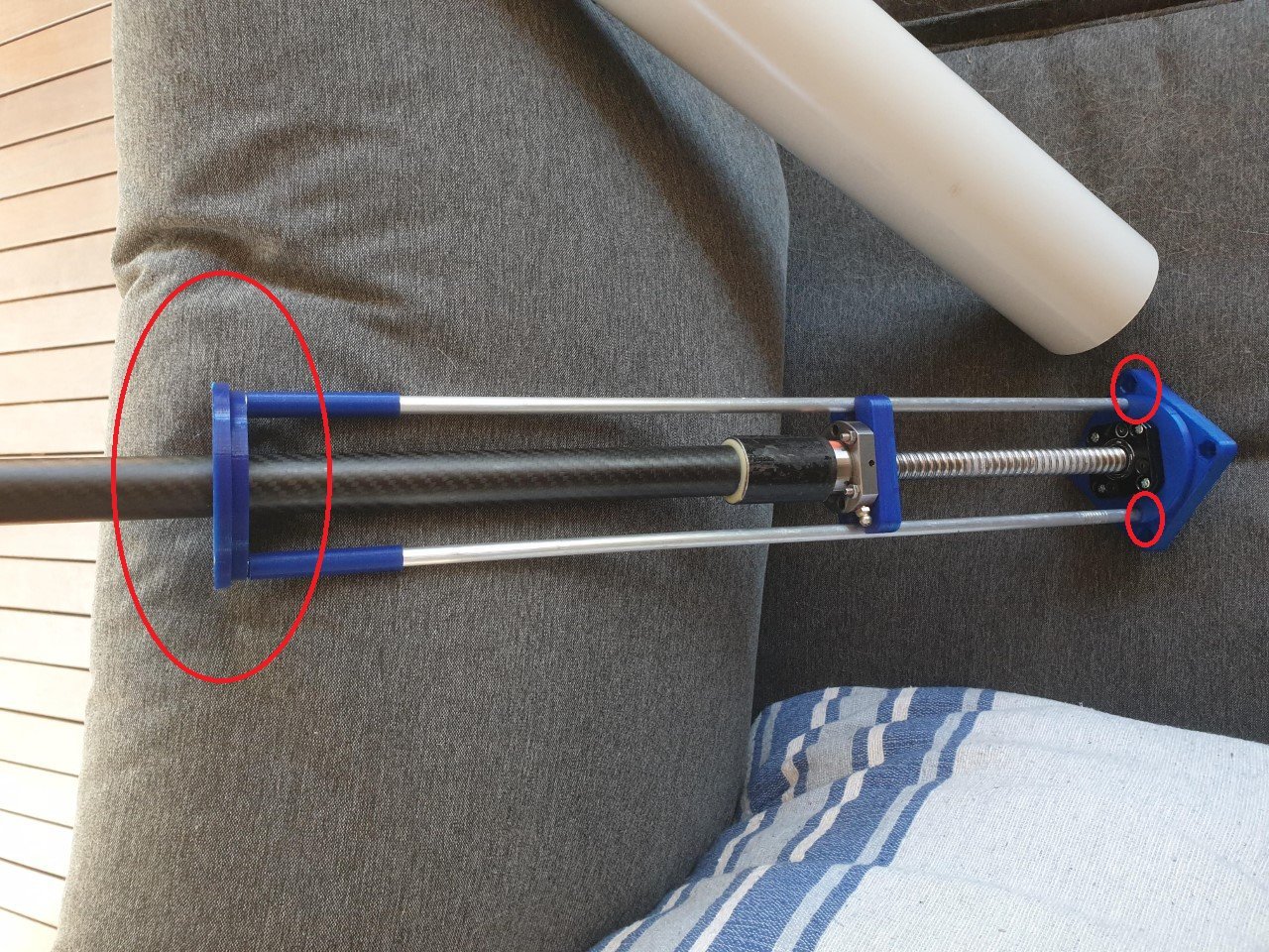

    all really love your actuator design, how do you fix here :
    and what are the both axis ? just round steel or alu ? what diameter ?

    Hey mate, updated the first post earlier with all the details on the design with links etc. Its 8mm Alu tube with 2mm wall, drilled and tapped to M5 thread the tube is slightly shorter than the PVC so you can screw tight and pull the end plates tight against the tube to stop it spinning. I think in my final design it will print a keyway at each end and cut out a notch on the tube to also assist, or put a hole in the side with a 2.5mm brass insert and drill a hole through tube and fix it that way. either will work and just give a bit more security in case they loosen over time.

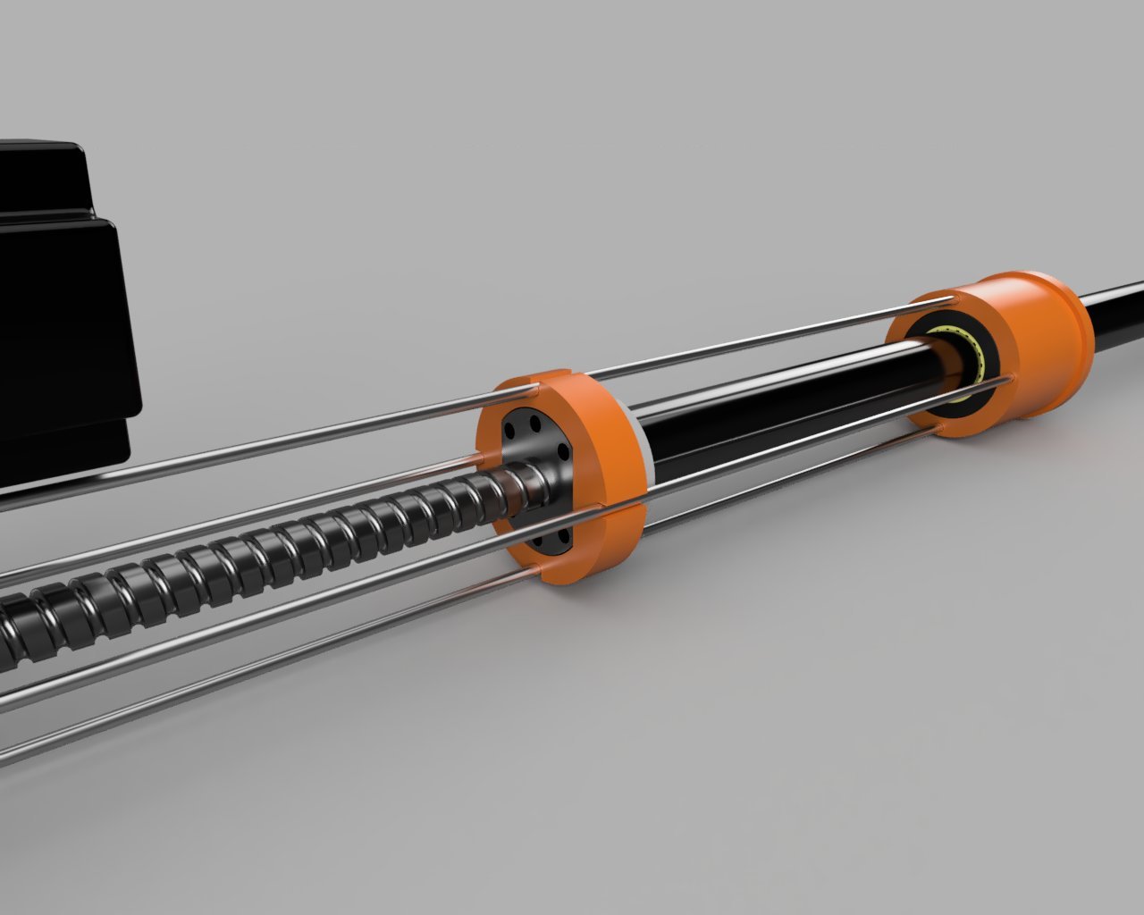

    Ok thanks a lot, I really love your design, I tried to made one inspired by :

    Nice work mate! I like it. I initially had 4 rods also but thought i'd try get away with 2 and minimise materials haha. Time will tell i guess. So your picking up the 4 holes on the Igus bearing? i did think about doing that. might have a play around with that actually but from memory the holes in the linear bearing are 4mm clearance and i'll need to drill them to 5mm clearance, then i'd probably need to get socket head cap screws instead of hex bolts due to wall clearance but if i invert the linear bearing that could work.
    Initially wanted to invert it and use it as an end stop but i hacksawed them and they're all different lengths. I use to think the Thanos controller calibrated both lower and upper end stops which would have given each actuator a different length. But now i understand you just set the length yourself i could actually invert them no worries and use them as hard stops, just set max stroke to the actuator with the lowest clearance. if that all makes sense..

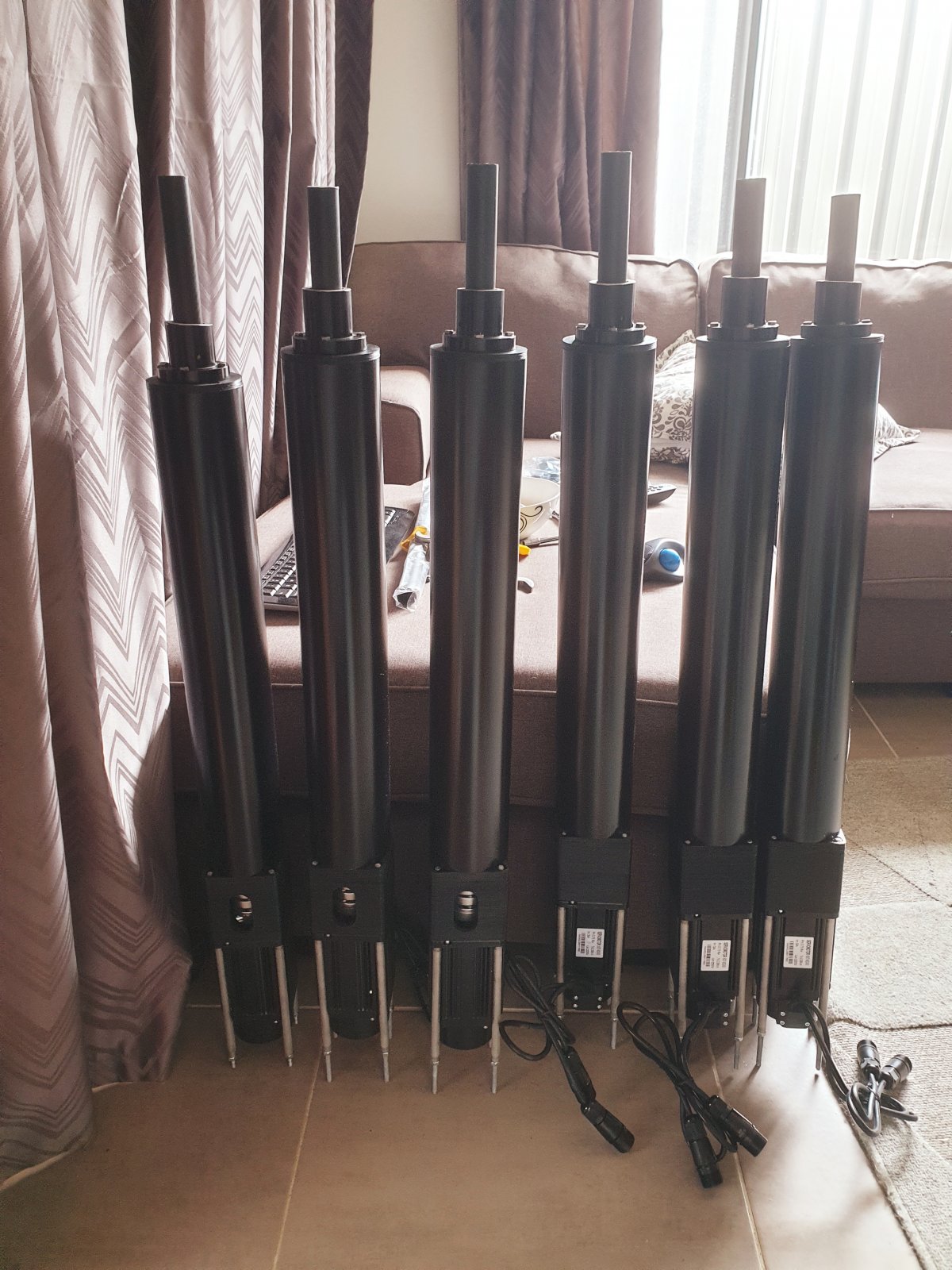

    Little update. All actuators assembled today. Hopefully I tightened all the bolts haha. Here they are in all their glory..

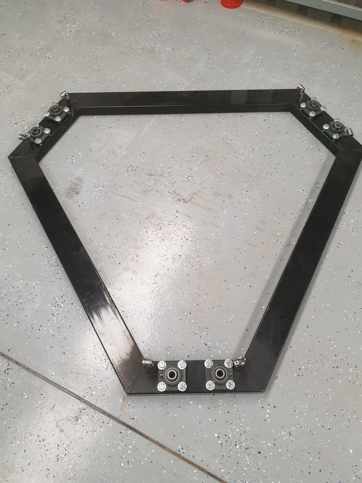

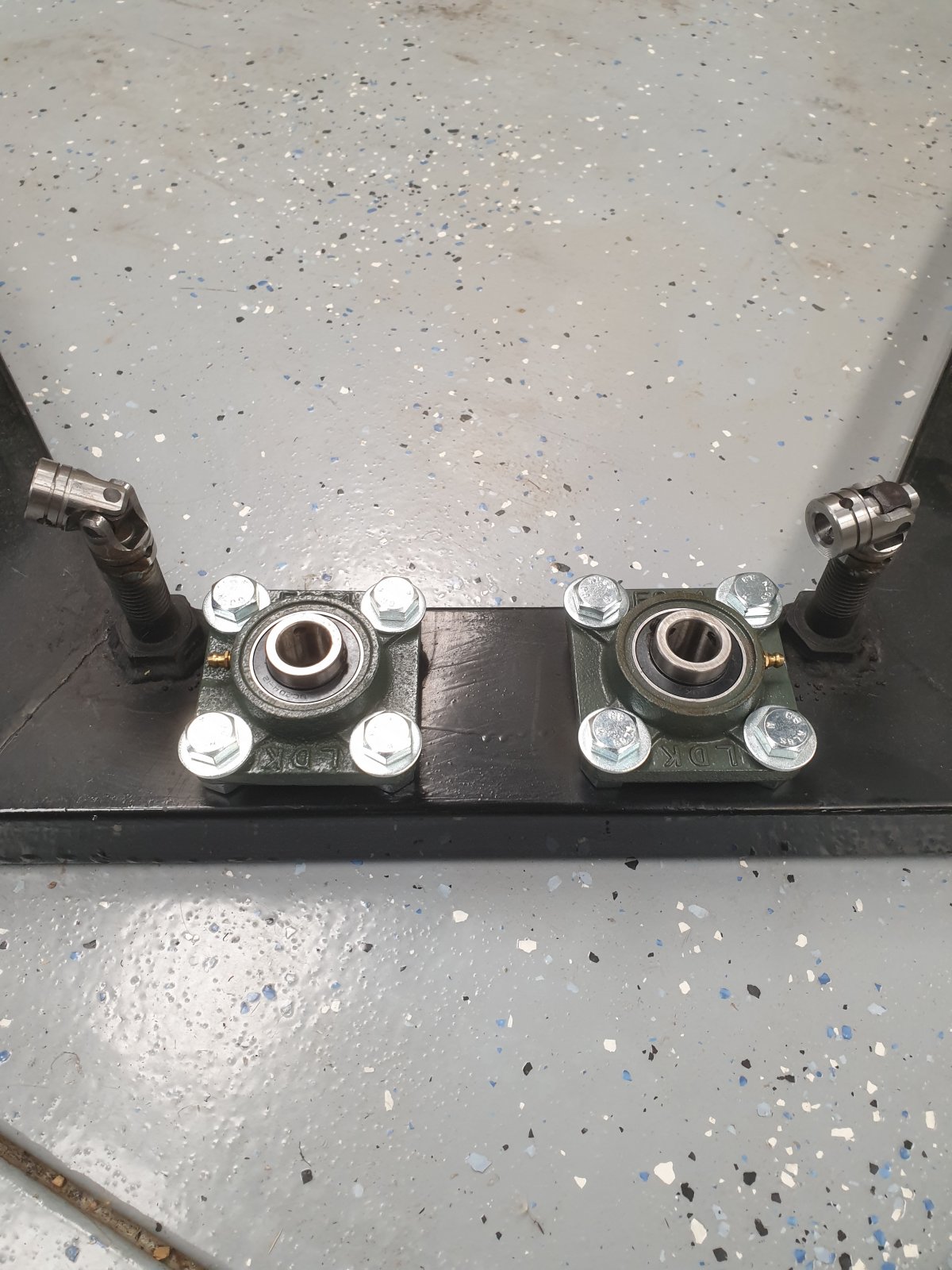

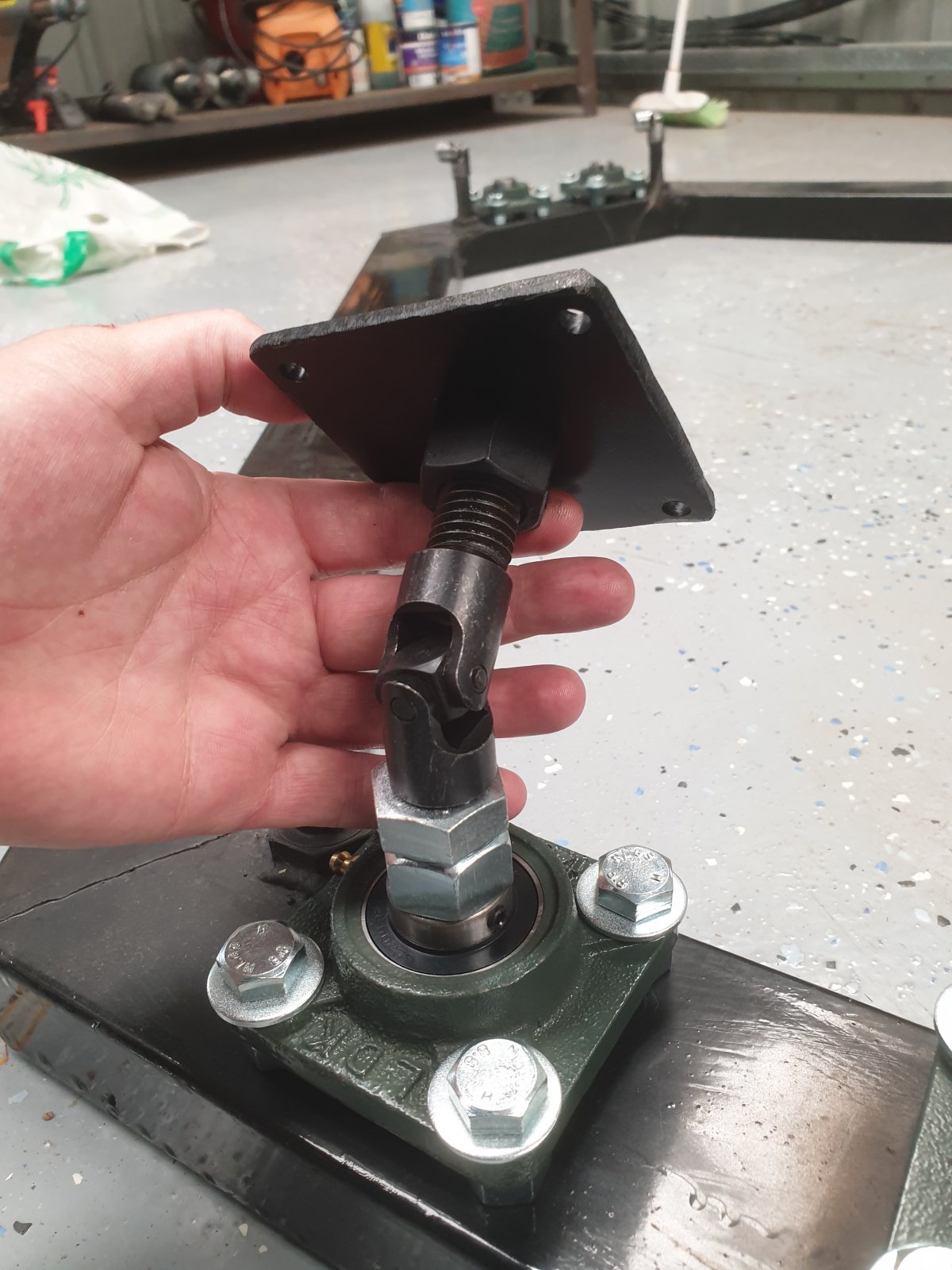

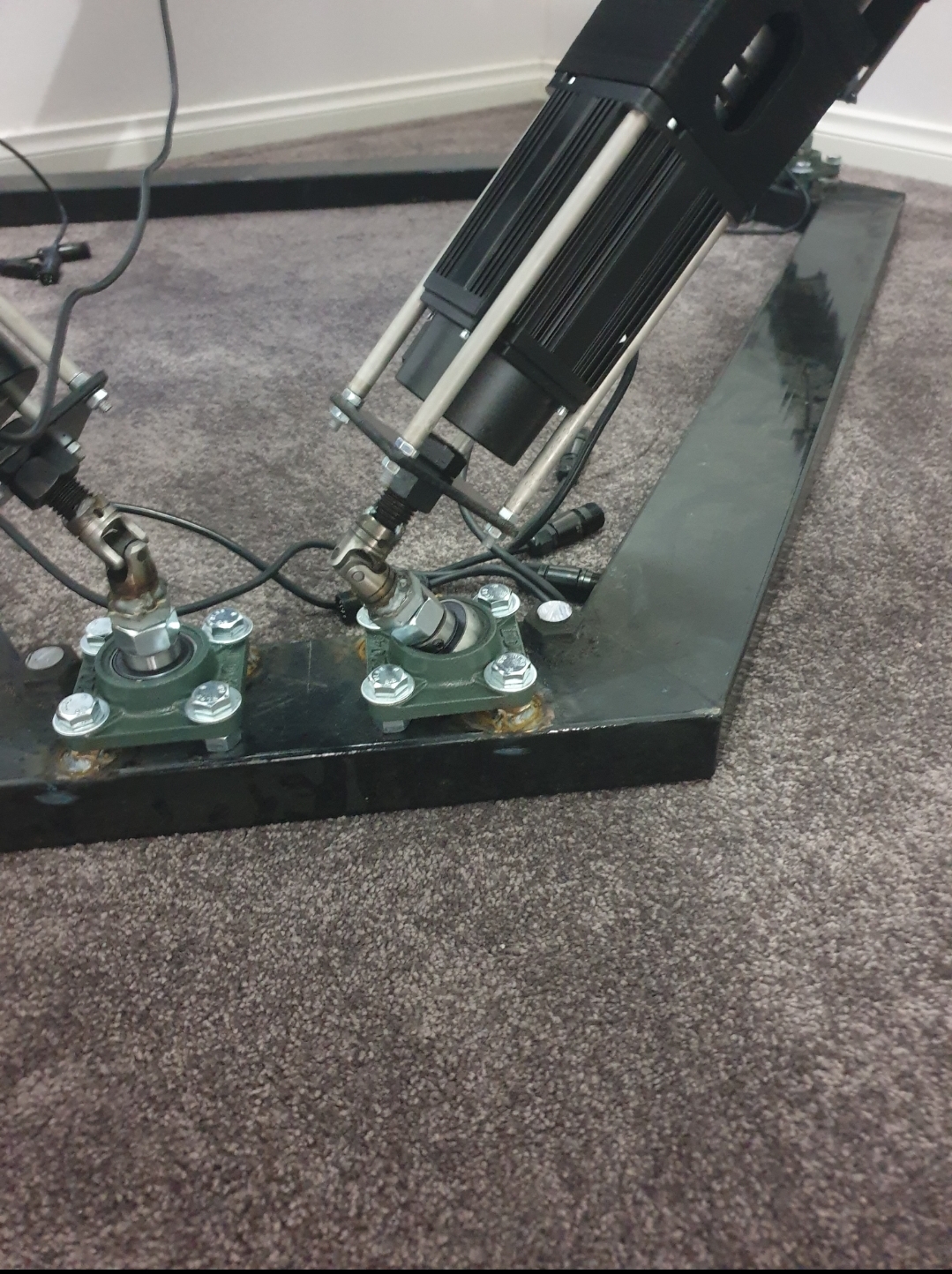

    Tomorrow I will be mounting my new pillow ball base plates. So the idea is they will allow the actuators to rotate a little bit in certain movements. Similar to the PT Actuator uni joints but at about 1/15 of the cost haha. Hope they work as intended.. (EDIT: they didn't work as expected, so i've just bolted them to the pillow balls and bolted the Nut down on to the frame to stop them moving.. work good for getting the universal joint lined up though haha)
    Then the next thing will be to assemble. I'm also currently installing the servo drivers into a 12U server case so looks like my weekend is going to be a busy one. :)
    I'll update some more as progress happens.
    EDIT: The pillow ball mounts didn't work as expected, they counteract the uni joint. So i have since put a nut on the other side and bolted them down to the frame on the nut. So they can't rotate or swivel on the ball joint. Still came in handy for aligning the unijoint with the angle of the actuator before clamping tight :)

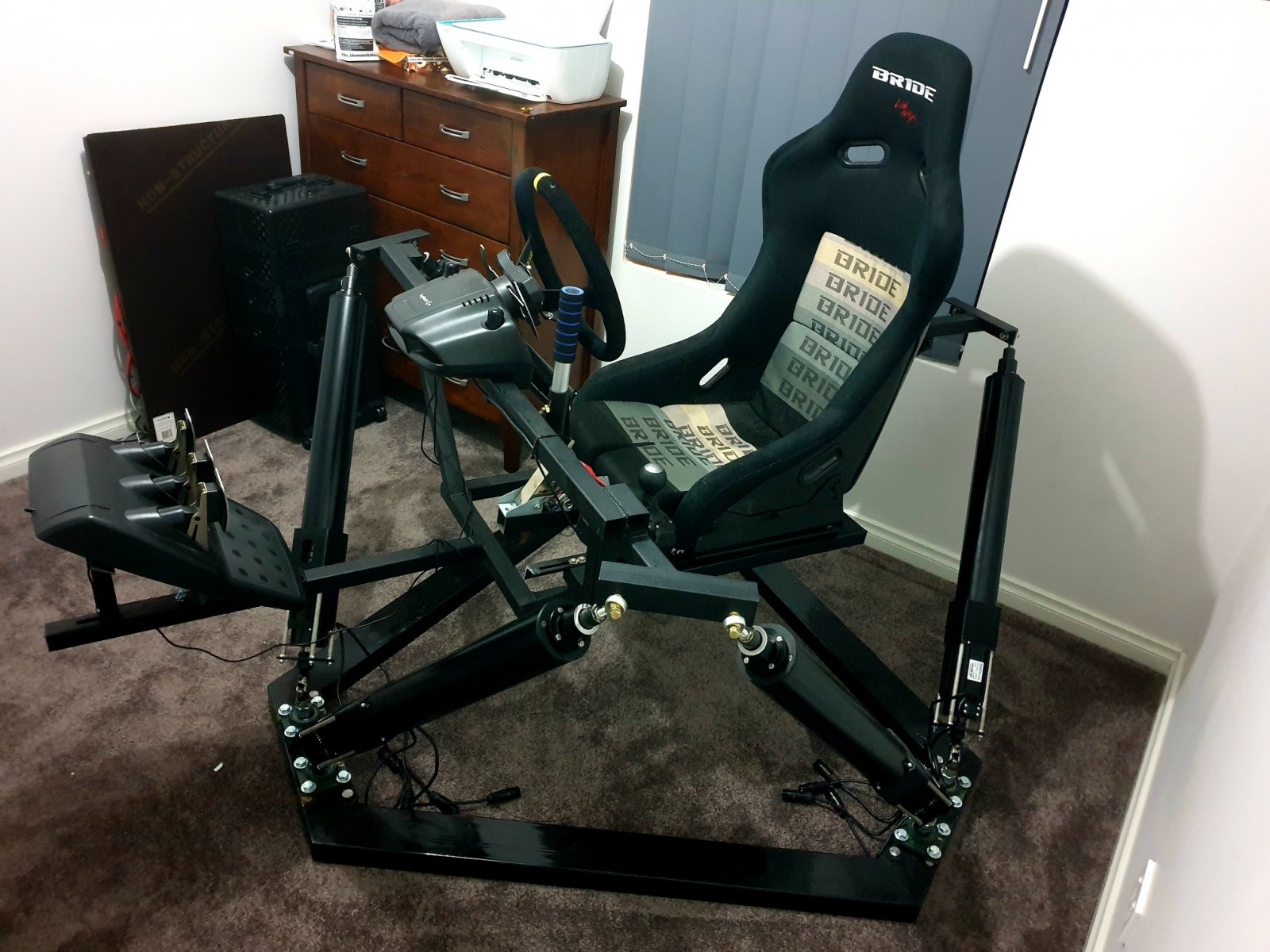

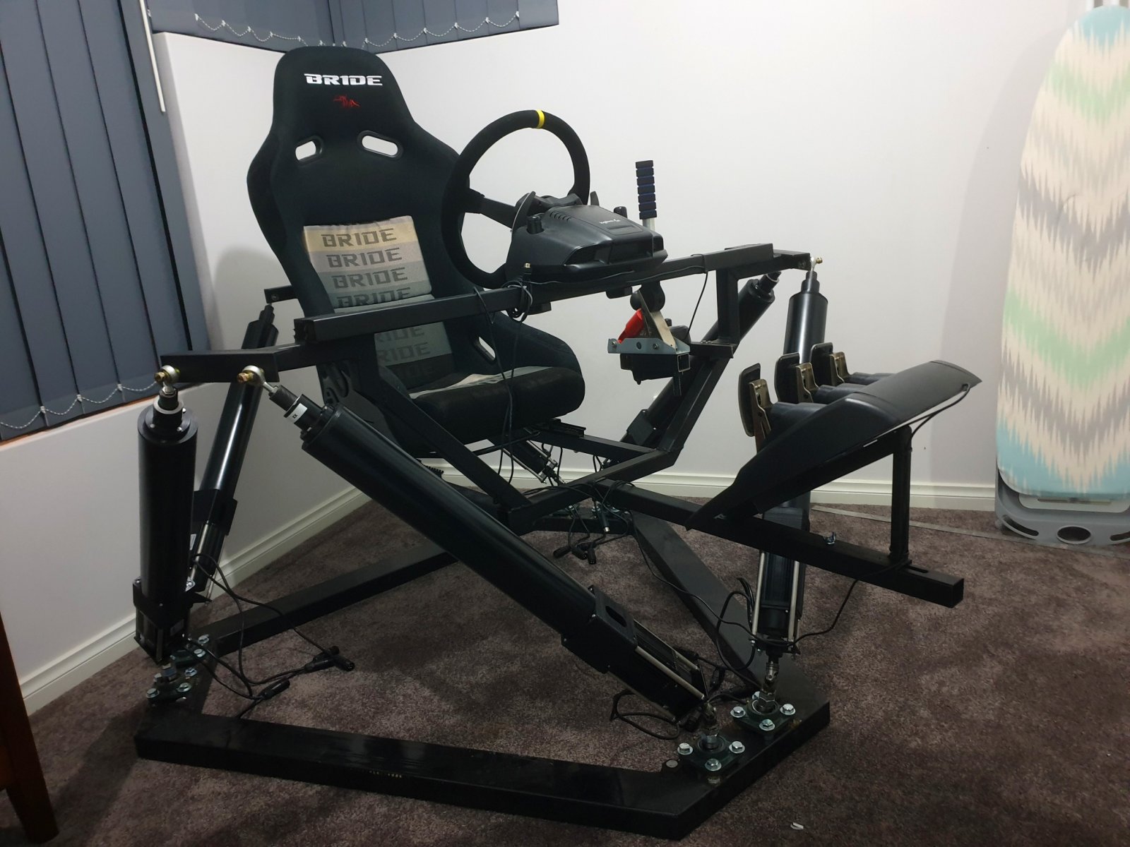

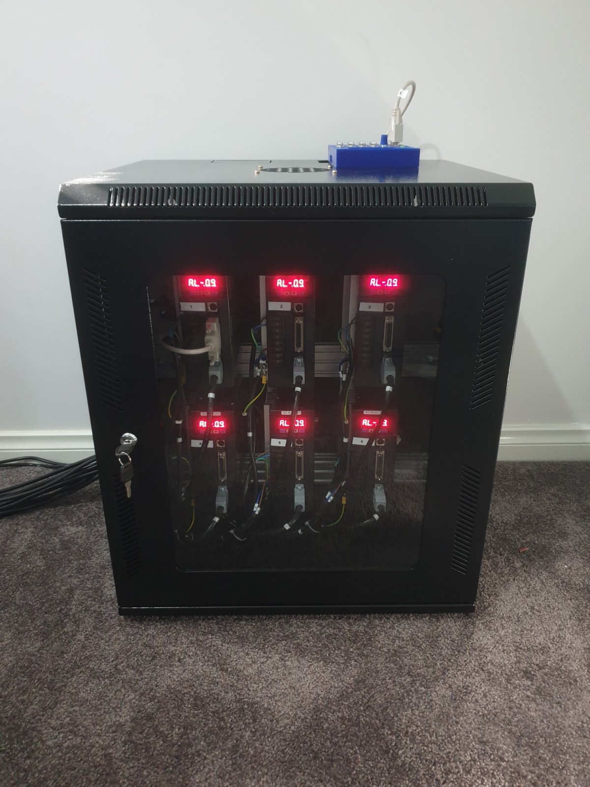

    Well shes all back together now and looking pretty sleek. Pretty stoked. I will be more stoked if it works haha.
    I also finished the cabinet today! So much tidier than my previous jungle of wires haha.

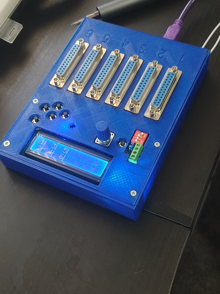

    Now I was silly and thought I had ordered 6 db25 cables but I only ordered one dammit! No local shops sell a male to male cable.. I'm so impatient and want to test it out and now 5 measily cables are stopping me from doing so. Oh well.. I might just go to Jaycar (like radioshack) and make my own cables perhaps..

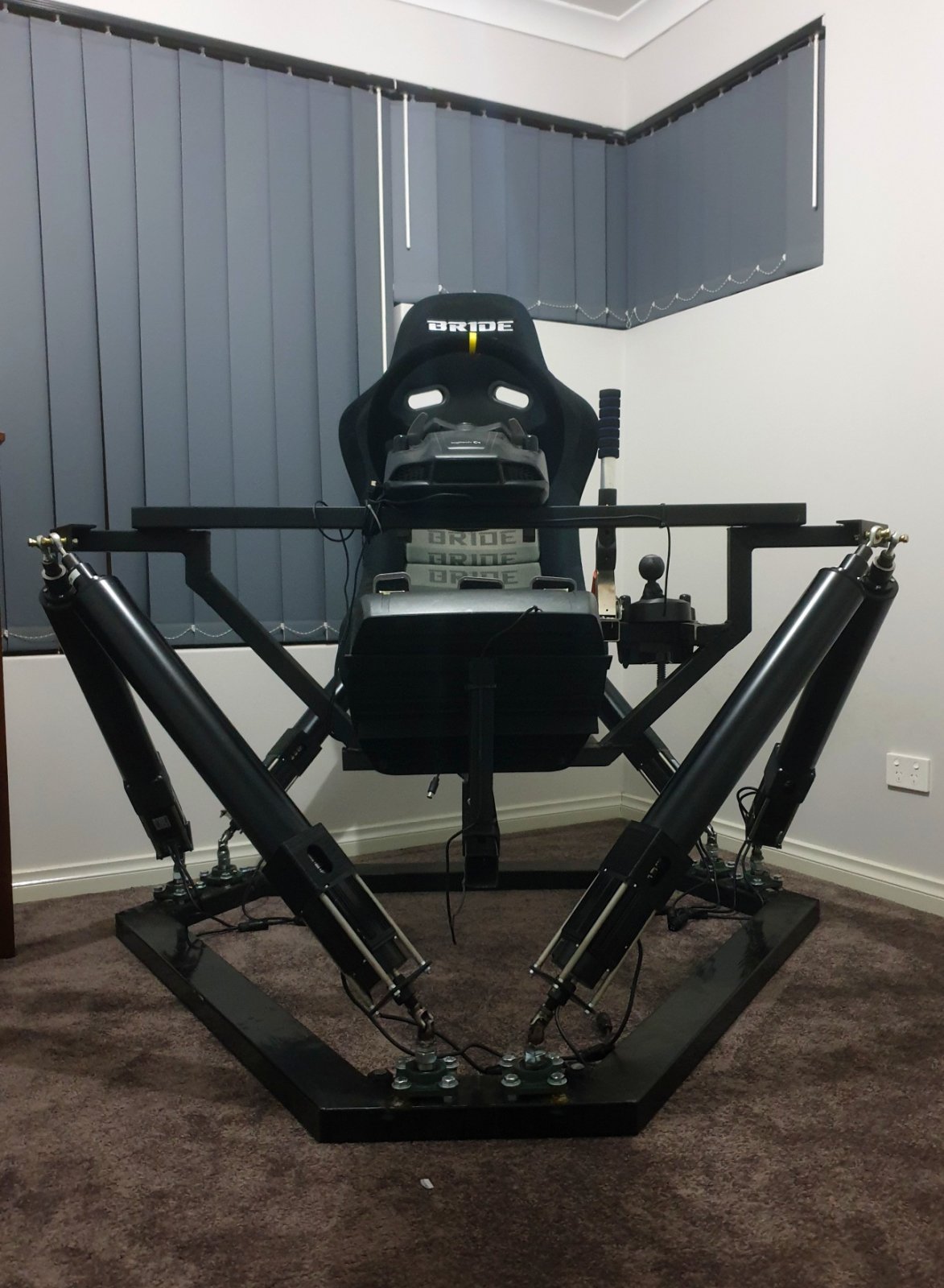

    It's Alive!! :)
    Few things though.. not sure what axis order i should use to get the rig the move the right way.. when i input surge it goes side to side on and angle rather than forward and back like the 3d viewer.. i changed the axis string a few times and it seemed to keep doing the same.. not sure whats going on. I have set my actuators up in the same order FlyPT uses in the diagram. hmmm.

    Righto after hours of testing I finally got a lap in.. and then my camera battery went flat haha so here you go! Special thanks to Coops for the amazing profile and Thanos and Flypt for the obvious!! I'm in sim heaven right now!! Its So smooth and fluent and I can't stress enough how much adrenalin I was carrying after this test :). Thank you all.

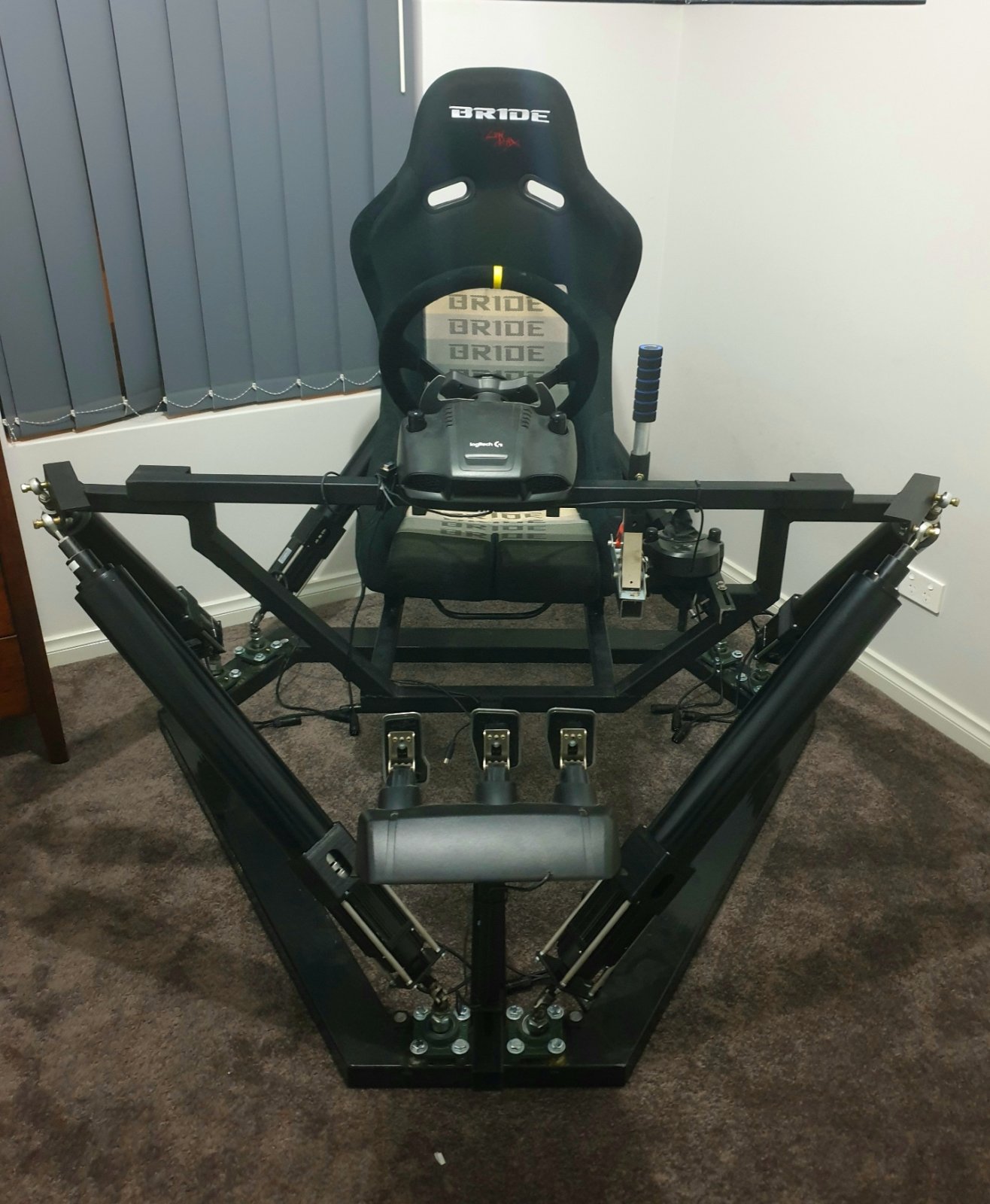

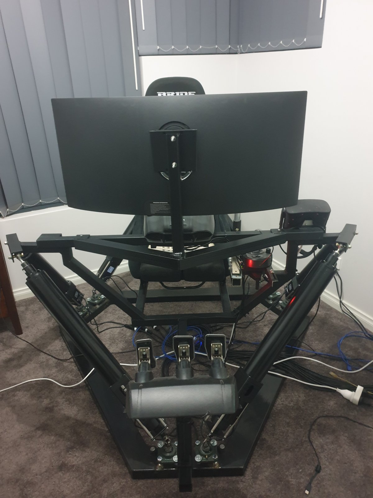

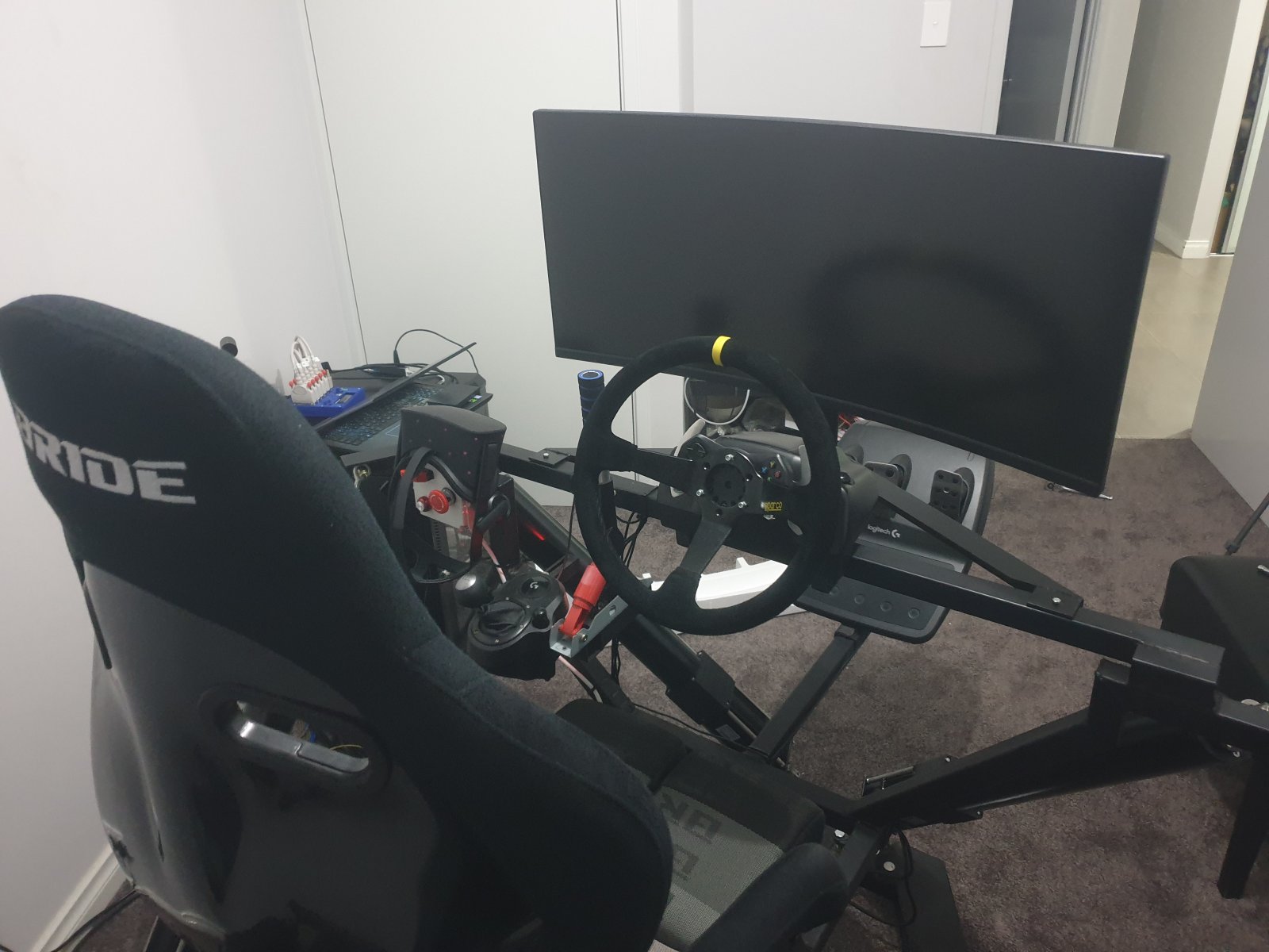

    Mounted a screen yesterday. Now i can plug in my main PC and more easily sit in the rig and tune stuff on the fly and game in higher frame rates.
    If anyones interested, It's a Kogan 34" ultrawide 3440x1440 @ 144hz. Spec sheet seems good. Keen to give her a whirl soon.
    I used all the steel i had left, laying around so it could do with perhaps center brace. But hopefully will do for now and a bit of testing :)
  19. JAD
    JAD Active Member
    Jan 17, 2016
    205
    Australia
    1,446Coins
    +142 / 3 / -0
    Looks great. Well done. I'm thinking of a do over myself with more room around the seat like yours.
    I was looking at the video and noticed a lot of slack in the bottom uni joint.
    I think you will get a big improvement road vibration/rumble strip feel if you swap it with something much tighter.
  20. Peacemaker105
    Jul 18, 2017
    197
    Perth, Aus
    2,005Coins
    +362 / 2 / -0
    Cheers, Wow, Good eyes! :p haha
    Yes the trial with these pillow ball mounts didn't quite work as i had planned. i thought it would help with certain yaw and sway movements and avoid the unijoints binding and putting strain on the actuator but under fast movements they free spin a bit. obviously only as much as the upper Rose joint allows but yeah i didn't anticipate that kind of behaviour when thinking it through. If i did the same setup at each end of the actuator it would work but yeah, oh well. The cost of R&D lol. I have a simple fix in mind, just put a bolt on the other size of the bearing and then tighten it down to the base. No more Z axis rotation.
