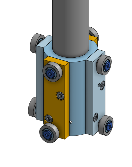

  11. lromaniuk
    lromaniuk bny
    Mar 23, 2018
    27
    Software Programmer
    Poland
    366Coins
    +20 / 0 / -0
    I have ordered TBI Motion ballnuts from alibaba - at least they look genuine. Payed around 42$ per piece (though mine are TBI SCNH 1610 - no flange with key) + shipping to Poland - total was almost 300$. I didn't order ballscrews cause shipping cost would be so high that it was more sensible to order them from polish TBI reseller. If you would go this path check TBI ballscrew datasheet - some ballnuts require different kind of ballscrew - like mine SCNH :roll.
    For this particular application C7 grade is more than enough. You're not building a CNC milling machine where C5 or lower would make a difference. Also cost is much higher for more precise ballscrews. The same goes with manufacturing process - rolled ballscrews are perfect for sim application - no need to go with ground ones.
    What can help with noise is propper alignment of ballscrew with actuator piston rod axis. If for example sliding bushing of piston is not aligned axially with ballnut-piston assembly and bearing block of ballscrew, stress will cause more noises coming from ballscrew - also it will cause more wear on missaligned parts.
    Another source of noise is anti-rotation - this can make a lot of noise if not done properly. I went with small PU wheels for my actuator build - they are soft enough to align to surface imperfections - and belive me - anything rigid requires sub milimiter precision to work optimally.

    I noticed that too :) having the ball nut perfectly aligned axially with the pushrod made a huge difference. But achieving this alignment is hard, considering the inaccuracies of my FDM printed design. I had 4 screws connecting the ball nut to the pushrod. I noticed tightening only two of them would reduce noise significantly. I suspect the four screws have over-constrained the ball nut and relaxing two constraints allowed the ball nut to self-orient along the actuator axis. Less really is more in this case :)
  13. Dirty
    Oct 15, 2017
    746
    All the way up front.
    7,971Coins
    +888 / 3 / -0
    That's an interesting thought! I have never spent much consideration on the noise coming from the internal constrainment of the ball nut, but using rollers sounds very interesting. Too late at this stage for me to incorporate it into my design, but keep me posted how it works out for you.
    Where do those rollers roll along? Do you use aluminum extrusions? I'd be curious to see more CAD rederings of this concept.
