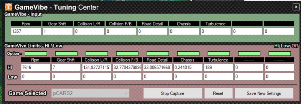

    Motion platform
    I managed to get numbers into vibe tuning but that was only by clicking mute on all the vibes

    With Game Vibe I can only get sounds from the sound card assigned to "Sound Card 2" I have tested by configuring each physical sound card with "Sound Card 1" and "Sound Card 2". Each one works fine when assigned to sound card 2 so ruled out a physical sound card issue. Also Dirt Rally works fine so think it is possibly PC2 plugin related. Is anyone else having this problem?

    @Jakub - I had to use the following procedure to get it going
    Reboot computer (I neede to do this if I have been running other games with GV and was important step)
    Load SimTools Game Engine and Game Manager but NOT Game Vibe
    Load PC2 Game
    Enter a practice session (or whatever) and make sure car is moving on track
    Turn off main toggle in Game Manager
    Run/Open Game Vibe as Administrator
    Game Vibe may error (if it does close Game Vibe down and re open again as Admin)
    Turn on main toggle in Game Manager
    Then I had sounds and data to Tuning Centre as expected. I still however only have configurable sound through "Sound Card 2" which I think may be a different issue.

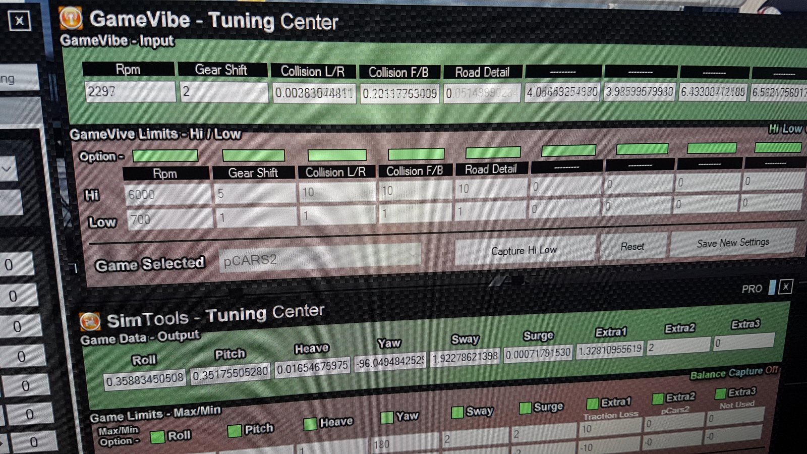

    There is data in plugin 2.0.5.2
    But.. no sound to the buttkicker.
    Sound card settings are correct. I can do some tests of sounds in the card settings and also when i use Vibe Creator.
    Still no sound in the game.

    I have it working ok but start game vibe when on track and I some times need to turn the main on/off toggle on game manager a few time before vibes come through. Also sometimes it crashes game engine on start but I restart it and it gets going after a few on/off toggles
