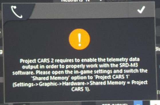

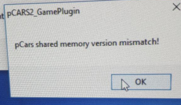

    OK here is my problem with the interaction between simtools, PCars 2 and my Renovatio
    SRD-M3 SLI display.
    I get this message up when I launch PCars 2 from the SRDM3 screen:
    So I go into PCars 2 and set the shared memory but I then get this pop up
    I think because of this mismatch, it prevents the motion rig from operating. PCars 2 still works fine.
    If however I launch PCars 2 on its own (not through the launcher), PCars 2 works fine with motion but obviously, I dont have my SLI display.
    I think I'm using the latest plugin.
    Anybody got any ideas?

    Hi Andy
    Can you please run this plugin and share a screenshot of Tuning Centre and of the plugin message box about the memory version mismatch? Thx!

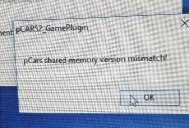

    Hello again value 1.
    Did as you asked and got the same result of no motion. Images attached.
    Sorry images are poor and I couldnt seem to reduce the size, sorry.
    Any ideas?
    Andy

    Hi Phaze11111,
    Tried what you suggested (switching shared memory to Project Cars 2) with no change.
    Without the SLI display, motion is fine. With The SLI on, no motion.
    Could it be something to do with the shared memory information only being able to go to one other device?
    Im clutching at straws obviously.
    Andy
