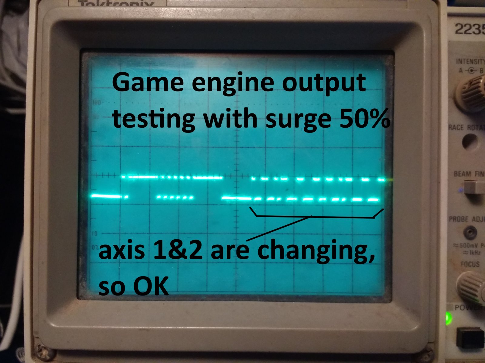

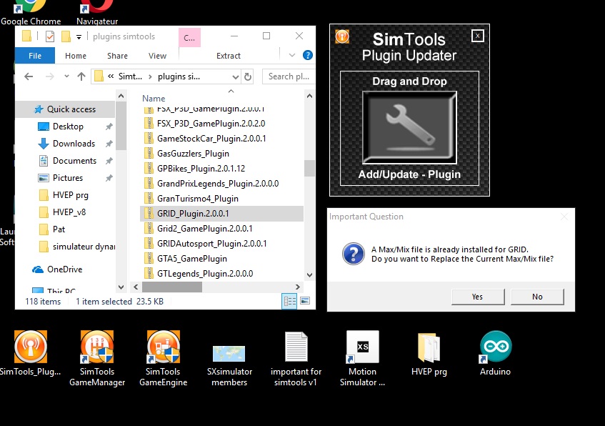

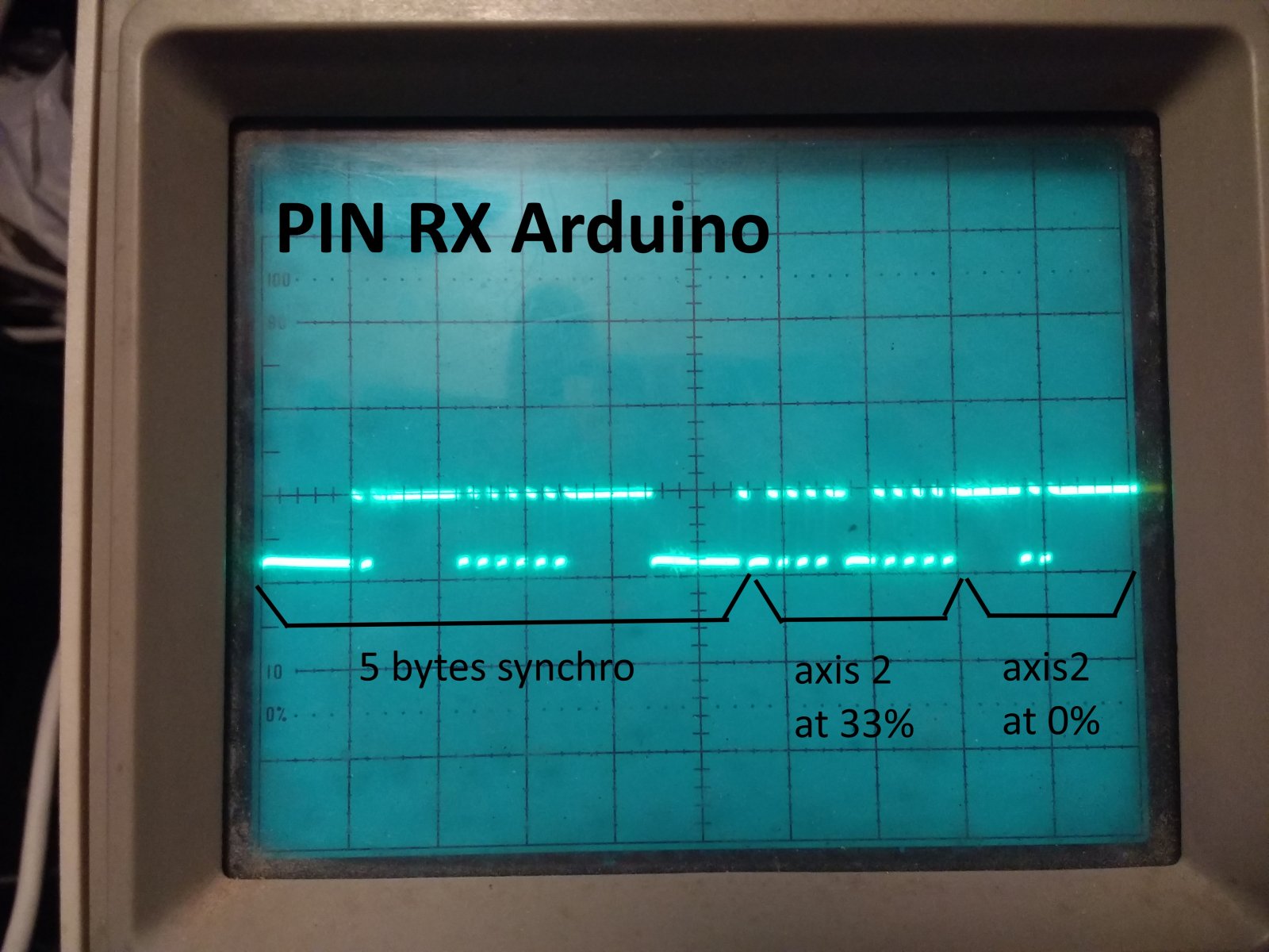

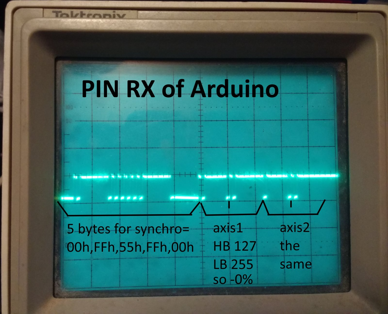

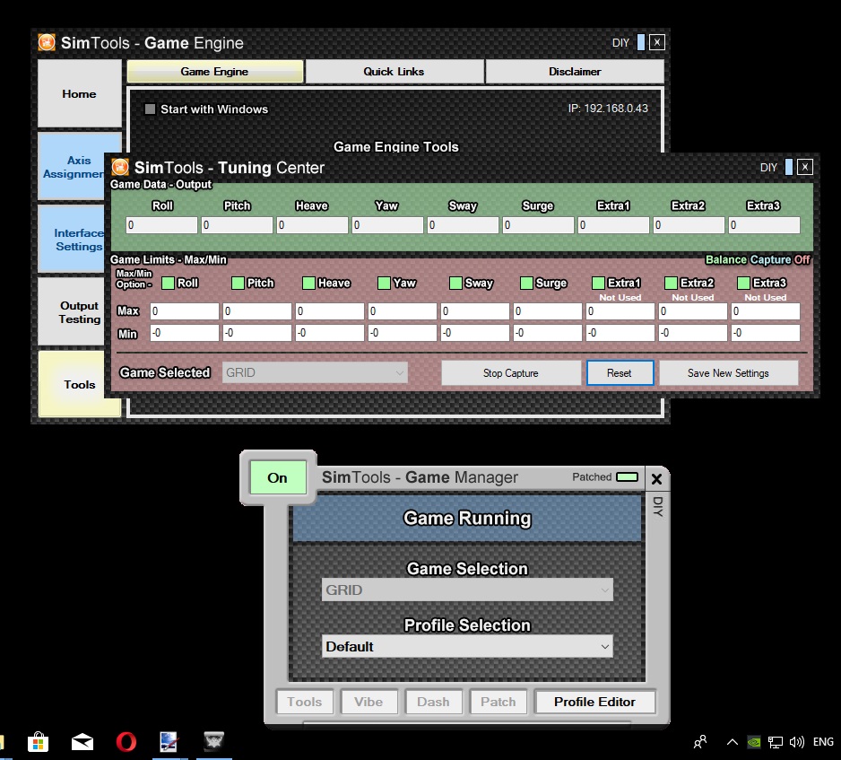

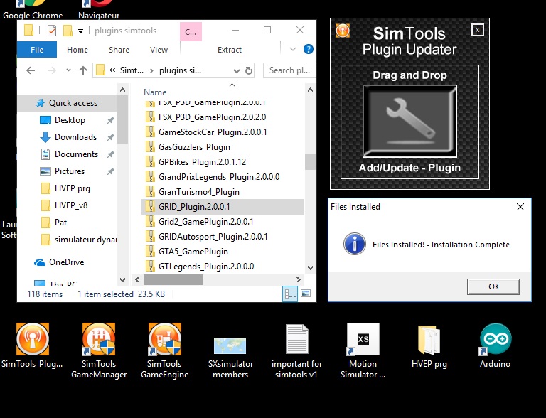

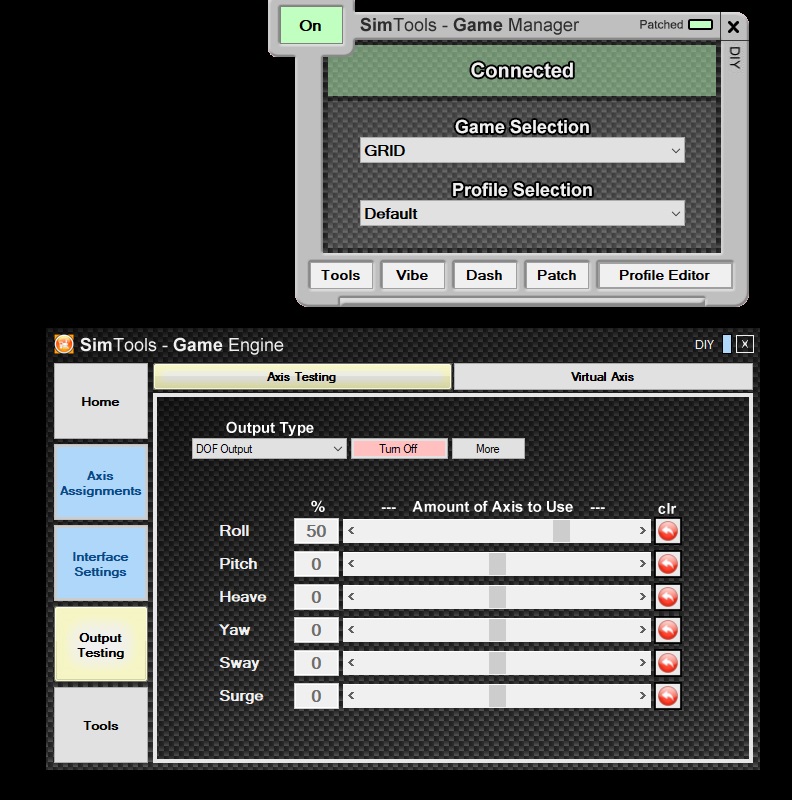

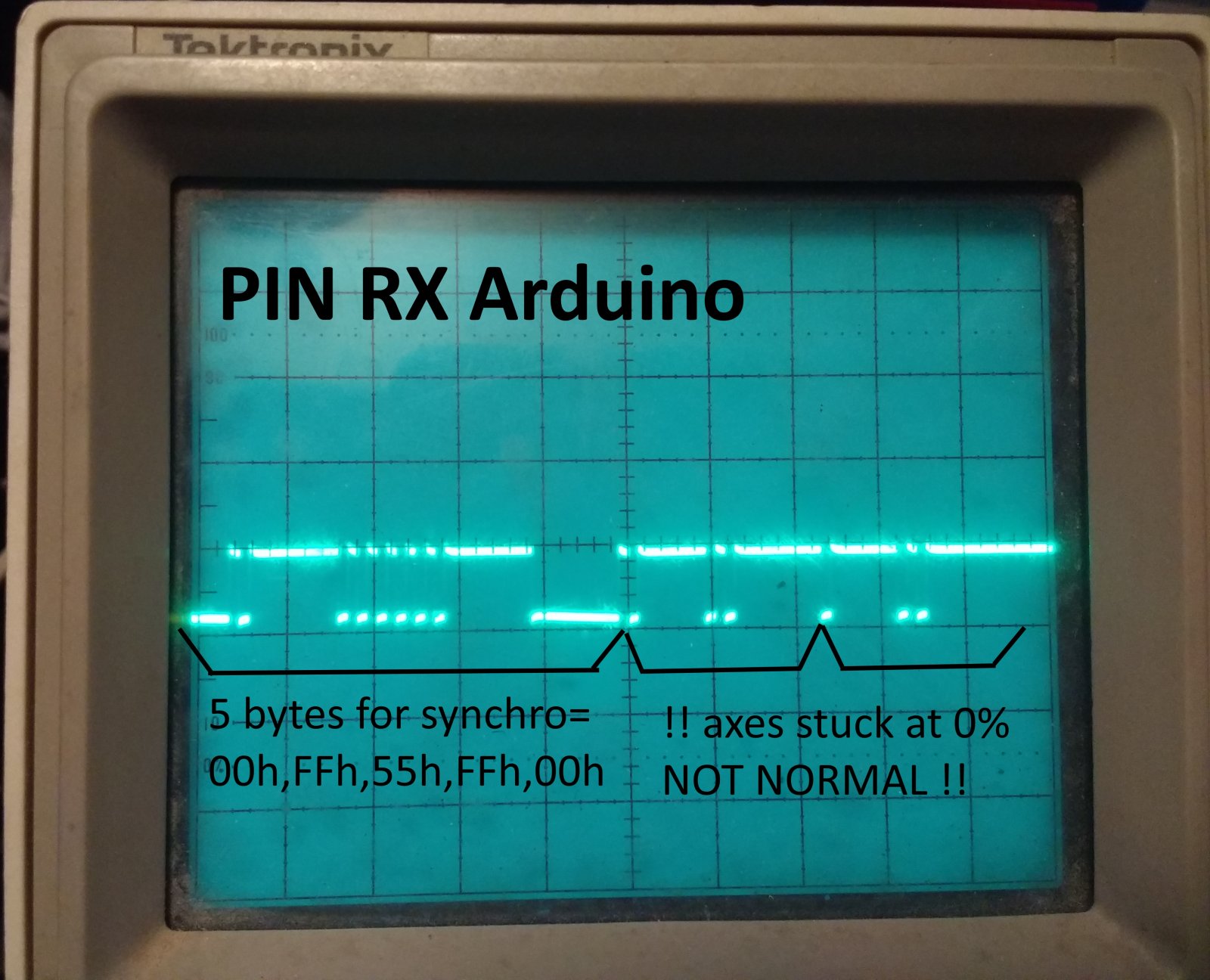

    Hello, I have succeeded to run rFactor and GTR2. But now I do not reach to do the same with GRID.
    All seems correct, the patch GRID_plugin.2.0.0.1 has been succesfully installed, the indicators in game manager, and game engine are in blue, but when I play no data are sent (checked with an oscilloscope + the tuning center).
    Do you have an idea ?
    thank you

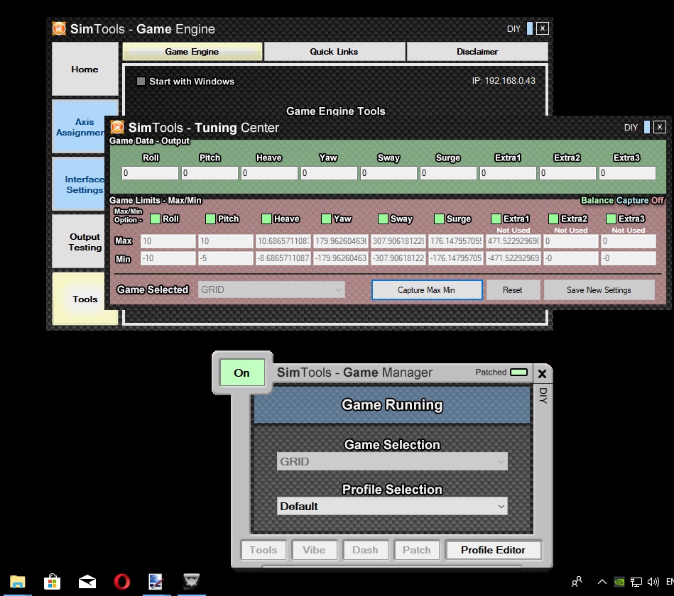

    What do the Max/Min settings look like for the game?

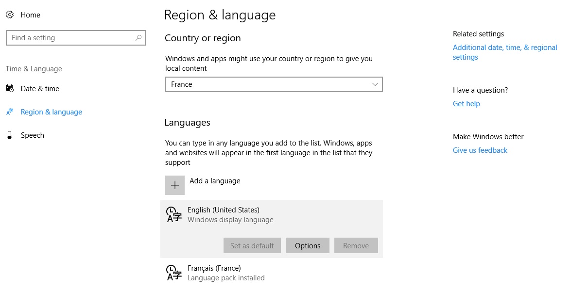

    I ask because language settings can be an issue in some circumstances with some plugins, though @yobuddy is having a hard time pinning down why as he has not been able to dublicate the language bug and it seems to affect some but not others who have language settings other than English Local: https://www.xsimulator.net/community/faq/simtools-language-setting-bug-change-to-english-local.233/

    HEY MR.NOOR, EXCUSE ME, WHAT DO YOU THINK THAT CAN BE HAPPEN IF I CHANGE THE LANGUAGE DIRECTLY IN THE SECCTION OF REGION AND LANGUAGE OF LOCAL SETTINGS, LIKE SHOW THE PICS: https://www.xsimulator.net/community/attachments/locale-png.13956/
    THANKS.

    Codemaster games need to have a race done before the patching.
    I would remove the patch from the game.
    Then launch the game and play a race, let is save your progress, and then exit the game.
    Now re-patch he game and try again with SimTools.
    Let us know what happens,
  13. yobuddy
    5,374
    50,290Coins
    +5,148 / 18 / -0

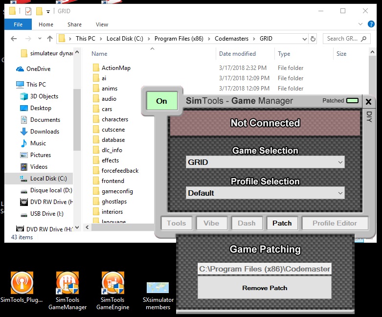

    Also please look in your MyDocuments or Documents folder.
    There should be a Games or MyGames folder with a Grid folder inside of it?
    If there is and your on a 64bit OS, patch it there instead of the install path.
  14. Oms
    Oms known as "Doc6dof"
    May 30, 2017
    93
    France Colomiers
    - 173Coins
    +37 / 0 / -0
    DC motor, AC motor, Arduino, Motion platform
    yobuddy[/QUOTE]
    Hello yobuddy,
    I did not try to have a race done before the patching, but I find a grid in Documents folder then patch it, and...... '' YEAH ... GREAT SCOTT !!!! If my calculations are correct, when this baby hits 88 miles per hour... you're gonna see some serious shit. "
    Thanks Yobuddy
