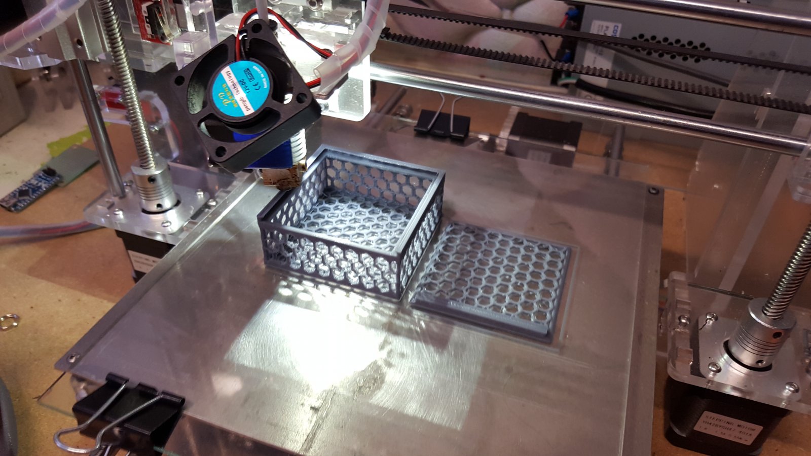

    20160213_120052.jpg Parametric objects amongst other things are models based on parameters. What does this mean to the end user? it basically means you can take an object and change aspects without redesigning the whole object. For instance you could adjust the size of a parametric object just by replacing some numbers in the code. Although there are many design programs out there I prefer openscad. It is also a free app. Openscad will export .stl files for you to run through your slicer of choice.
    this is a parametric file for an enclosure http://www.thingiverse.com/thing:539213/#files
    and this is where to get openscad http://www.openscad.org/
    there are a ton of parametric objects available to dload and print.

    same box as above
