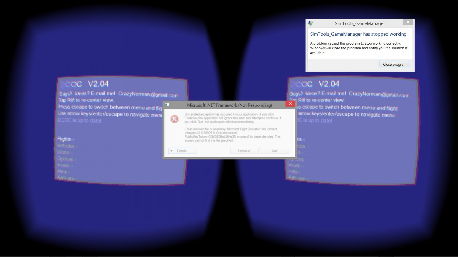

    I get the following .Net induced Simtool crash as soon as P3D is started. It happens even when running Simtools in admin mode and when I run P3D without DCOC for the Rift.
    Prepar3D is located on my E drive rather than C drive, not that it should really matter.
    Any ideas or solutions much appreciated.

    I would appreciate any ideas on how I troubleshoot the P3D error I am experiencing, which continues after the latest SimTool update.
    For a start it would be helpful to know if anyone else sees the same crash with P3D 2.4, so if you have tried 2.4 let me know one way or the other.
    Many thanks in advance, as this is a must have title for me and I am happy to do whatever it takes to get P3D running.

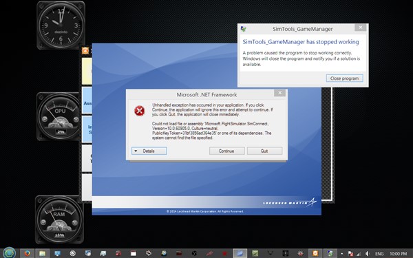

    Still no joy, with SimTools crashing as soon as P3D starts.
    I have done a clean install of SimTools and have downloaded the FSX/P3D plugin again and installed.
    The error message is that it can't find a specified file.
    Any ideas or help really appreciated as P3D is the one 'must have' for me.

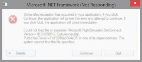

    These error messages
    sound like you're missing the SimConnect.dll
    If I remember correctly this file is copied to the simulation directory during install.
    I find this file in the folders:
    ..\Prepar3D v2\redist\Interface\FSX-RTM\retail\lib\managed
    ..\Prepar3D v2\redist\Interface\FSX-SP2-XPACK\retail\lib\managed
    ..\Prepar3D v2\redist\Interface\FSX-SP1\retail\lib\managed
    Try to copy the file LockheedMartin.Prepar3D.SimConnect.dll to
    ..\Prepar3D v2\SDK V2\Utilities\SimConnect SDK\lib\managed
    Hopefully this helps. Otherwise please check, if there is the possibility to install an SDK in the installation menu of Prepar3D.

    Thanks @value1 but that is not it, I have that file in both directories.
    I would have to download the SDK, and will do that after I get some web development work commitments out of the way tomorrow, as I have a lousy net connection. What do you have in mind for the SDK @value1?

    Much as I hated to do it, as I had a huge amount of tweaks, I have done a fresh install of P3D but that did not resolve anything. I tried installing on the C drive as well but still get the error. I am wondering if my X64 Win 8.1 could be the culprit, @SilentChill could you please advise what version of Windows you run?
    I downloaded the P3D SDK @value1, if you have any further ideas.
  19. SilentChill
    2,645
    20,585Coins
    +3,566 / 34 / -0
    Ahhh yes windows 8 shite lol I am running Win7 64bit Premium i would bet a lot of money that it has something do do with it. Can you run it in compatability mode see if that helps ?
