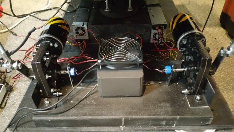

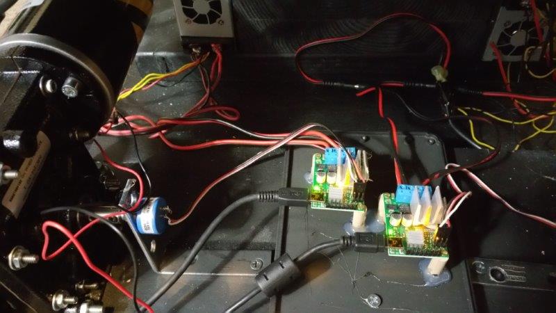

    I finally got my rig built up over the holiday and while I haven't used it for gaming yet, everything seems to work and it can throw me around quite nicely using the JRK configuration tool or SimTools. But here is my problem:
    During testing in the Simtools "Output testing", the wires from one of my JRKs to the motor gets quite hot. At one point, the motor starting clicking so I immediately powered down. The JRKs are cooled and I had no problems running the motors in the JRK configuration (for hours). But within just a few minutes in the SimTools output testing tab (with motors ON), I can feel the wires to the one motor warming up with only a couple of seconds of movement without a loaded platform . I have confirmed the wires do not get hot when using the JRK configuration tool even after the earlier issues today.
    Relevant parts:
    2 x 200w 12V motors from motion dynamics with 2 x 50:1 gearboxes
    2 x JRK 12v12
    2 x HP DPS-600PB B PSUs (575 watts/ea)
    Any ideas?

    could be a motor problem.....
    Maybe PID and motor settings, can you post them up please?
    Is the motor frequency 5 or 20 khz
    are the jrks going into any errors or shutting down?

    Lovely fan on top but don't see any holes on the side to let the air flow. ?
    But over all look like your working the motors way to hard with the platform on top.
    There is no difference with using the utility and Simtools cant explain why wires are warming, only way that can happen if the motors are under a too heavy load or a motor contains a short inside, maybe one of the terminals are not isolated , etc.

    Oh yes, good point Rob, you should loose the box or cut holes in it. Or even better, get for supports for the fan on each corner.

    I "think" I figured out the problem and curious if my theory has any merit. In short, I think the rig is so out of balance by itself that the motors are struggling to keep it steady when I'm not in it. The rig is roughly 45kg with most of the weight forward of the pivot. I came to this conclusion after playing a few rounds of NoLimits Rollercoaster and the wires were only warm.
    The reason it was not evident using the JRK tool is because the movement was much faster/deliberate. I actually made the problem worse in SimTools by lowering the power. The motor in question also has a loose pivot arm which swings away from the motor under load which exacerbates the problem. I just ordered a steel tube which will give a tight fit on the motor. With luck I'll be able to prove this theory right by the end of the week.
    It's not evident in the picture but the fan housing does have large cut outs on the sides and front. A picture is worth a thousand words unless you take it from the wrong angle ;)
