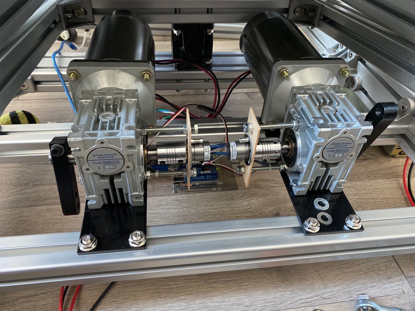

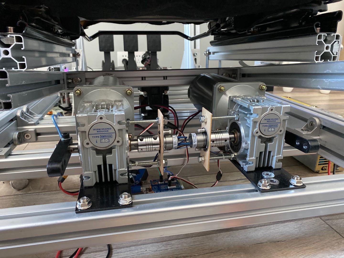

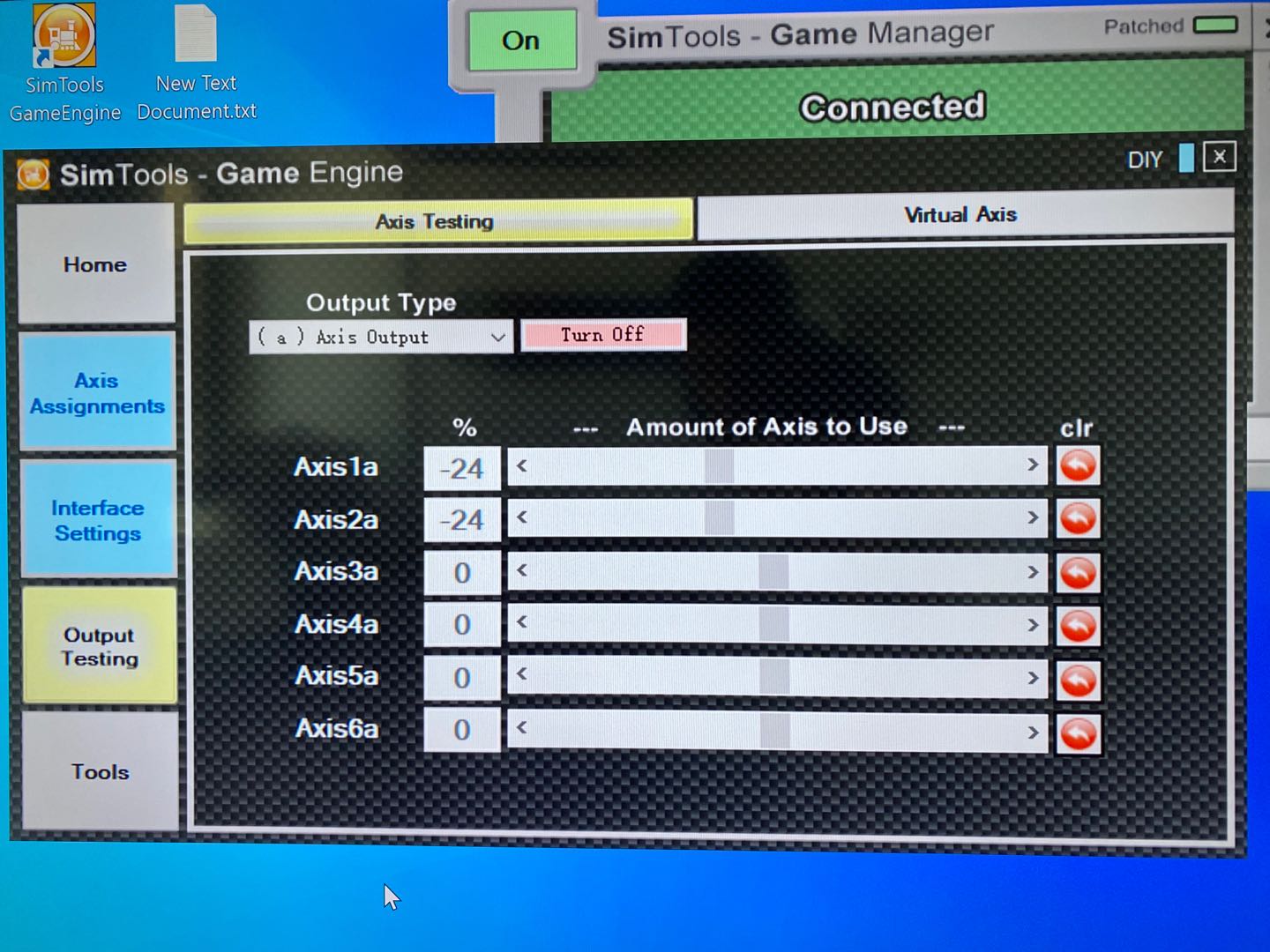

    I am setting simtools parameters, and encountered a troubled problem:(: The output angle is not linear.
    In the Output testing->Axis testing:
    The dead zone to the left is as high as 25%. For example, if it is adjusted to Lift 24% , the rocker arm keeps at 0°

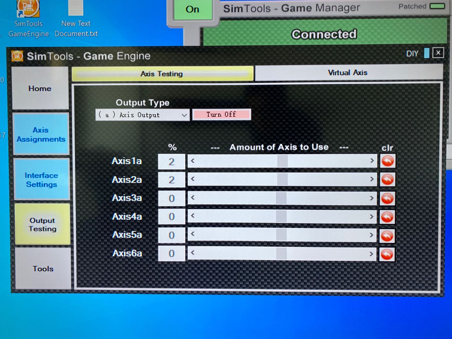

    The angle to the right is too large. For example, if it is adjusted to Right 2%, the rocker arm will output 80°

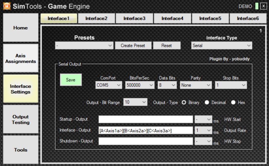

    interface settings:

    you need to tell simtools you are using rotational actuators not linear iirc
    is it the latest version of sim tools ?

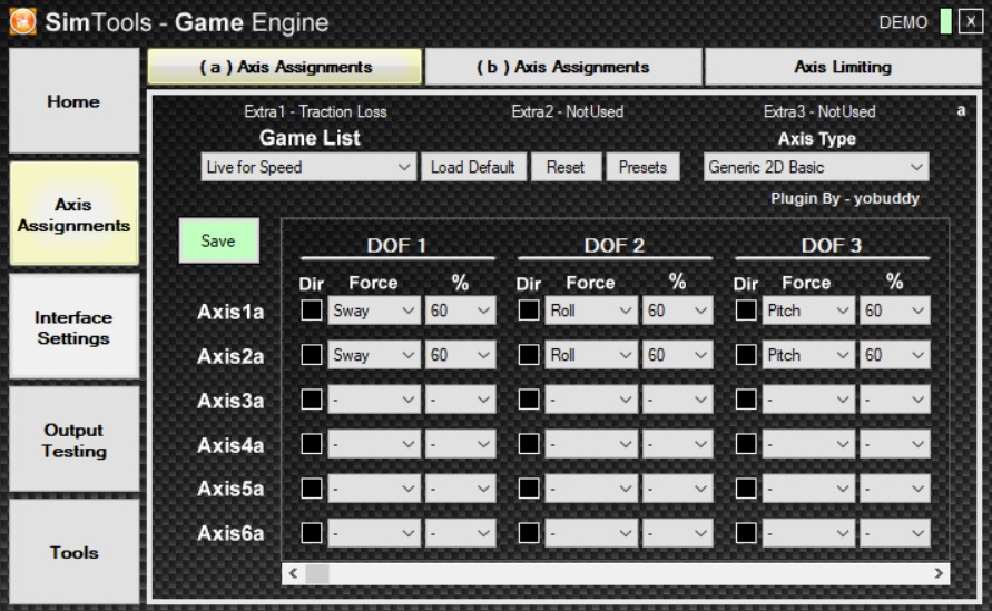

    @yangsqr,
    Take a look at the Generic 2D advanced plugin.
    There you can set them too rotational output and fix the problem your encountering.
    Take care,

    Thanks yobuddy, I found it in "Generic 2D advanced plugin". But the problem still exists.
    When I adjusted to “rotation” and tested it after pressing “SAVE”, the problem remained. The reason may be that the settings cannot be saved, because when I restarted the GameEngine, the settings returned to the “linear”. (I also tried to run the GameEngine in admin mode and still cannot save)

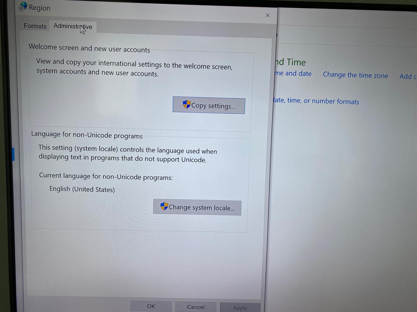

  8. yobuddy
    51,679Coins
    +5,204 / 19 / -0

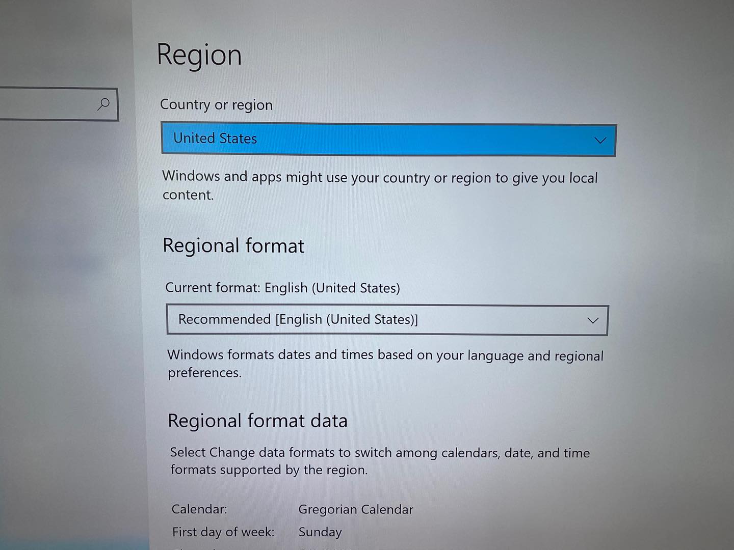

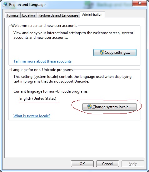

    Maybe its a non-English OS problem?
    Maybe try this..
  9. yangsqr
    yangsqr Member
    Feb 2, 2019
    43
    - 21Coins
    +8 / 0 / -0
    Thank you yobuddy, the problem is solved, it is actually a non-English system problem.
    In fact, I knew this problem before, and it has been changed in the win10 interface. Now it seems that this is useless.
    After I changed the language on the traditional control panel interface according to your prompt, it worked fine. Thanks again!
