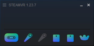

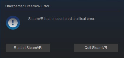

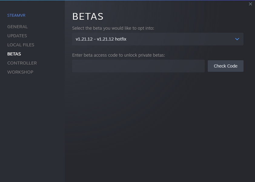

    Once again, a STEAM VR update broke OVRMC. (But luckily I found a way to solve... ) :thumbs

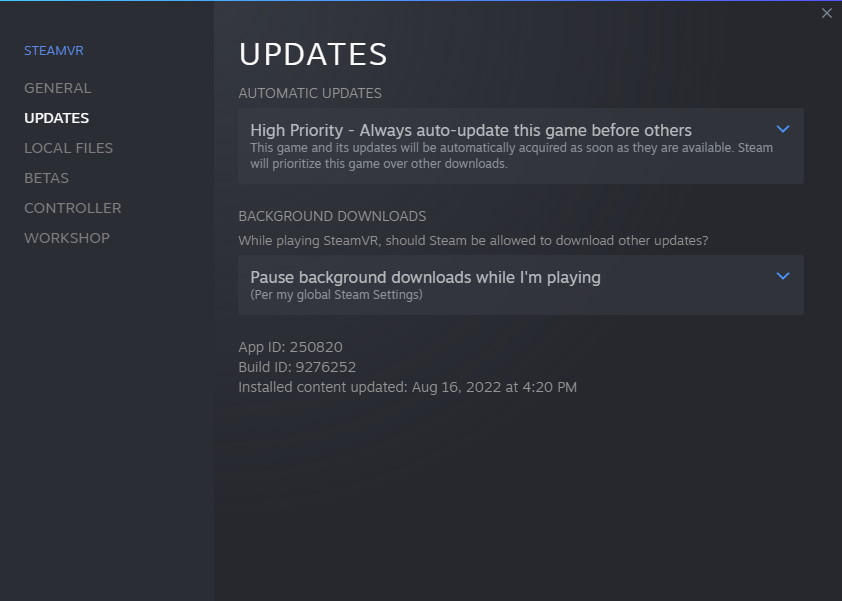

    After some days off, I got Build ID 9276252 and OVRMC did not load, same issue as some days ago.
    Enabling actual Beta made it even worse

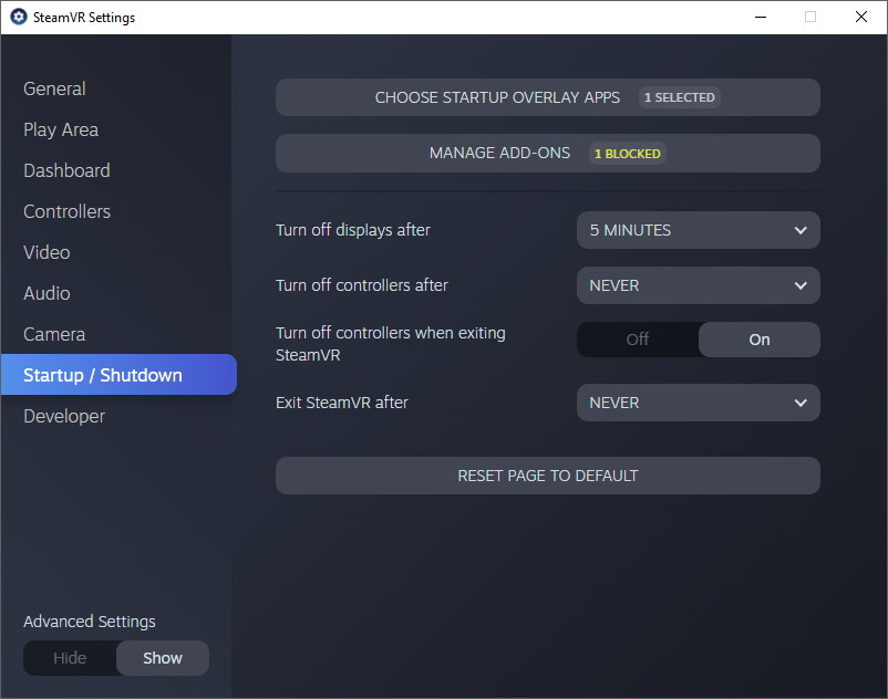

    After restarting, well known message "Add on blocked"

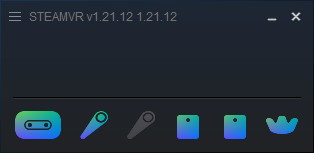

    After several worthless restarts, I decided to op into "old" V1.21.12 hotfix.
    This "Beta" solved the issue, OVRMC is starting again and works flawless.
    But I fear the next update, it's just a matter of time STEAM will again "f**k up" OVRMC. :(

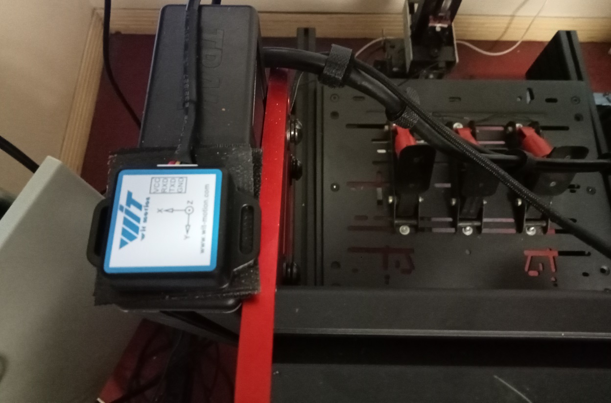

    Yep, fixed it. FI I am using the WIT 9 axis sensor (SRS). For me, find it way more reliable then the lighthouse solution, but it is limited to using SRS.

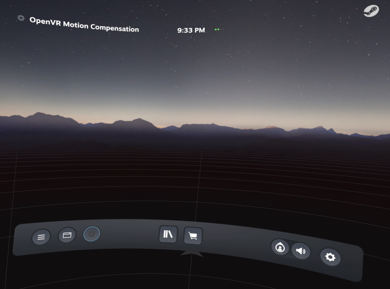

    So youre using OpenXR and OXRMC its just that the plugin for Mover is still called OVRMC it uses the same MMF .
    OVRMC only works with steamvr enabled to turn it on and off and calibrate it.

    Maybe it is just me :confused:, but cannot find a flypt source for a WIT sensor..
    That is using a virtual tracker, not a real tracker attached to the rig. Real tracker works way better for me.
