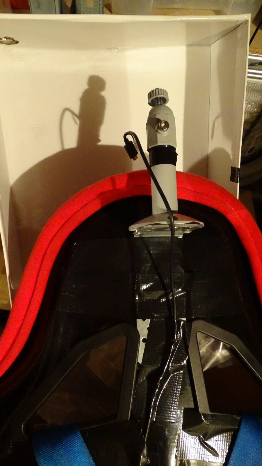

    Hi, it's not.
    Motion compensation works flawless if your HMD allows to.
    See:
    I've started with Oculus Rift CV1 and matzman666's openinput emulator https://github.com/matzman666/OpenVR-InputEmulator/releases
    It worked well until Facebook decided to cut the support of open VR.
    So I moved to a HTC Vive pro almost 2 years ago, and I can tell you it's brilliant.
    I assume it will work with Valve's HMD the same.
    No mater if you like flying, racing or simple driving.
    Positioning the Lighthouse sensors in an angle between 60° and 90° to each other makes compensation much better for my rig, it's a Fastetech Racingcube RC4 v3
    If the tracker (whatever you use) is not ar rigit mounted than my one, it's maybe better to try the other available motion compensation software OVRMC, available here too and discussed in the fasetech forum https://forum.fasetech.com/support/new-motion-compensation-ovrmc/
    I'm fine with matzman666's, so I stick to that one.
    My mount: camera mount at at metal bracket with double-side 3M tape glued to seat (duct tape just as backup)
    Check out my other videos where you can see motion compensation in action.

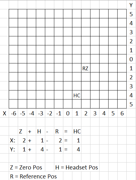

  14. Dschadu
    Dschadu Active Member
    Jan 2, 2017
    109
    1,938Coins
    +146 / 1 / -0
    The formula in the background handles this.
    compensatedPoseWorldPos = _ZeroPos + vrmath::quaternionRotateVector(_RefRot, _RefRotInv, poseWorldPos - _RefPos, true);
    If you cut down the rotation stuff, you end up with:
    compensatedPos = ZeroPos + poseWorld - RefPos
    ZeroPos: The tracker position in 3d space after you hit "apply" (this position is saved)
    poseWorld: Headset position in 3d space
    RefPos: Current tracker position
    An example:
    "HC" is Headset Compensated
    We have this initial position:

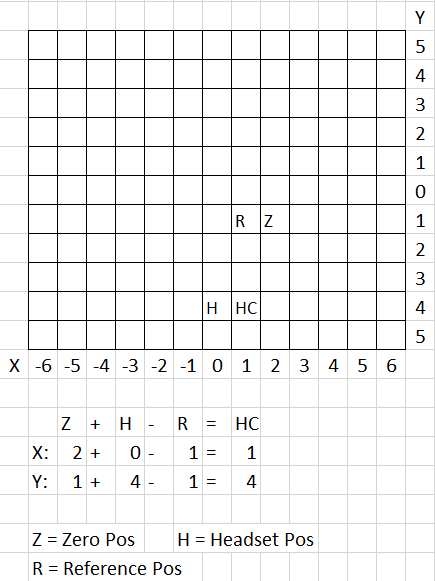

    Now our Rig moves 1 Unit to the left:
    As you can see, the [H]eadset moves with the [R]eference one to the left. But our Zero position does not move. The [HC] position stays where it was at the beginning.
