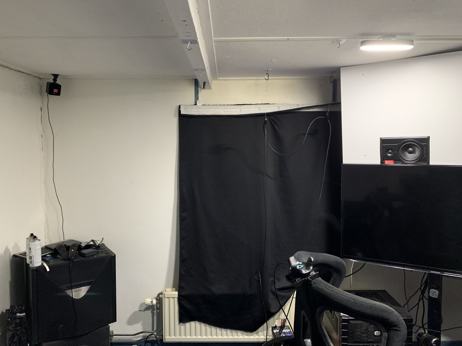

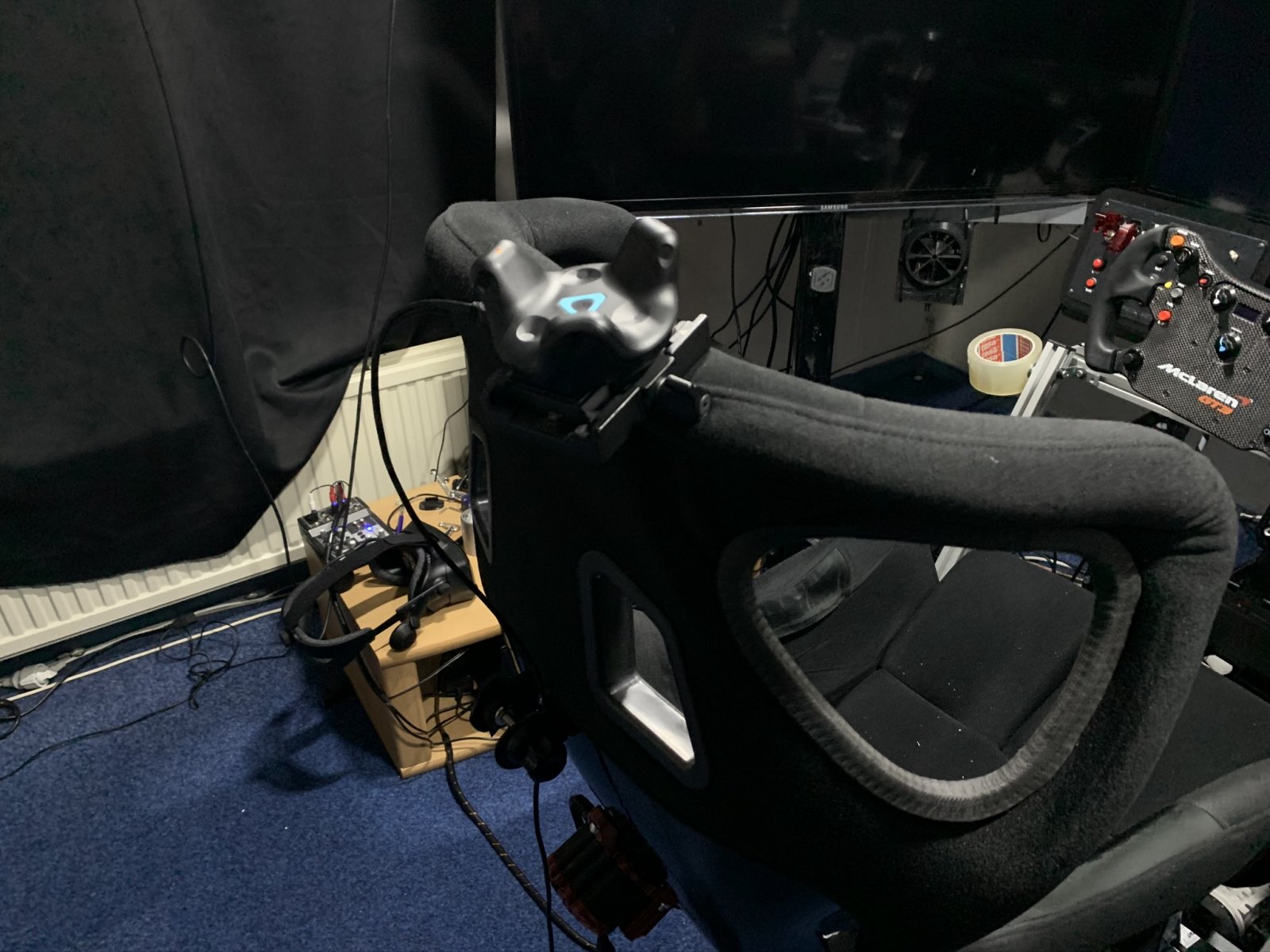

  11. splendiddd
    splendiddd Active Member
    Jun 13, 2009
    358
    CCTV security
    Netherlands
    813Coins
    +62 / 2 / -0
    Thank you so much, now i can fly with all shakers on in my P3 in full motion!
    I tested it first with a controller strapped to the chair, but now i have bought a dedicated tracker and this works even better. Tested it with basestations 1.0 with Vive hands Vive 2018 tracker, Valve Index and the Pimax 5k+
    It works great, verry happy with this :)

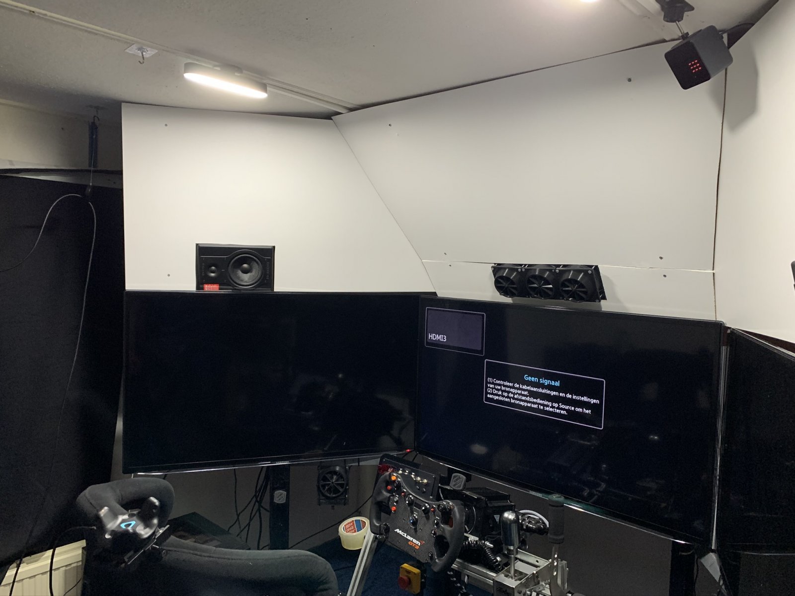

  12. splendiddd
    Jun 13, 2009
    358
    CCTV security
    Netherlands
    813Coins
    +62 / 2 / -0
    UPDATE:
    I sold my Pimax yesterday and tried to make the index work with it (i already did shortly and it did work)
    It seems hit and miss and it just stops working after a couple of minutes.
    Really strange that it work so great with the pimax but not very realiable with the index.
    I will try to move the lighthouses in different corners of the room, i also suspect my two side tv's are interfering with the lasers. I use a dedicated tracker for MC. Will post some pics today
  13. splendiddd
    Jun 13, 2009
    358
    CCTV security
    Netherlands
    813Coins
    +62 / 2 / -0
    Ok, after some more testing it does work for me now with Elite and X-Plane. For some reason it does not feel right with racing sims, but i am ok with that since the movements are not so big as with flying games.
    I relocated the base stations and tracker and i can run it with proper volume on the buttkicker :)
    Don't mind the mess

    Ya those screens look pretty shiny; might be worth throwing a cover over them while using VR. Nice setup though! Looks much easier to mount a tracker than a wand, which is what I've got. Haven't tried the latest version yet but previous definitely didn't like my shakers.
