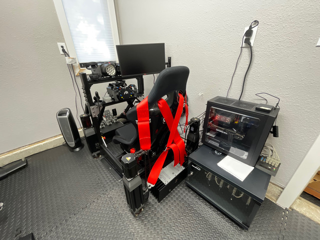

    Thank you so much for the quick response. Just two follow-up questions: Are you suggesting LPF filter set to 1.0000, or LPF set to .1000? I am guessing it's the former (1.0000), but I just want to make sure. Also, would a white wall count as contrast when my controller is black? If not, how would you suggest that I add contrast to my wall (see photo below)? Thanks again for your help!
    I hope you can pardon my ignorance, but how does USB come into play? I am using one of the standard HP Reverb G2 controllers as my tracker, which is mounted to my rig. Should I be using something else?
    I am not sure how I can improve my room setup further, but here is a photo for reference (the monitor swings so that screen is against wall when driving). Tracker is mounted to the left of the left fan/blower above my wheel. Thank you so much for your help!

    This is almost as worst as it gets.
    Imagine you are a camera and are told to look at a high contrast point. The only contrast you will find is the edge between your black rig and your white wall. And now this point moves, but your sense of balance tells you, you are moving into a different direction. Result: you get dizzy.
    That's what happens to your HMD. Put something at the wall in front of you and to your sides. Some pictures, a few colorful squares etc
