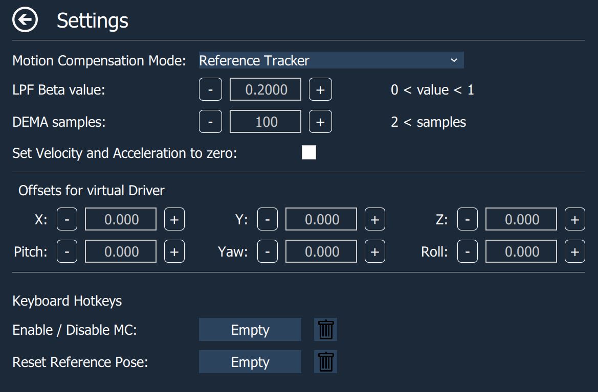

    Are you using the HP controller?
    Is it always in sight of your HMD? Is your HMD tracking 100%? No big monitors in front of you or a plain white wall?
    Try different filter settings. Try LPF 0.9 and DEMA 4

    There are 2 filters, LPF and DEMA. What do each of them do? And what does "set velocity and acceleration to zero" do?

    How do I change the DEMA value to 4? There's only the box to the left which contains 3 digit numbers

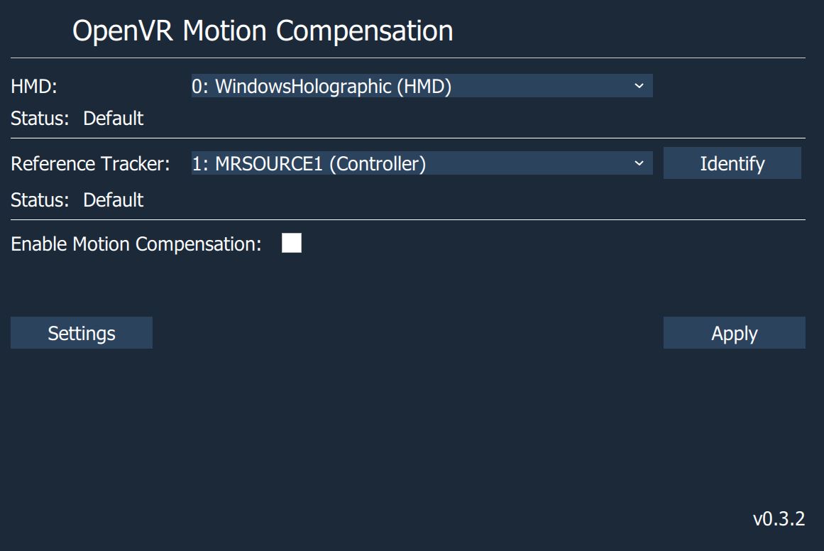

    Looking at this image of the settings, regarding DEMA samples - I can only change the "100" number in the box. The "2" on the right does not change. Is this correct?
    Also, downloaded latest version 0.3.4, but as you can see, only 0.3.2 installs, not the latest 0.3.4

    The text on the right is to describe the limits of the value.
    0.3.4 is installed, I just forgot to change the text in the UI.
    DEMA 100 is to high for WMR btw. Go with a significant lower value (2 to 20 maybe)
