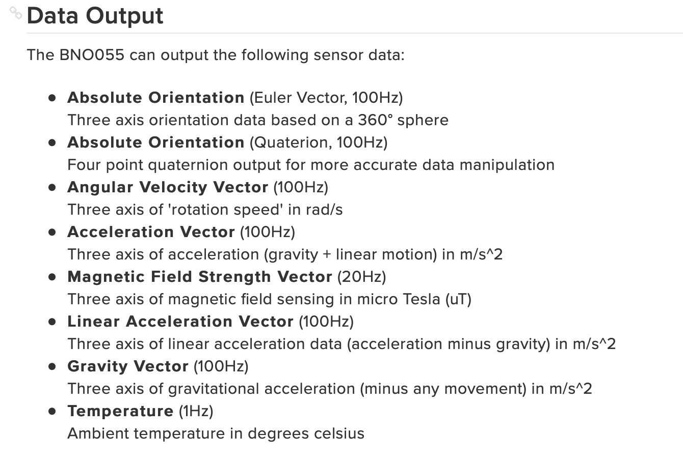

    IMUs like this one from Adafruit (together with BOSCH) have come a long way. Look at this:
    ...it has integrated sensor fusion :) which is a huge deal for DIYers like ourselves. But indeed, it does NOT provide accurate position natively. Only Orientation and accelerations. If someone wants to turn that data into position information through integration (which is possible), I'd suggest you learn how to juggle Kalman filters and I predict it is gonna be a long and stony path.

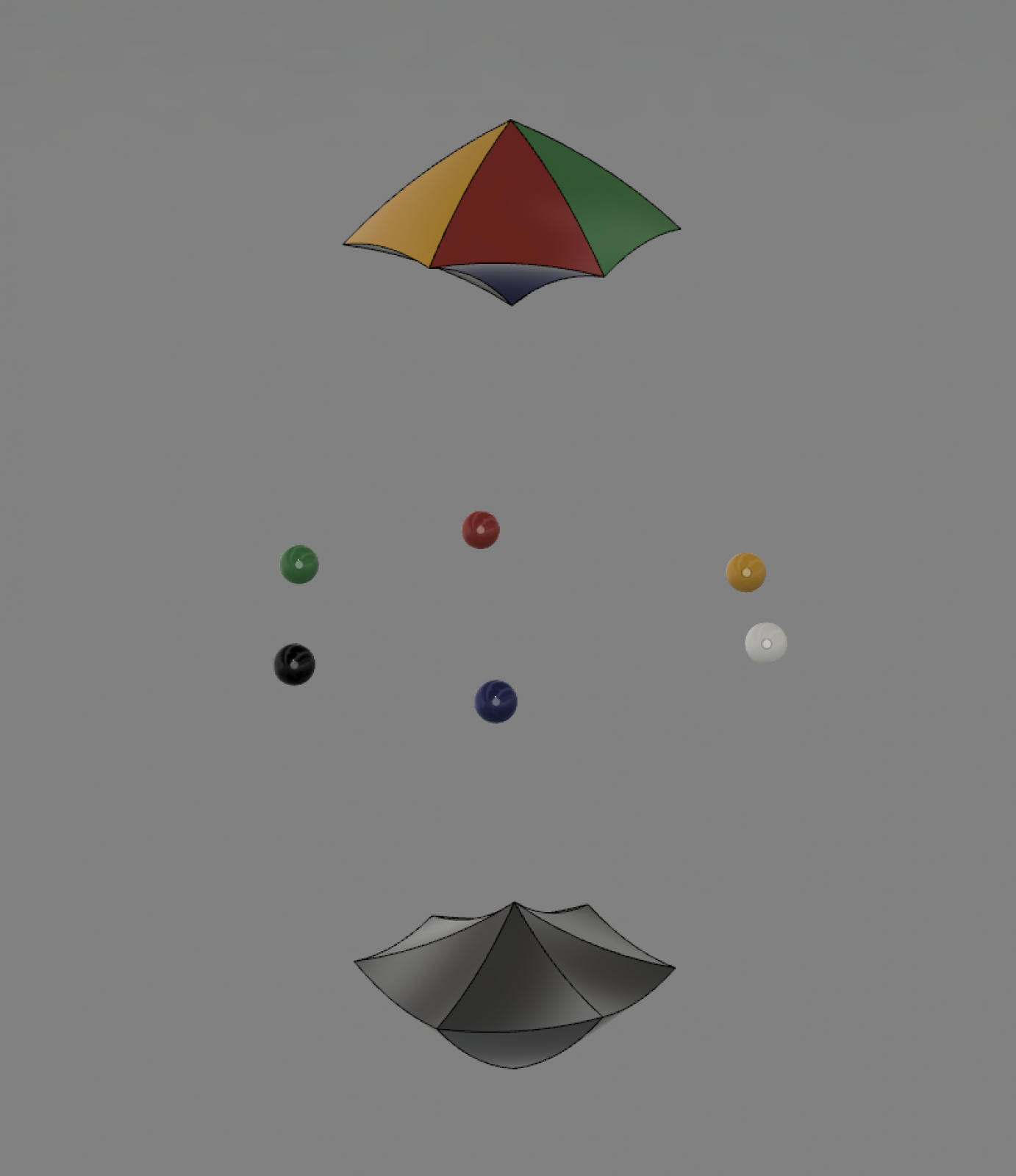

    Does the Arduino REALLY know the orientation and position? Afaik, it only knows the pots and thereby the length of every leg.
    If you want to derive the actual platform pose (position & orientation) from those, you will have to apply forward kinematics. Now, the thing with fwd kinematics is that you will get more than one solution. I think I read somewhere that there can be up to 24 possible solutions to the equations of motion.
    Meaning: There is more than one pose that fulfils the condition of the legs being a certain length. Not impossible, but computationally challenging.
    Probably the most obvious example:
    The Arduino does not even know if the platform is above or below the ground. Totally obvious for humans, but computationally you will have to find a way to resolve this ambiguity. There are also 6 ways to orient the platform 90°off in the vertical :) Not impossible, just a long and stony path.
    There is another (similarly stony) path to the actual pose: The motion cueing software knows at least the commanded pose. If we could model the system behaviour of the platform with sufficient precision, we could approximate the actual pose. Maybe that is what these guys from HeadWay call "advanced mathematic formulas"?
    This would require a substantial amount of expertise with mechanical systems and their modelling. Have I mentioned the term "long and stony path" in this post already? Again, not impossible, but a lot of work. Most of all, a lot of work that has to be done for every individual sim.
