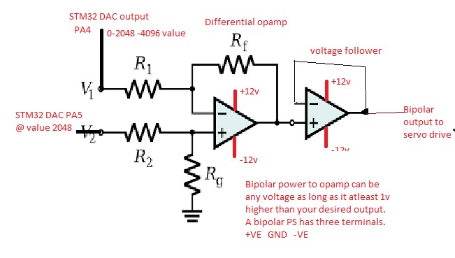

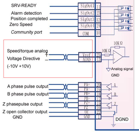

    that is nothing like the circuit I gave you and all you can get is ov - 4.5v
    You can't get -ve voltage out of thin air.
    What are you scared of? if you think you don't have a bipolar power supply available go look at your desktop pc, it has 3v3 5v 12v -5v -12v & 0v(gnd). plenty of junked pcs that you can pull the power supply from.
    You cannot also just put the output to the servo drive, as I said put the output to a voltage follower then to servo drives Ain
    220px-Op-Amp_Unity-Gain_Buffer.svg.png voltage follower, voltage buffer, unity gain amp or 1x amplifier all the same thing.
    You don't need an instrumentation opamp a standard opamp would be ok.
    Let me assure you. You will not get a bipolar output without using a bipolar power supply.

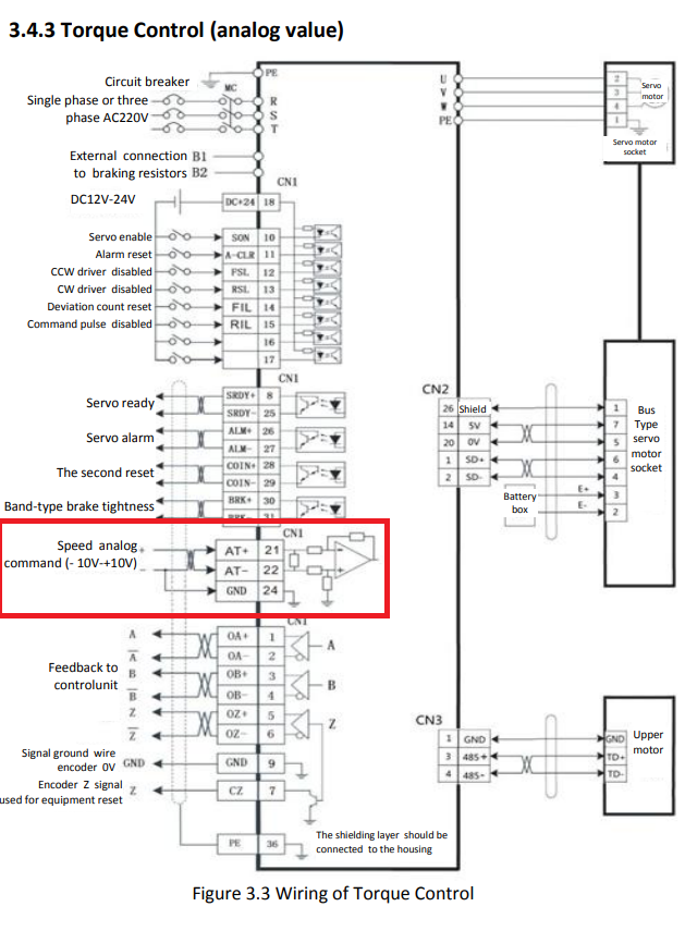

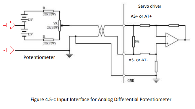

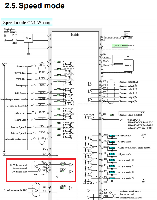

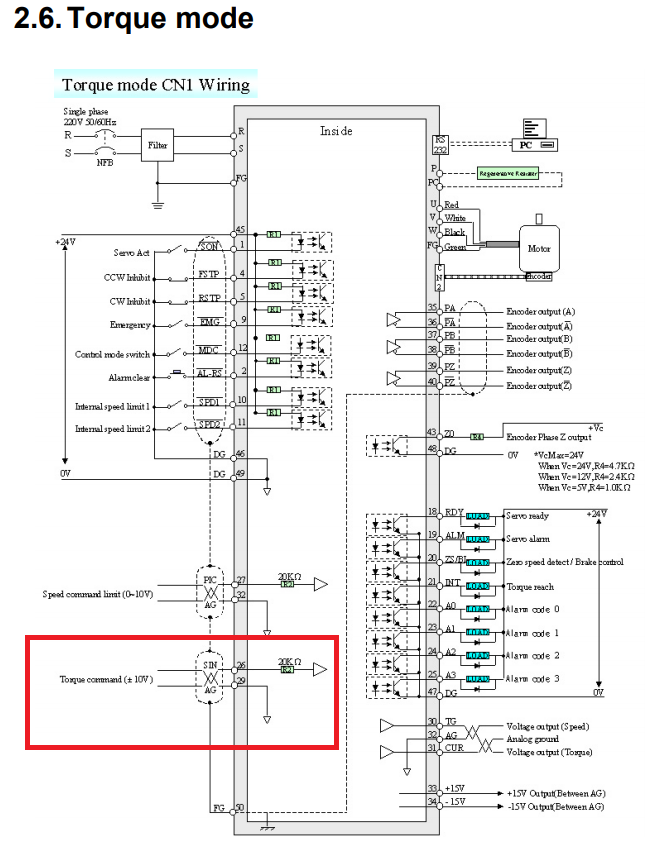

    Just looking at the control diagram that you posted earlier and it does show 3 wires for the analog torque control. First time I have seen Analog+- 10v interface like that all the ones I have used are like the above one which only uses 2 wires.
    Would you care to post the manual for your drive and was the teco servo drive the same?

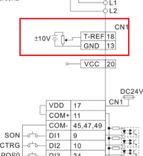

    well did you rtfm?
    A quick look shows this for torque mode
    I know that it shows in position & speed mode as three connections, why you need to have different torque limits for CW & CCW is a bit beyond me. Maybe you want higher torque to unjam a conveyer belt or when you want to unspool a winding machine????
    I always thought TECO was a better Taiwanese brand but their manual is a bit woeful.
    No wonder you have ground problems with the teco.

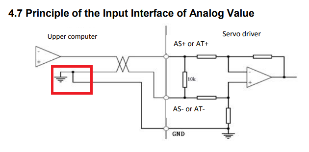

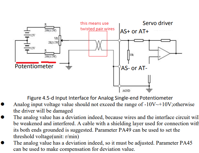

    With the Mige drive once again a bit woeful but it does spell it out for you.
    but it shows that AT- is tied to gnd making it a 2 wire connection.
    gr.png this seems to have been cropped on the left and missed the connection to gnd.
    this pic must of been done in windows paint as the text wipes out the gnd connection.
    None the less the analog torque connection is really 2 wires.

    I think I miss posted the formula.
    R1=R2=Rf=Rg = 2x amplification
    R1=R2 Rf=Rg= (R1*2) = 3x amplification
    R1=R2 Rf=Rg amplification = (Rf/R1) +1
    It is actually a bit more complicated than that but it does work out.
    So for R1=R2=100k and Rf=Rg=300k will result in 4x multiplication.
    You do need to make sure if you amplify the differential voltage that the bipolar power to the opamp has to be able to swing that high/low. ie if you have 4x and have +-5v to the opamp you will not get +-6v out it will top out at around 4.6v.

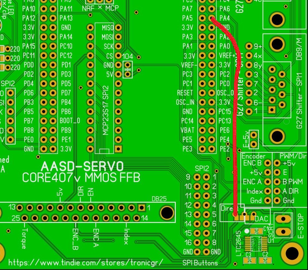

    If using Thanos board and you want to use the STM32's DAC remove the shorting selector and use a jumper cable as shown in pic.

    What advantage would you get? well, it would be 1 less conversion. Instead of outputting the signal in PWM in MMOS, then using the LTC2645 to convert to an analog voltage and then finally outputting to the servo drive.
    It is simply just faster and maybe more accurate to just use the stm32's built in DAC to output an analog val;ue to the servo drive.
    You may need to actually cut the track to pin 25 due to the way thanos routed the LTC2645 output, it is always connected even if you change the jumper in to "direct" or "DAC" as it only changes the input. It also means that without a signal to the LTC2645 it would output a 0v to the output pin, so if you try "direct" mode the LTC is trying to pull the MMOS PWM signal down to ground.
    If you want to try the STM32's DAC the easiest way would be to scrape off a section masking on the straight part of the track and then cut the track in the middle and then solder your jumper to the left side.
    You can restore the track if you want by bridging the cut track with solder if you want to go back to using MMOS PWM & the LTC DAC.

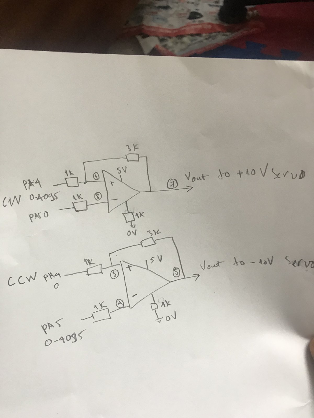

    Hi @OZHEAT,
    So pwm and Dac with pulse/dir and hbrigde now ok, (but still set offset on ac servo to remove 0.002v)
    As, as you said, when using dac with pulse dir mode, must connect dir to pe11. I will change to 2 options in future, user only choose one option:
    - use DAC: use PA4,5 (with pulse dir PA5 0-1)
    - use Pwm: pe9,11
    I will check 0..50..100, it dont have tool to test (i just ordered logic analyzer but it is clone saleae, i think so because it is obly $10 :d) and check DAC too.
    Currently i dont use Teco driver, I ordered mige driver with bissc encoder but now i haven’t received yet. Mige sent them last Friday. It takes me around one month to receive :(!
    With mige, i will try your solution with DAC 0–50–100 and PA5 as v-ref. I ordered some opam lt1013 and lm358 and bipolar +-12v too.
