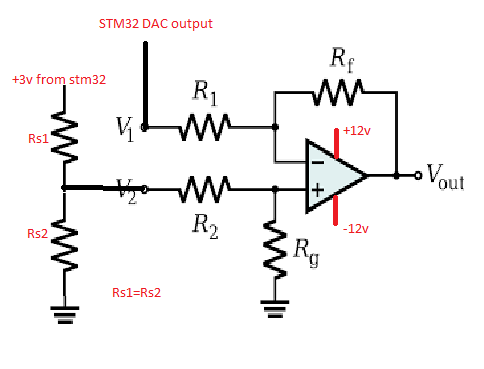

    I'm unsure about what you understand so I will explain as there is no references that I know of that I want you to do, only reference is my head.
    First off, 0-50-100% mode.
    I think you kinda understand what this means.
    I'm gonna to just explain in simple terms and assume a perfect output but in reality the dac in the stm32 isn't perfect being it can't go rail to rail.
    There is an offset but for this explanation just say 0%=0v 100%=3v 50%=1.5v if we just say we have minimum steps of 1%. ie. we are using 49 steps per direction
    @50% it is like you are commanding the servo drive to just sit there and do nothing.
    @0% commands full power CCW. @49% that is the smallest value in CCW.
    @100% commands full power CW @51% smallest in the CW direction.
    In my mind this is the simplest way to get a bipolar signal(+ve - gnd - -ve) to the servo drive from an single ended stm32 signal (+ve - gnd) is to use an opamp in differential configuration.
    download.png this is just a pic taken from google.
    As you want a bipolar signal to the servo drive you will require a bipolar power supply to the opamp be it +-3v +-5v +-10v (in reality most opamps aren't rail to rail so for +-10 the supply will need to be ~ +-11 or 12v).
    In simplest terms your stm32 dac output would go to V1 and V2 could be derived by using a equal voltage divider on the 3v power from the stm32 giving 1.5v on v2.
    This would work but you could get a better reference voltage in V2 if you simply use the second stm32 dac channel to output value 2048 which should be exactly half. fff.png
    Resistor Rf determines voltage multiplier so if R1=R2=Rg=Rf the Vout would be double giving +-3v.
    Or if Rf=R1*2 Vout=+-6v Rf=R1*3 Vout=+-9v.
    I would use another opamp in voltage follower config on Vout then to the servo drive so you don't load the first opamp(differential).
    Long post but I hope you get the idea.
    I haven't been using your firmware to test the circuit as your 0-50-100 is split in to 2 dac pins and the 0-50-100 using PE9 pwm has some maths errors in it and only outputs 0v - 0.275v - 0.55v(using low pass filter).
    I have been using mmos & wheelcheck to test using the voltage divider but wheelcheck only has limited output modes.
    LOL I have actually spent 10x more time trying to write code to test the second circuit config but it does work albeit only as a voltage sweep and a few leds for range indicators, working on using a pot on an analog pin to vary dac output but that might take a while. Hopefully you will get the 0-50-100 mode working so I don't need to try programming.

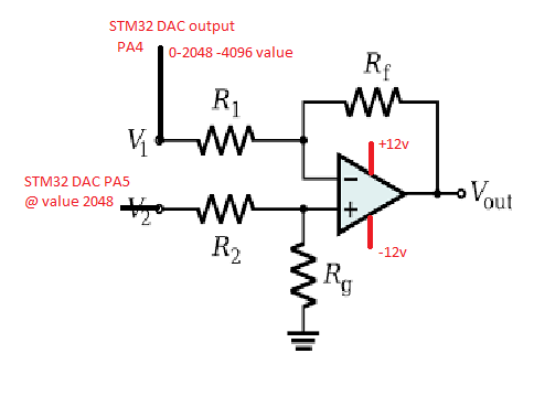

    Ah ha. Your idea is same as like me.
    In my idea:
    I connect pa4 to vin+ , gnd to vin-, out put is 0-> +3(assume all resistor is same value)
    And pa5 to vin-, gnd to vin+ -> out is -3v -> 0v.
    But as you said, can not get 0 or 3.3 v. So need a reference votage instead of 0v -> use dac output as v-ref.
    So, i will do like that:
    - set dac output is 0..50..100 like pwm (0..49 cw, 51..100 ccw, 50 no rotation) on pa4
    - make V-ref: set pa5 with dac value 2048
    - connect like that
    + pa4 to vin+ opam
    + pa5 to vin- opam
    Now output is -3.3 to 3.3 (rf = 2r1)
    - connect output to both +- 10 voltage in
    Is it correct?
    If it correct but i dont know is it good when connecting -3.3 to +10v in or 3.3v to -10v.
    Maybe i still separate to 2 opam. Using Dac 0v instead of ground as V-ref
