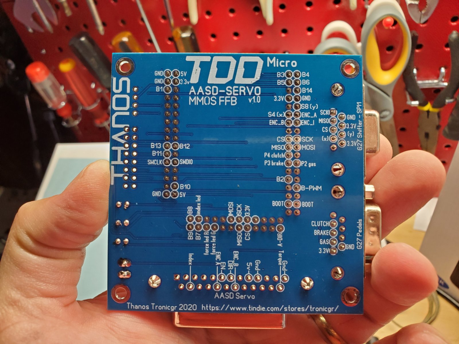

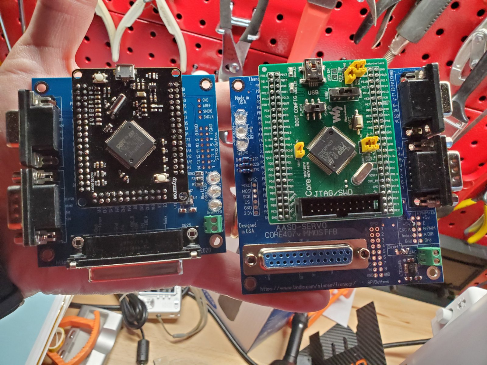

    Which microcontroller and motor?
    Could I use it on STM32F4 with Servomotor instead of MMOS firmware?
    https://github.com/tronicgr/TDD

    Yes. It connect same like mmos without changing connection.
    It supports pulse/dir and hbrigde.

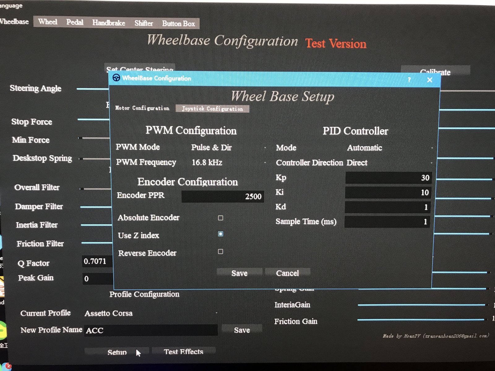

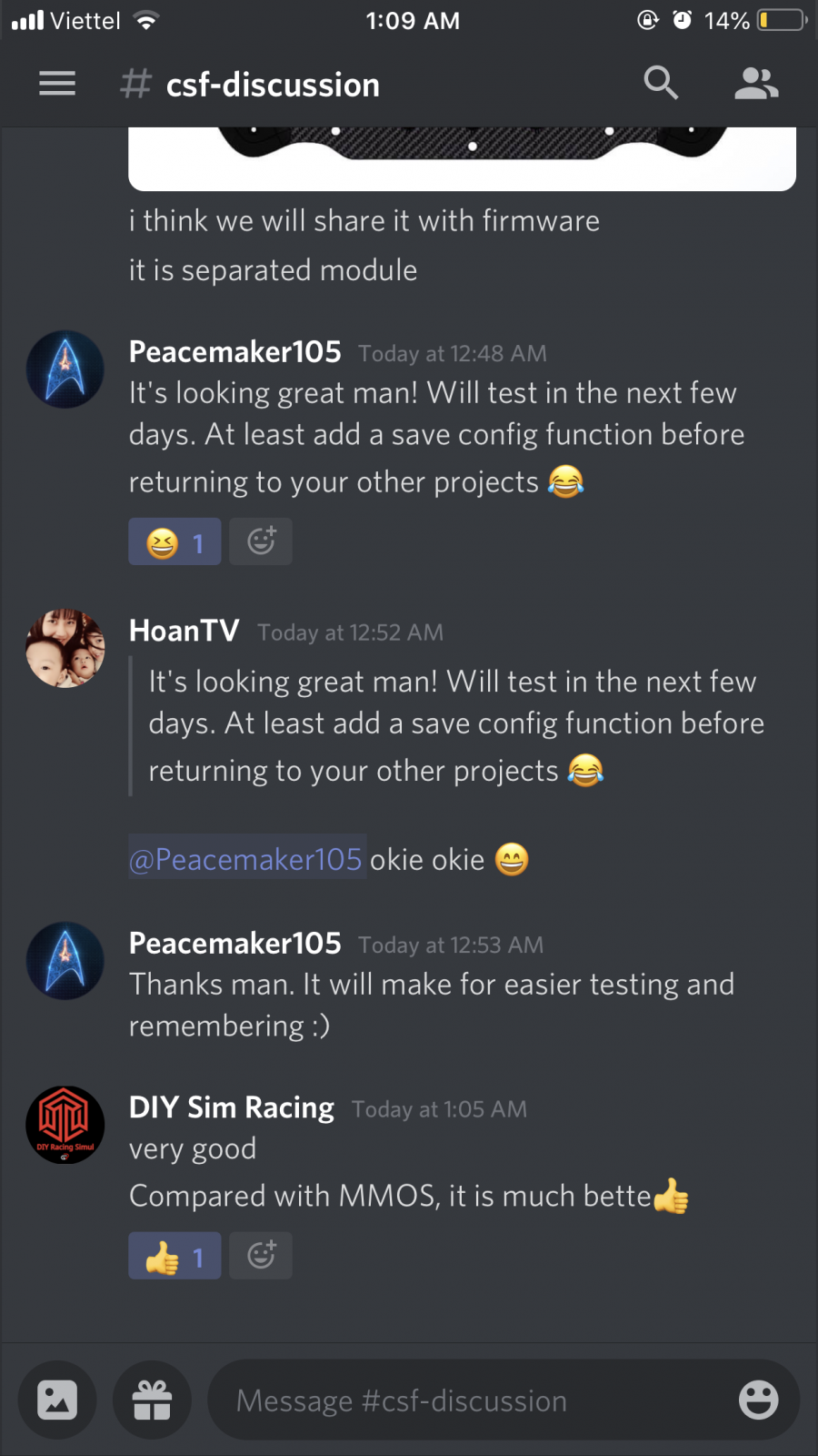

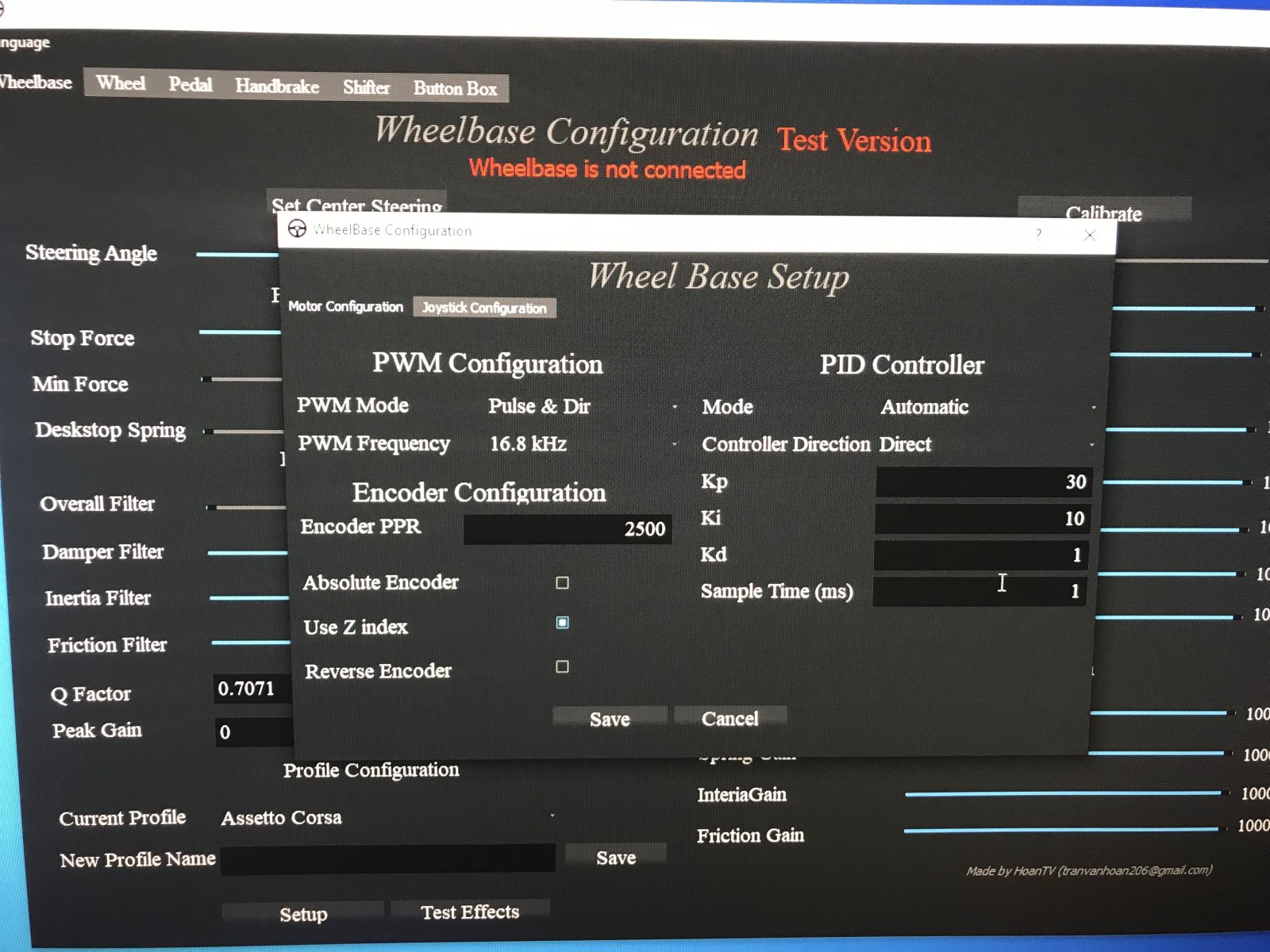

    Here is some 1st reviews about open firmware of vnm simulation.
    If you are interested in this firmware, join my discord server to get firmware for testing.
    https://discord.gg/amFRzH

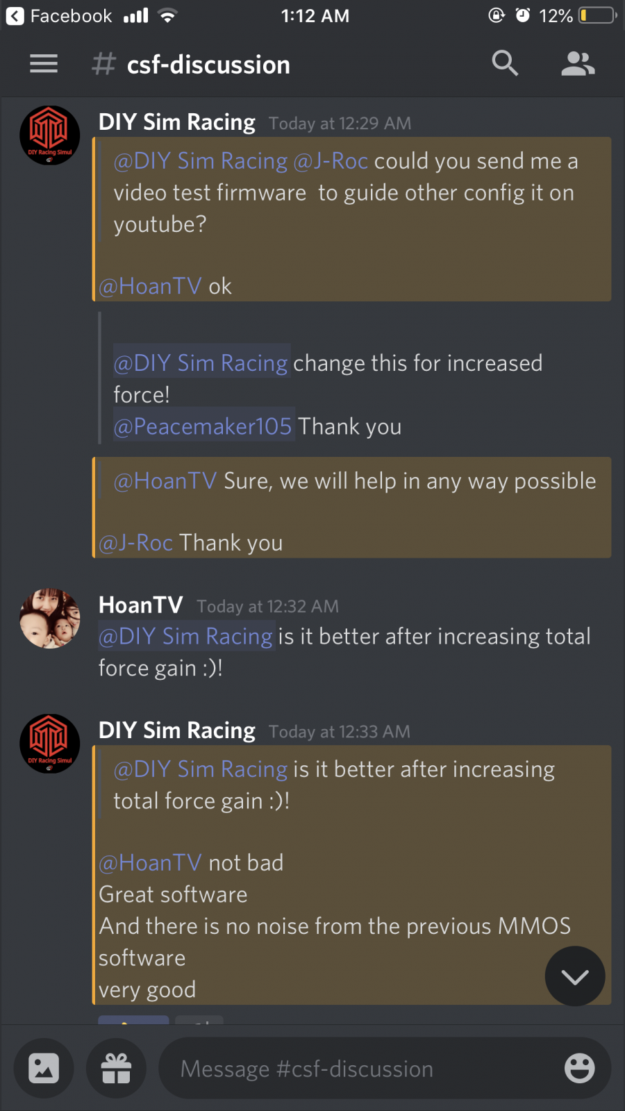

    Update: firmware supported force feedback from telemetry, tested with Assetto Corsa :d!

    @OZHEAT My firmware uses both: pwm and Built-in DAC. People can use which they prefer.
    Currently i made it like that:
    - hbrigde: turn left pa4 >0, pa5 = 0; turn right pa4=0, pa5>0
    - pulse/dir: pa4>0, turn left pa5=0, turn right pa5=3.3V.
    Here is my discord to discuss in realtime :)!
    https://discord.gg/NDk4pYd

    But what if you add a 12bit PWM to Analog DAC on the output?
  13. Thanos
    Jul 6, 2017
    1,380
    Electronics Engineer
    United States
    2,925Coins
    +1,079 / 10 / -0
    Why not use only one pin for Internal DAC say PA4, with output 0-3.3v and use the 0/1 digital PE11 pin for direction? Just Bidirectional signal for Torque. Don't use two DAC outputs...!!

    AASD servos just need an analog voltage 0-3.3v signal for torque and a direction signal digital 0v or 5v (to know which direction will apply the torque)
    Can't get it more simple than this!!

    The AASD servos use negative offset so that 1% you mention scales nicely down to 0 torque...
    Here are the parameters I used for TDD with the DAC function:
    PN002 = 0 (control mode - voltage mode, requires restart)
    PN003 = 0 ( Servo enabled? - external)
    PN018 = 0 (Take the encoder output pulse AB phase logic - 0-1)
    PN051 = 1500 (Motor max RPM - see motor specs)
    PN053 = 18 (SigIn 2 port functional allocation -27 - 27)
    PN188 = 10 (Analog torque instruction smooth filtering time - 1-500ms)
    PN189 = 100 (Analog torque instruction gain 1-300 %/V)
    PN190 = -100 (Analog torque instruction offset adjustment -1.5v - 1.5v)
    PN191 = 0 (Simulation of torque command direction - try 0 first)
    PN198 = 500 (Torque control speed limit - 0-4500rpm)

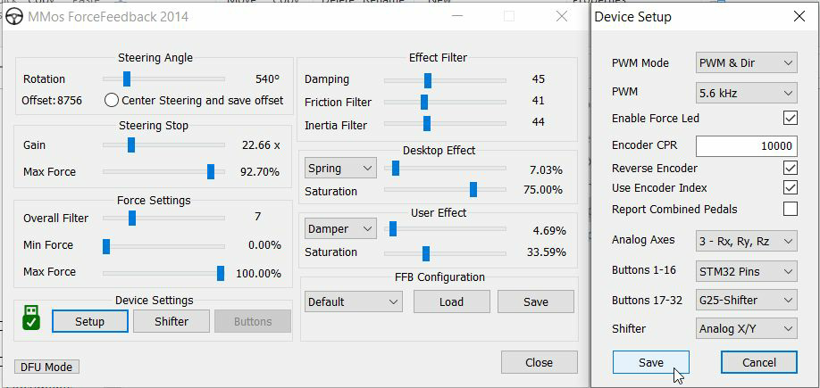

    And MMOS settings:

    No optocouplers, its direct Analog voltage 0-3.3v. The DAC is rail to rail and the frequency PWM it decodes from MMOS is 5.6khz
