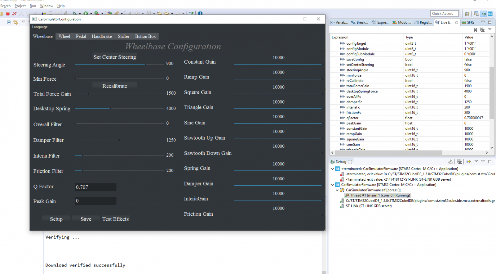

    I added desktop spring on GUI.
    Todo:
    - process configdata in stm32
    - store config data to flash
    - add desktop spring effect.
    - add filter for condition force
    - add BLDC support
    - test and fix bug
    - RELEASE :D!!!!

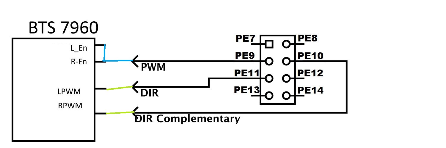

    Hoantv, hi. The right pwm dir connection to check the motor free rotations.
    The schematic is now right. Just swap the wires. It works.

    AC motor, Arduino
    It is strange :). Pwm connect to enable, dir (always 1,0) to pwm.
    I will test after finishing the configuration module.

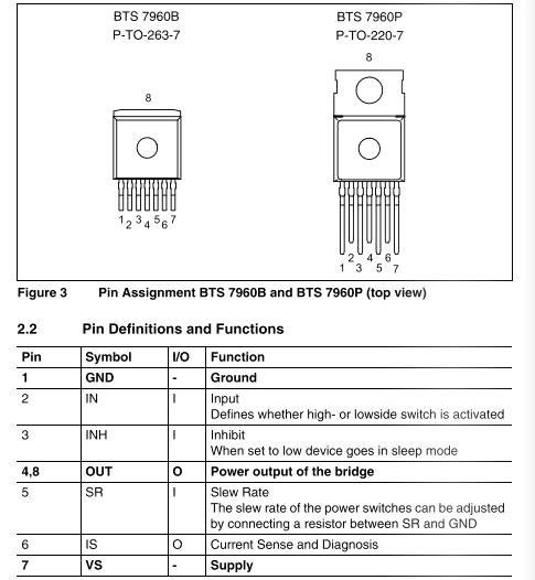

    Previously the lay out it was not proposed by me. But by another dude.
    If read the manual to BTS it won't be strange) L_EN R_EN is just a switch to each of the half bridges correspondingly. And only one controlling signal for each of the half bridges RPWM LPWM is required.
    So you have to pwm the switch. A commom thing actually, but in that case, it's usually just one mosfet stand alone, on negative or positive side to be pwm'ed ) So all then should come clear.
    But i bet a lil bit some extra work should be done. I don't like the way it works. The DZ is even more vs "standard". MB give an optos to the signals. Will see.

    Hmm, there is a problem with filters. I used this library:
    https://www.earlevel.com/main/2012/11/26/biquad-c-source-code/
    The sample frequency: is equal force feedback update (2500 sample per second)
    Fc: 1-> 1250.
    Q: default value is 0.707
    Used this to choose FC and Qfactor
    https://www.earlevel.com/main/2013/10/13/biquad-calculator-v2/
    If is no filter (Fc>0), ffb is still fine.
    If apply filtering, some time losing ffb around 0.5-> 1 second.
    Any idea for this?
    (The condition effect is not smooth. Need make it smoother)

    Problem is solved. Due to my bts is too hot :)) when i tested max torque!
