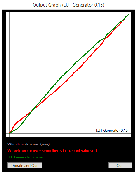

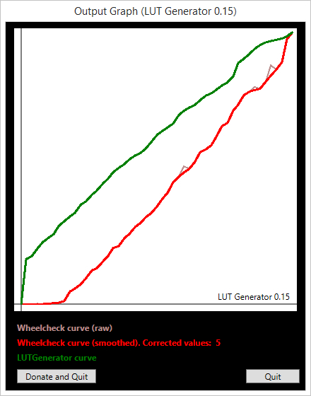

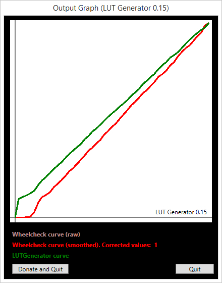

    Fundamentals. ) It's due to some hardware specs, driver topology and layout. And a motor. This is generally alright for motor controllers and motors to have it. But.
    This is diy relay and one mosfet with a right mosfet driver.
    12v 40% gain for a 24v motor. I bet it can be even lower. No min force.
    And 12v 40% BTS
    22v 40% BTS
    And you can add min force to it. Generally simply some extra % of gain. Or some more gain to get rid of the dz. For your motor.
    And, i made the classical h bridge driver, and that also has all the same picture as a bts in that terms. But it can be and should be redone in some other way. And it can be changed there, to have a quick response on minor pwm amount. ) h-bridge can be pwmed on both sides, and can be set to dir ( just open up) one mosfet and pwm another. That are a preferable way. But, as long as the BTS is kinda already is controlled in this manner, too, as it seems to be, so you have to cope with it, and don't have to look up for a code to solve it )
    Also, i don't know will it help with a bts, but mosfet drivers DO need to supply right amount of current at least some amps to open close it's mosfets as it should be. And now think of the controller amount of power supply that goes to the bts mosfets drivers.... ) All can be in it too)
    It's like, controlling with pwm, even the logic gate mosfets with an opto too, pulling on a gate the required voltage,

    I saw you made another driver. Is it better than bts 7960 kit?
    I found more kit that are monster sparkfun and 7971.
    Monster is expensive. 7971 is cheaper, around $20.
    It doesn’t need heat sinks, already has optocouplers.
    About min torque. I think must shift value for torque not min. For example,
    Before: 0, 50, 100
    Shifter 0+ 100, 50+ 100, 100+100.
    But still have problem it is hard to move (like friction and damper)

    What is your psu ratings?
    Frankly yes, that one with relay is better. Believe or not, but you can see the linearity tests. And really pumps more to motor. There are no lags as it might seems to be due to the mechanical relay. Only drawback is a sound. So you'd better think of the sound proof enclosing)) The classical with a pure mosfet topology, have to be redone some other way. It also has dz. I'll try another topology, then weather try another IR mosfets drivers, or add the one from the relay after the IR gate drivers. ))) And i'll be a monster too)

    After doing some test with bts7960. I found that, when r_en and l_en is high at the sametime, motor is difficult to move although pwm = 0.
    I tried to set r_en = 1, l_en=0 or vice versa and set both r_pwm and l_pwm but moto didn’t move. May be have a problem here.

    Do you make two dir and then one pwm for lpwm rpwm then? It should work. By means of one pwm+2 dirs. I"ll repeat that i don't have such an issues with braking motor with 5volts on both ren len.

    About bts, i tested another schemtic:
    - turn right Pin 9, len = 1; pin 11 ren=0
    - turn left Pin 11, ren = 1; pin 9 len = 0
    but the problem is the motor didn’t move I active ren or len. The motor only run if i activated both ren and len.
    I’ve tested like your picture, the result is the same, motor didnot move because active only ren or len.
