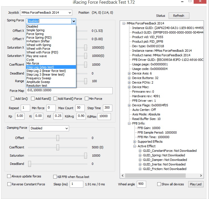

    I am trying to test all effects one by one. Currently i use wheelcheck to test.
    But it only support spring, constant, damper, inertia, friction, sin effect.
    I used fedit (which support all effects) but can not test. It showed invalid argument.
    Replace DD wheel to smaller wheel for test (DD too strong :d)

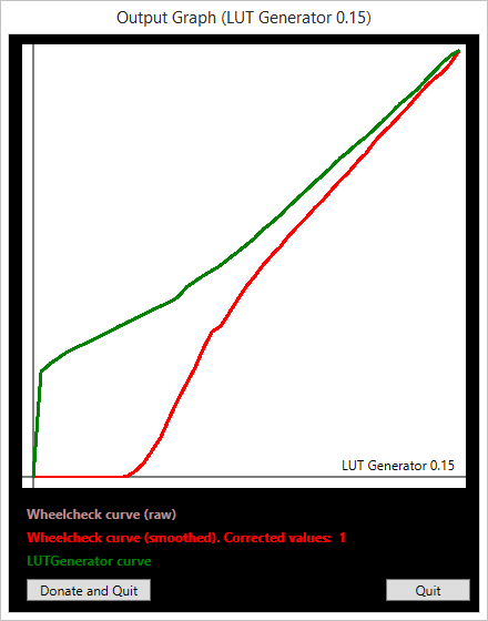

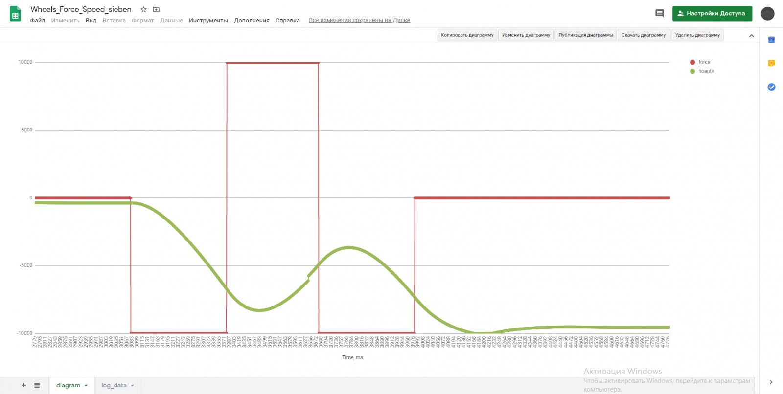

    What is your power supply and a motor? And where is your force slider at? Is it on the max?
    You've got pretty huge deadzone in linearity for now. Can be cured by several things. Including the software set up. Do you have a min force there?
    The step test.

    The deadzone i think due to the motor. When turn the power off, moving the wheel easily. When turn the power on, moving the wheel heavily (
    opposed to my DD)
    I tested with MMOS, have dead zone too.
    Here is logfile with MMOS min 4% and max 30%.
    www.mediafire.com/file/3lngz5knk746oky/log_mmos.rar/file
    I haven't made GUI to config. I used hard code for testing :D.
    total_torque = total_torque* 40% (no min max torque)
    could you share me 2 tools to read logfile.

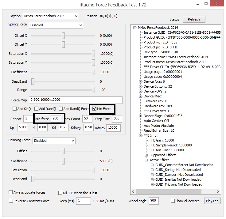

    You should give more then just 4% up till the 15% of min force for the motor with MMOS to find it's instant reaction.
    Also can make for the test the min force with wheelcheck. 900 is 9% etc. Can determine it with min force test. Or just look when the wheels will start to move from the very start of the step test 2.
    The linearity chart is made with LutGenerator.
    https://drive.google.com/open?id=1dKnekJc5EpudFWpAIKzxTu-f_7nWZBPe
    On the graphs check this.
