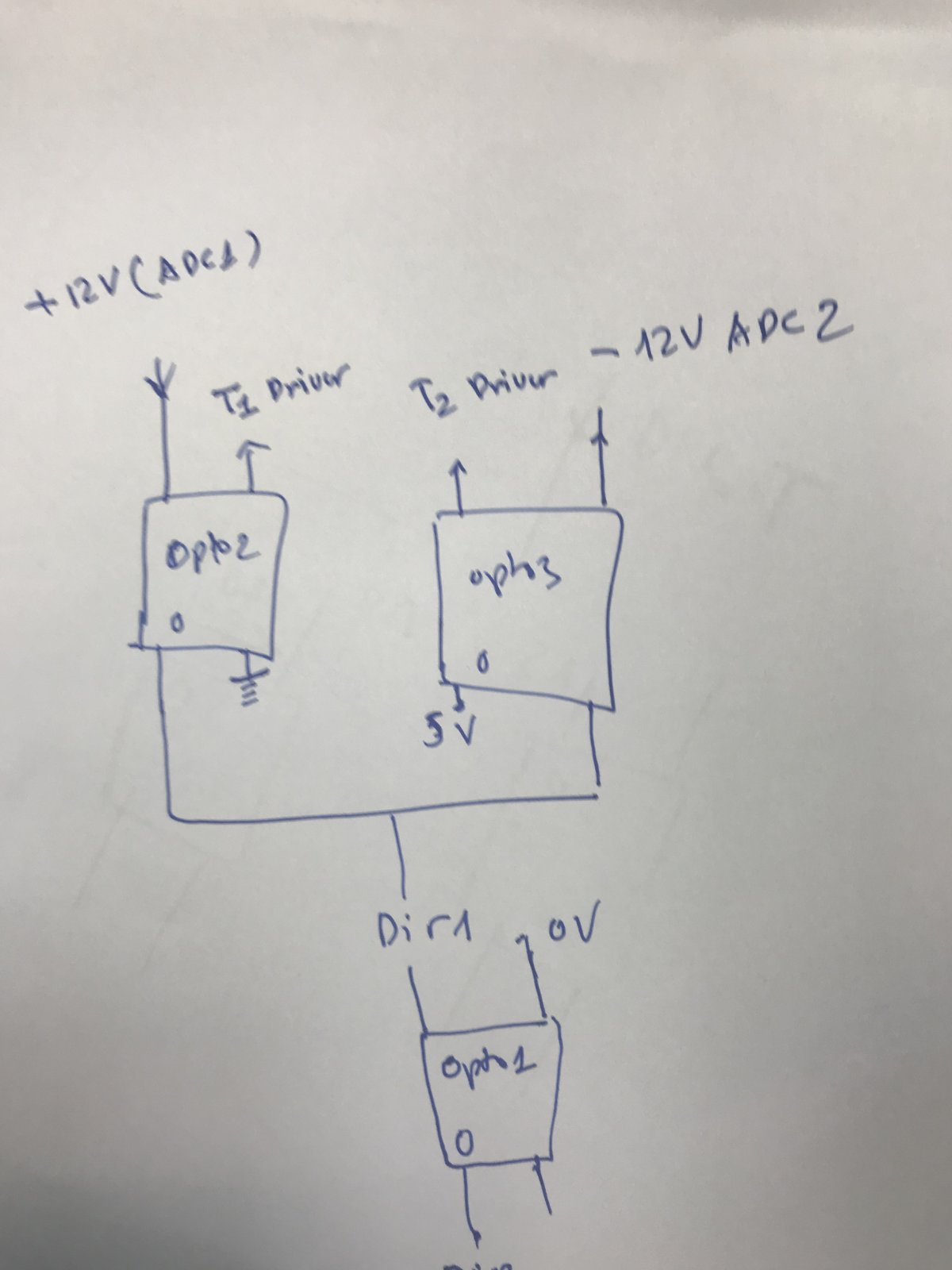

    AC motor, Arduino
    hello ,
    I have just finish 1 phase DIY FFB MMOS used AC servo. It works well. I want to add some features (all 3 loadcell pedal, shifter, paddles, button plate,... in one MCU) Now i am trying to make a my firmware instead of MMOS (it is not supported now). 1st phase i do for Adruino, 2nd phase for SMT32F11. I think there are 5 tasks to make this firmware:

    It is Teco tsda30b. I heard Odriver but it is difficult to buy it in my country. I test 2 driver from teco, the former uses speed controll with torque limit. I already make it working. But both speed and torque have a disadvantage. If ffb is low, the Rim will run over center position and repeat one or two time before stoping at center position. I will try position control to see which is difference. And i already bought ADC convert to replace optocoupers. But i priority to make the firmware 1st.
    I think you can use any servo driver which is compicated with server ( if driver is not complicated, server sound out loud)
  5. Hoantv
    Hoantv Active Member
    Jul 19, 2019
    117
    981Coins
    +74 / 1 / -0
    AC motor, Arduino
    I used pwm +-10v.
    Now, I consider to use pulse dir. and i think i will use a 2 relay to control the torque.
    Postion control uses +-10V to manage torque limit.
    I use 2 adc 5v to 12v that make +- 12v.
    2 relay, 1 low triger and 1 high trigger. When dir = 0, +12 active and when dir = 1, -12v active.
    That is my solution. I dont know it work or not (bought but not test yet)

    You decided to make the dir control on relay? It will make oscillations. I tried and due to that should low the ffb amount. If i get that right)

    Yes, I want to control the voltages control external torque limit. The speed and direction are controlled by pulse/dir from MCU. The problem is how to make torque for it (if torque = 0, servo doesn’t run).
    The voltage for torque limit is + 10 or - 10 corresponding with the dir signal. Dir is 1 or 0 value.
    I must convert it to analog (0-+/12V > output of ADC for pulse signal). I have several solutions for it (in my mind):
    -s1: I will set 2 pin digital base on dir, pin 1 = 1/ pin 2= 0 when dir = 0, pin 1=0/pin2 =1 when dir =1. Pin 1,2 connect to pin 1 of 2 optocouper. Pin 4 of optocouper connect to output of ADC (in case make my on firmware or use one more MCU if i use MMOS firmware)
    -s2: I use 2 relay, input/output replay is output of ADC (+-12V). The trigger is defferent,, relay 1 is trigger by H, relay 2 trigger by L. Dir signal connect to trigger input.
    - s3: i use 3 optocoupers. 1 couper to make 0/5v on pin 4 (called dir1) which isolate with dir signal control servo direction as images
  14. Sieben

    I mean, with conventional pwm+dir with dc motor, an ordinary relay in dir, is supposed to be the couse of the oscillations if the ffb amount was high. All the same effect with IBT-2 (BTS7960) with ordinary pwm +/- mode, but with much higher ffb values there. Just like so.
