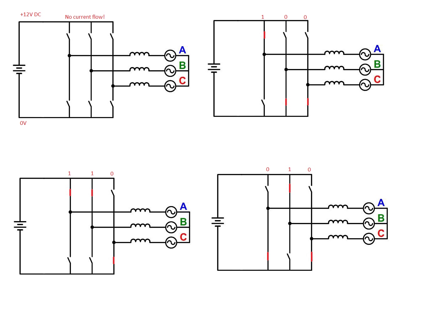

    Quite some time ago when I used to be far more active on this site I purchased an AC servo motor for under $100 and set off to get the thing working. Between scratching my head and not having enough time to scratch my arse I finally had an epiphany when reading up on 3 phase control fundamentals. I had been searching for information on how to control 3 phase motors and coming up more confused then when I had started off, mostly because all of the literature that was freely available was describing a motor that was in motion/accelerating/ramping up etc. But there was nothing on motionless torque control! The only method I had left was experimentation. This is where I got my control method idea.
    The first thing I tried was just applying DC to each coil and watching the response. I had noticed that by varying the combination of positive on one coil and negative on others would set the motor in specific rotor positions.

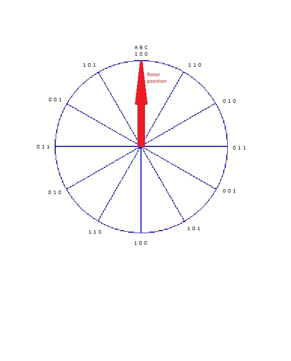

    After some googling on what I had seen I came across a rotor position truth table which I used to sequentially shift the rotor position in a 360 degree circle. By putting +12v on the phase assigned with "1'' and 0V on the phases assigned with "0" you can step through this sequence. What you can see in the picture is that the motor repeats the sequence after 180 degrees of rotation. What this means is that if you apply +VCC to phase A and oV to phases B and C the rotor will snap to the shown position, if you force the rotor by hand past 90 degrees the rotor will then snap in the exact opposite orientation. Each "sector" has a 30 degree separation.
    With knowledge I set about creating some arduino code to sequentially step through these transitions.
    After more head scratching I figured out how to utilise the horde of Monster motor drivers that I have acquired over the years. You cannot normally use the H-Bridge as you are stuck with only flipping one pair of coils. That will not be able to cycle through all of the required phase sectors. I have no idea how I came up with this but it damn well worked. Here is a simplistic breakdown on coil activation:

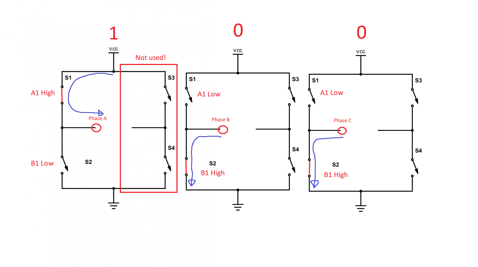

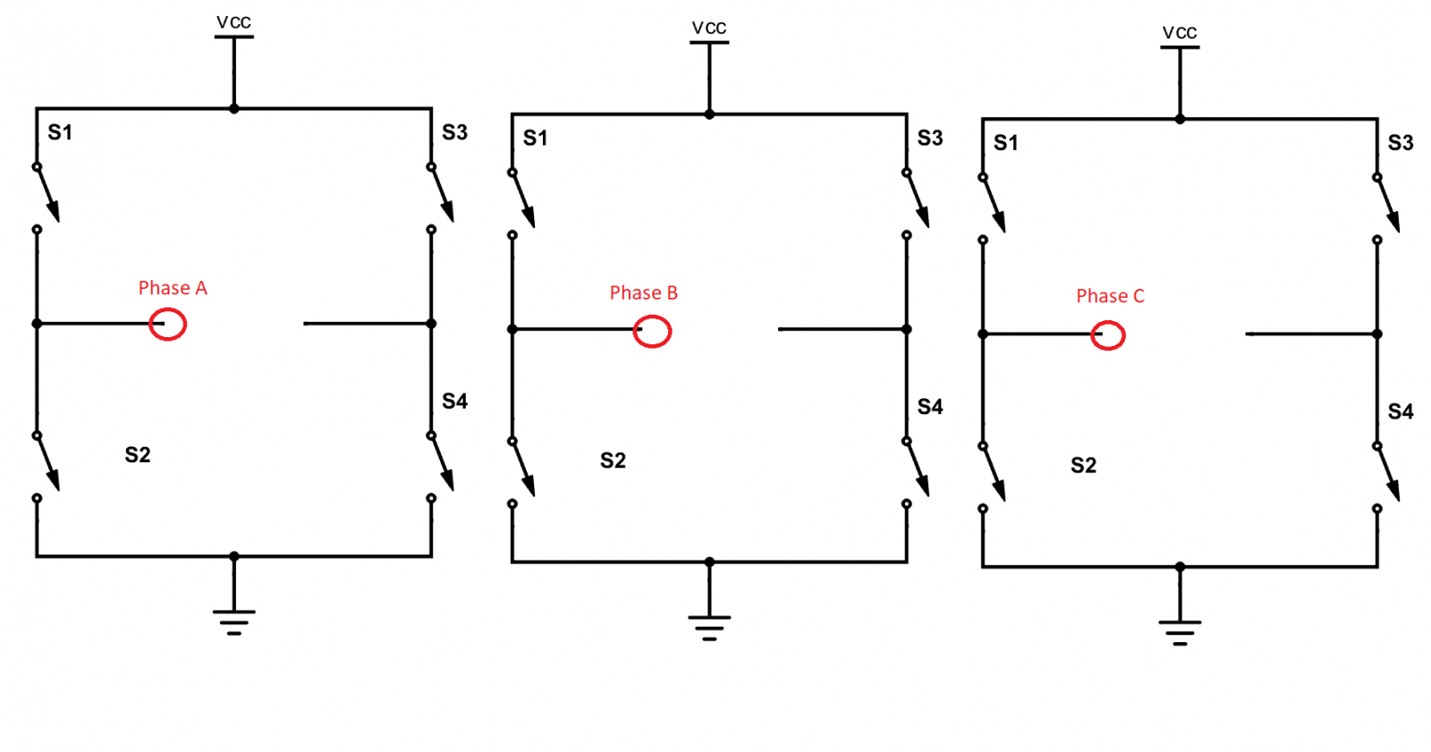

    Switching method.jpg Follow the current flow from top to bottom via the closed switches in red. So how do we use this on a bi directional H bridge? This is how:

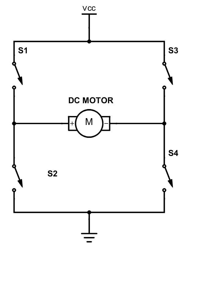

    A normal persons H-Bridge:
    My crazy idea:
    wtf is this? stay with me here. Go back to the current flow picture. notice the switch setup? It is identical to the left side of a DC motor H-Bridge! How does this work with a Monster motor you ask? (maybe not but I'll tell you anyway :) ). The way you change directions on a Monster Motor driver is to apply 5v on pins A1 or B1 for clockwise or anti clockwise. When those pins are activated they turn on either (S1 and S4) or (S2 and S3).
    By alternating those pins I can turn on either S1 or S2. This re creates the same current paths as the current flow picture. Here is a crazy picture to depict this flow for phase sector "1 0 0": The blue line shows the current path.
    So you can now see that by using 3 different H-bridges we can flip A1 and B1 to toggle through the phase sector sequences.
    Some simple code in arduino and I was able to automatically toggle through the different phase sectors and watch the motor spin. great success!

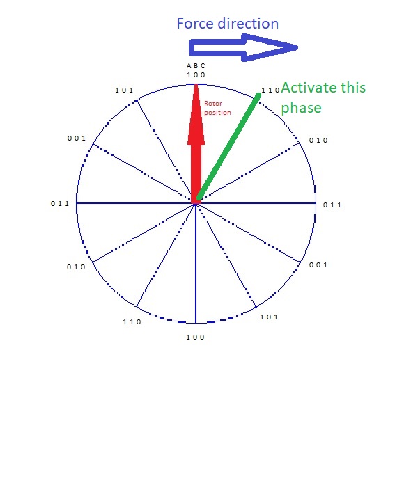

    So now we can direct the motor to go to whatever position we want the next step is to somehow get the motor to give our hands some torque! One thing that I noticed when moving the rotor by hand is that when you apply power to one of the phase sectors the rotor wants to center itself on that sector. We can use that behaviour as directional torque! Say for instance we are holding the wheel and the rotor is centered on sector "1 0 0" and we tell the motor to go to sector "1 1 0" the motor tries to spin clockwise and exerts a force on our hands. Bam! there is your FFB!!
    As it turns out the maximum torque that the motor will exert is if we activate phase sectors that are 30 degrees away from the current physical rotor position. Essentially we need to code that every time we get a FFB signal from the game that needs to be at phase sectors 30 degrees in the required direction. By varying the PWM to the H bridge we can also control the amount of torque applied.
    So we have to physically know the position of the rotor with a high degree of accuracy. Fortunately the Arduino Due has this covered. There is some code available which uses timers to read 2 channels. This can be used to read and track an A and B channel of an encoder. Here is the code. So far I have not been able to miss any counts.

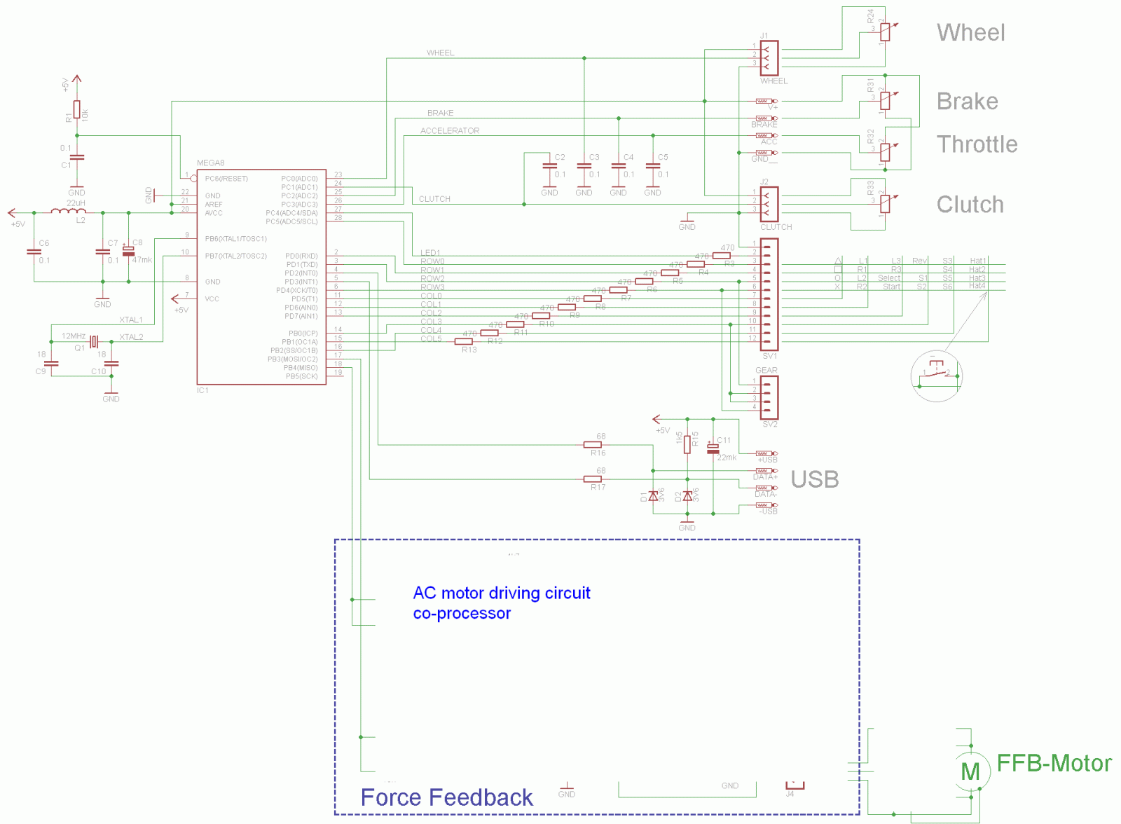

    So the way I am using all of this is to use the MMos FFB to receive the FFB from the game, reading the direction and PWM and plugging that into my arduino code. The PWM value that I read from the MMos is passed through an RC filter to give me an analog 0 - 3.3V signal which is them mapped to 0 - 255 and used as the master PWM value. A bit of explaining on how I use this:

    This is where I got to today. Connected everything up and fired up rfactor. Great success!
    For the purpose of a FFB wheel this code works! and you get the force detail of what your car is doing.
    More testing needs to be done and some sort of deadzone needs to be applied or filtered as the transition at top dead center gives a quick jolt through the wheel. Not sure what is causing this but it's day zero of testing and I'm sure ill find out what is causing this jolt. Maybe my control method is junk, I don't know. I just tried to go through this in a logical physically represented fashion in my mind and it works!
    So if anyone wants to try this out I'd be happy to help guide you out in the process of getting this together.

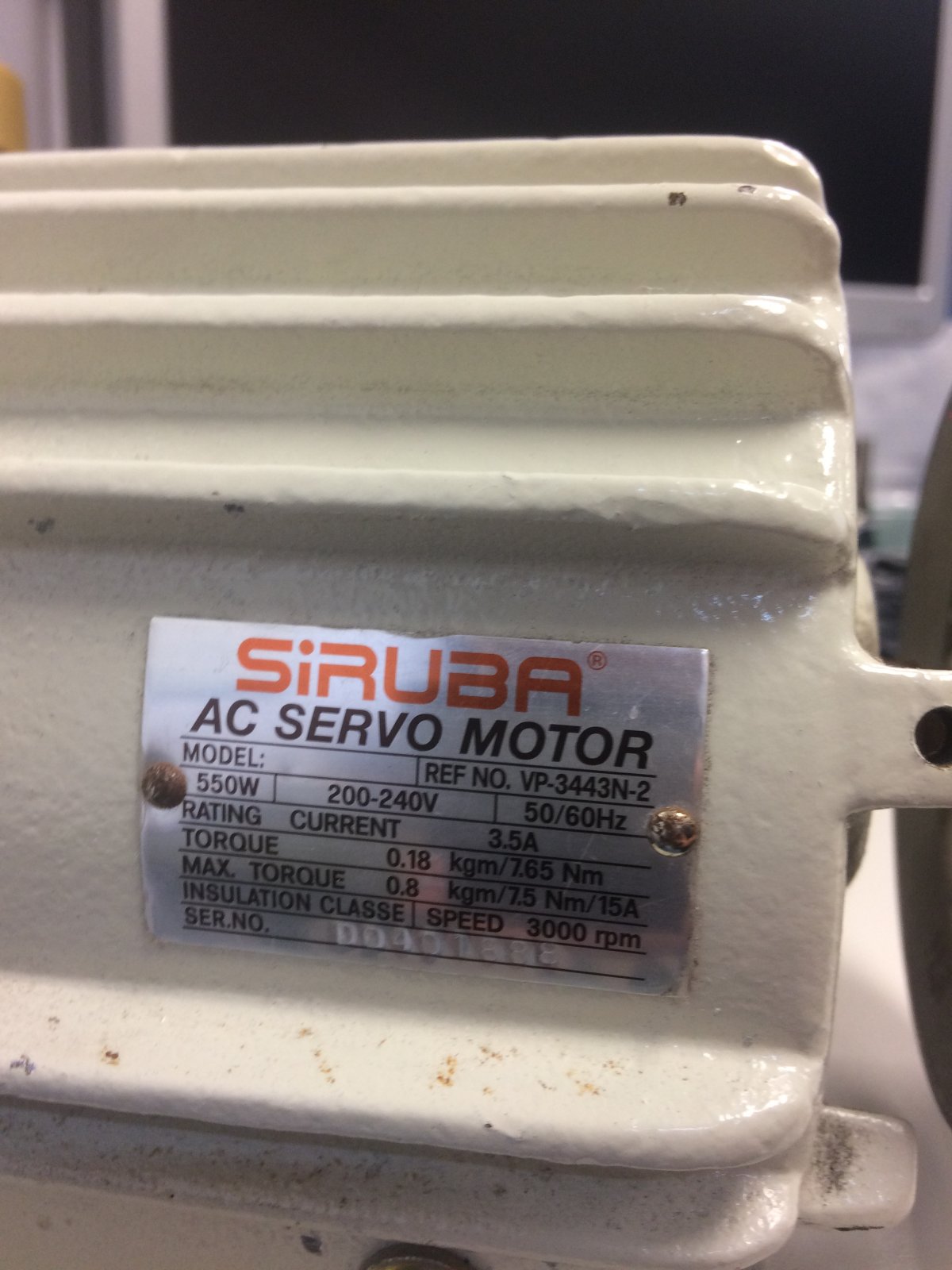

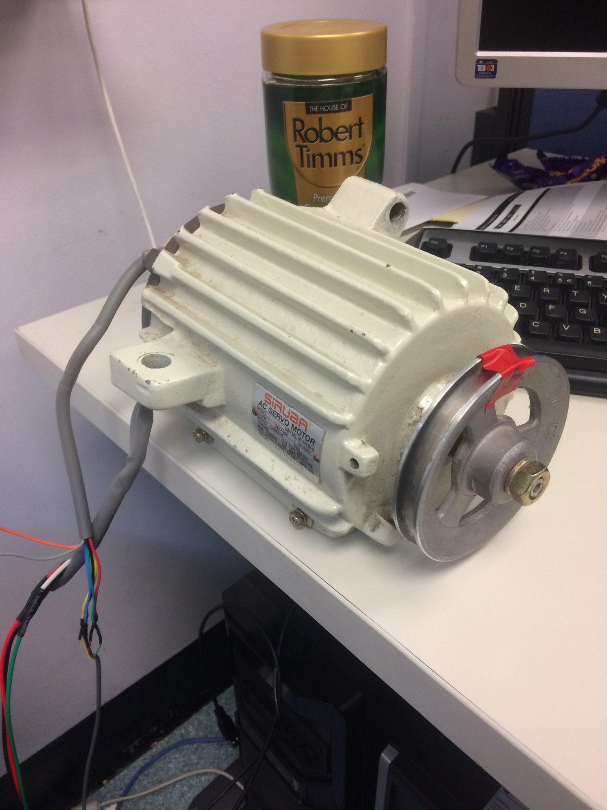

    // PHASE C Control
    PWMCmath = map (PWMC, 0, 255, 0, 255);
    consPWMC = constrain (PWMCmath, 0, 255);
    if (PWMC <= 0){
    PWMCcalc = consPWMNEG;
    DIRCA = LOW;
    DIRCB = HIGH;
    if (PWMC >= 1){
    PWMCcalc = consPWMC;
    DIRCA = HIGH;
    DIRCB = LOW;
    //OUTPUT TO H BRIDGE
    //Phase A
    digitalWrite(M1CW, DIRAA); //Direction Pin
    digitalWrite(M1CCW, DIRAB); //Direction Pin
    analogWrite(M1PWM, PWMAcalc); //PWM Pin
    //Phase B
    digitalWrite(M2CW, DIRBA);
    digitalWrite(M2CCW, DIRBB);
    analogWrite(M2PWM, PWMBcalc);
    //Phase C
    digitalWrite(M3CW, DIRCA);
    digitalWrite(M3CCW, DIRCB);
    analogWrite(M3PWM, PWMCcalc);

    What I am hoping to achieve here is that someone with a bigger brain than me can point out any errors and also enable further development so that there can be an affordable Direct drive wheel system.
    So far I haven't seen anything that has matured to an widespread direct drive system. I'm hoping that this also does not turn into a dead project.

    Good to see you trying something new Alexey.
    I'm not really sure but you are trying to run a 3 phase induction motor like a 3 phase stepper motor.
    What I disagree with is the way you are trying to do torque control with the PWM, it is very similar to the way stepper controllers use to achieve micro stepping.
    I suggest you look at what a chopper drive is and apply that to your code instead.
  12. Alexey
    Alexey Well-Known Member
    Sep 23, 2014
    452
    Electronics Technician
    Adelaide, Australia
    8,066Coins
    +623 / 2 / -0
    Not like a stepper but more like how you would control a brushless with SVPWM. Using the rotors physical position to calculate the next coil sequence that will cause the rotor to turn in a specific direction.
    So what you calculate is: what position do I want to rotor to be attracted to in relation to the current position of the rotor. A position that is 60 degrees away attains maximum rotor attraction/force.
    So what I do is always point the rotor 60 degrees away and pwm the voltage applied. The PWM duty cycle then determines the torque because the rms voltage is related to torque. Whether rms voltage and torque is linear I don't know, also I do not know that the torque vs voltage relashionship is with this motor as.
    This information is almost impossible to find as all references point to SPEED vs voltage and torque, my speed is effectively zero.
    So what I try to look at is literature that talks about static torque, which again is lightly brushed over in all literature as the primary use for these motors is speed!
    I've looked into chopper drivers but cannot find any references to using them in a 3 phase system. From what I have read so far, the chopper driver is a way of planting a pwm on top of another pwm for fine tuning current passing through a system. But still, the PWM control method has to remain with an adjustemt system built on top of that.
    In a way I already am "chopping" the output pwm by applying a pwm to both directional and pwm pins on the h bridge, just that I am not monitoring the current (also need a higher pwm frequency that "chopps"). which is actually possible on the Monster motor driver as is has a current sense pin. I don't intend on staying with he H bridges anyway so not much more development will go into them as I need higher voltages.
    As it runs now I can control the torque with pwm with the H-bridges but as I move to the VFD driver I am going to have to think of another way.
    Attached is the driver stage of the VFD that I am hacking up.
    I could adapt a chopper to the pwm inputs of the driver stage but in terms of current sensing I am unsure as the voltages are quite hazardous.
    The biggest problem I have at the moment is that there doesn't seem to be any freely available literature specific to what I am trying to do. Anything that has already been devloped by third parties is held close to them and not released to the public.

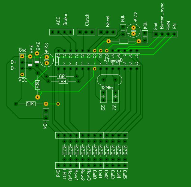

    I have a FFB source code but its not in C language (arduino). Its for AVR atmega8 with 12mhz crystal to emulate USB1.1 device directly.
    I could share it with you in case it helps adapt it in arduino, or use as alternative to the MMOS...

    I'll send you link on PM. Did I mention it emulates a G25??
    See the diagram for now:
