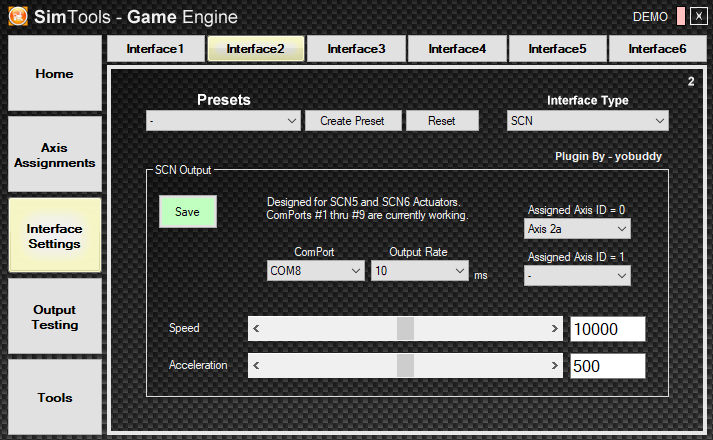

    I have the same problem. I'm also setting up SCN5 interface with two axis and I get the message "One of your interfaces requires GameEngine to be restarted".
    I already checked ID things and it's set up correctly. In fact when I start Game Engine one of the axis goes to middle postion but only one of two. If I disconnect working one COM6 port then not working COM8 axis starts working. So they work separatly but not together.

    Just figured out that I'm not able to connect to them simultaneously using two Termi-BUS apps.
    Probably they somehow interference with each other. Maybe my auto directon control was somehow messed up. [​IMG]

    I got them working together. Please watch the video.
    But when I go to SimTools only one of them working. Second COM port is disconnected and I'm able to connect to him via Termi-BUS.

    But I got both working by SimTools 1 time in 10.
    Sometimes works only first actuator, sometimes only second and rarely working both. :confused:

    Ok! I found a problem! It was actually error in auto direction control schematics.
    Now everything is working.
