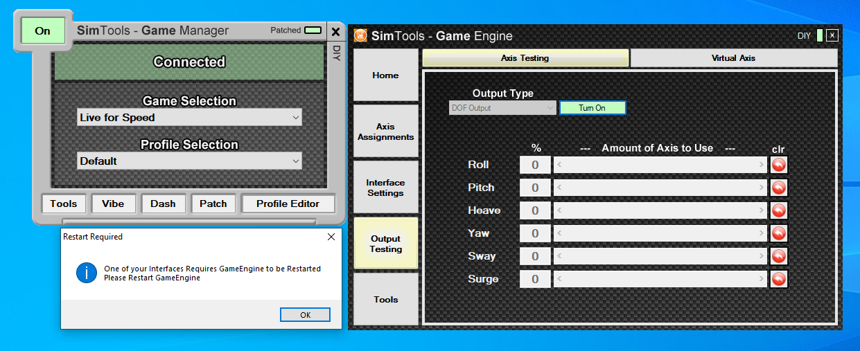

Question One of your Interfaces Requires GameEngine to be Restarted

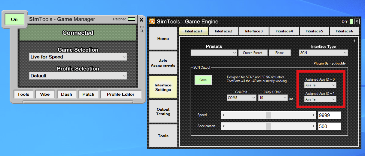

    Can you please post pictures of all of your settings, that may help others to make suggestions.

    This is the screenshot of my settings.

    It looks like your trying to run 4 scn actuators?
    2 scn's connected to each serial adapter?

    No. Each SCN5 has its own card with its own port

    Your assigning 2 axis to each thou.
    This tells the interface you have 2 scns attached, one with the id of 0 and one with the id of 1.
    So you probably need to remove the second one.

    Finally thanks to you yobuddy, I didn't understand the drop-down menu. I am very rusty and I hope that this can still be of support to the community, I have been standing for two years but now I am back to have fun on the Sims you are number 1.
