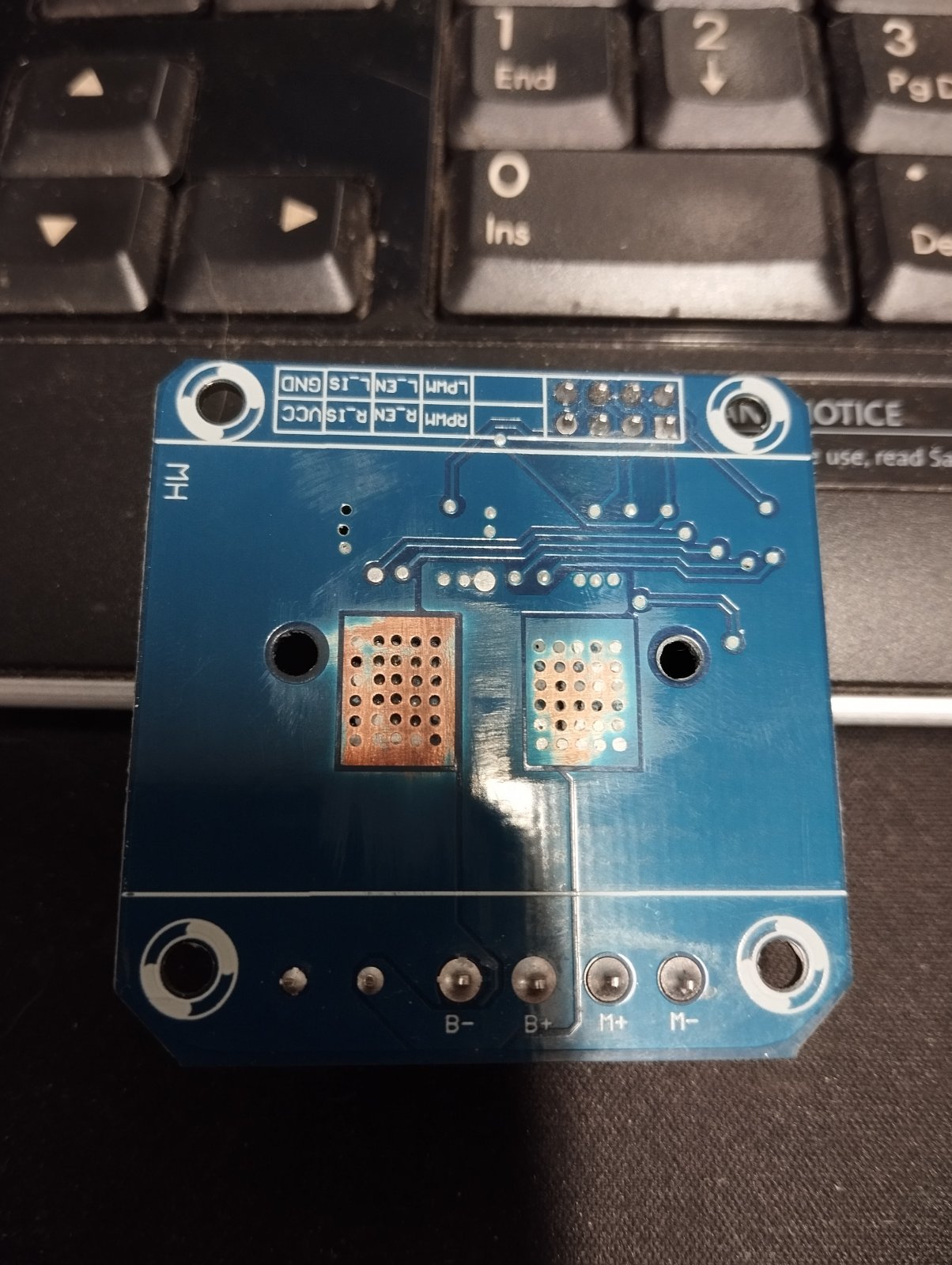

    Hey guys have you had any issues where just one of your ibts_2s are getting hot just doing the initial testing in smc3 utils ?
    could really do with some help not sure what could be causing it.
    i know its not pulling too much current as i have 25Amp inline fuses and these have not blown.
    i have checked my Arduino wiring and all seems to be as per the diagram on the SMC page.
    i have also replaced the ibt to make sure it wasn't a faulty one.
    thanks

    I have now heat sink compounded the heatsinks and got a fan blowing ait over them to cool them this has helped slightly but still struggling with thermal shut down.

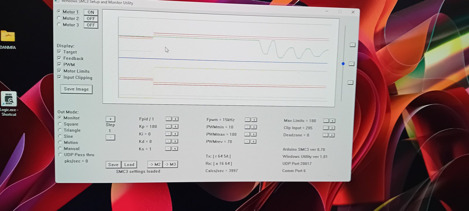

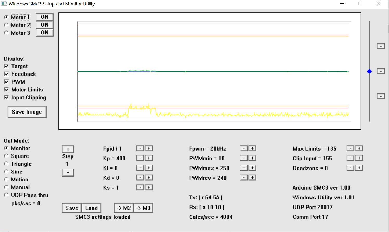

    However whilst I have been looking through everything these last couple of weeks I have noticed my smc3 utility is showing me some data that may be the problem

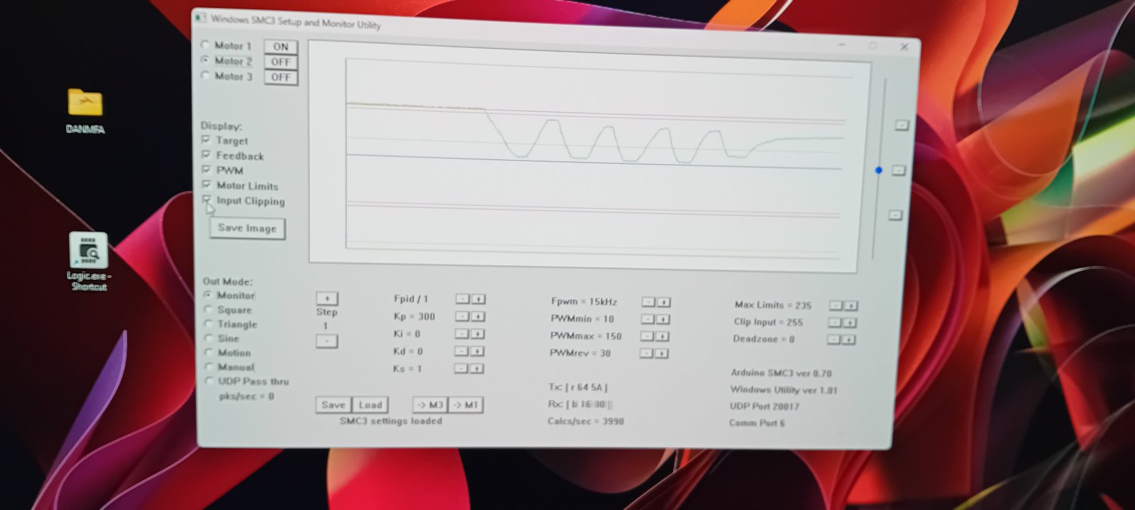

    On motor 2 I can move the hall effect sensor and the green line shows it moving.
    But if I switch to motor 1 and move the motor 2 hall effect pot it shows it moving.
    Could this mean the arduino could potentially be trying to drive both motors against each other causing the heat. Or is this normal for the hall effect to show in both motor windows?

    Neither Hall sensor seems to be properly centered, is there a reason for that?
    Each motor should behave as expected, something is fundamentally wrong if they do not.

    They are normally centred at neutral ride height. This is with the motors off and the rig at full droop or rest. Which is why they are at the top of the scale.
    Could you confirm I should only see one hall effect in each chanel on smc3 utility? As my scope is showing them separate.
    I think this is highly likely where my issue could be coming from. Might have to get all the parts back on the test rig at this rate. And go back to basics.

    SMC3Utils cannot control two motors at the same time, it always controls only one motor .
    If you want to show something from SMC3utils screen then post screen captures instead of photos ( photos are too blurry and unreadable).

    I will try get some better screen shots. But my issue seems to be that say I move pot 1 which is attached to motor 1 that shows as the green movement in motor 1 when monitoring on smc3
    If I now switch to monitor motor 2 I can move the motor 1 pot and that still shows as a moving green trace this is what I think my issue could be. But not sure how.
    I know smc3 can only control 1 motor but surely it should be sampling motor 2 pot when you are viewing/controlling motor 2. So I think there may be an issue with wiring or arduino possibly.

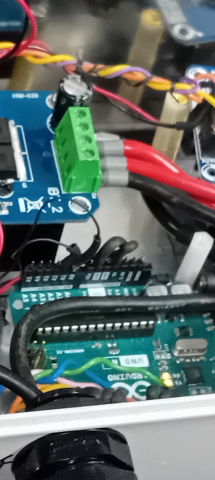

    Hey,
    what kind of motors are you trying to control? Voltage, Watts etc. would be helpful. Also can you make some photos of the connections of cables to the IBT etc.?

    The motors I am running are a 24v wheelchair motor.
    520w each
    They are wired in 10gauge silicone wire
    And the data and 5v power for the ibts are all run in 26gauge.

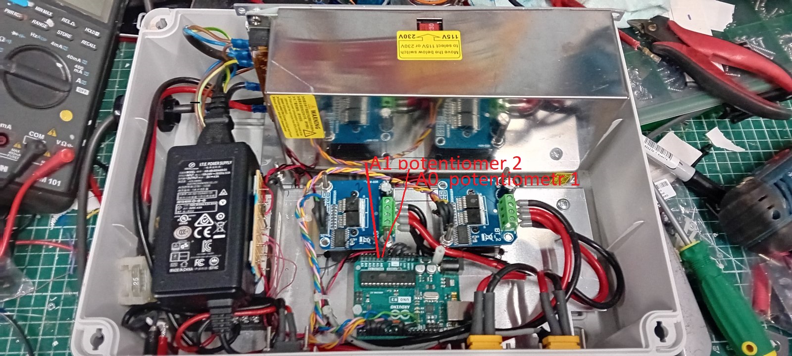

    Unfortunately not :( it's definitely there and connected.

    Ok , well that leaves one option , unsolder the cables from the A0 socket and then check if you have a correct reading from the second potentiometer ( just don't accidentally turn on the power to the motors)

    OK so it turns out my pot issue was down to the fact I was disconnecting one to isolate them for testing and smc3 displays the value of the pot on every monitoring motor channel if only 1 pot is connected once I connected them both up at the same time they are behaving as expected pot 1 shows on channel 1 and pot 2 on channel 2
