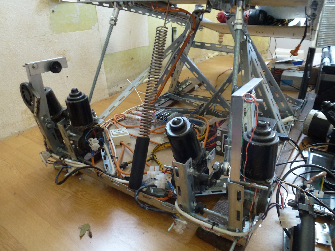

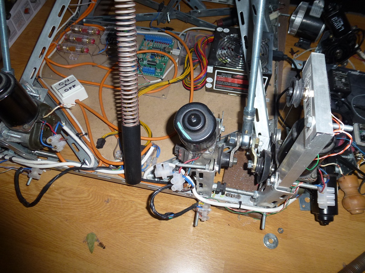

    Hello ,
    I have that kind of build . With two motors on axis and i have no problem with them :) . Simulator have power enough to work with 120 - 150 kg on it. There is some youtube video attached .
    And some photos.

    @auryza: very well done! :cool:
    I see that you don't use a toothed belt for your pot: don't you fear any sliding?

    Yes you are right i using only fishing cable . :) But is not problem sliding is not noticeable . It still working well and easy adjustable .

    Dear Auryza:
    Your configuration is interesting... i did'nt understood how you countrol your motors?
    - each motor is countroled independetly?
    or
    - the two motors gets the same information from the countrol card and are connected to a single pot?
    best regards
  18. auryza
    auryza Active Member
    Jun 12, 2013
    109
    Lithuania
    4,337Coins
    +76 / 0 / -0
    2DOF, 3DOF, Arduino
    Two motors one pot and one motor driver channel . At this moment i'm using a sabertooth 2x25 A and k8055 control board (x-sim software),. but i have and arduino with 2x60A chinese motor driver .I tried already with Simtools software . And motors running well .
