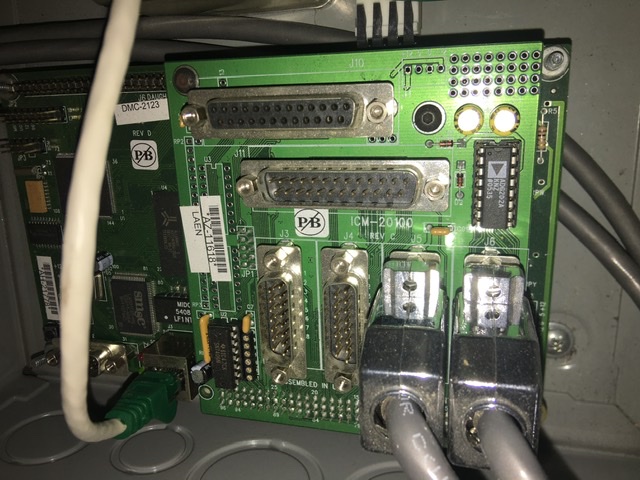

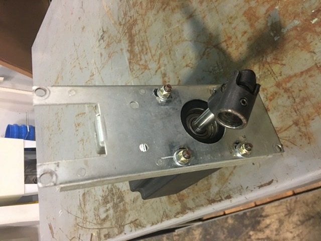

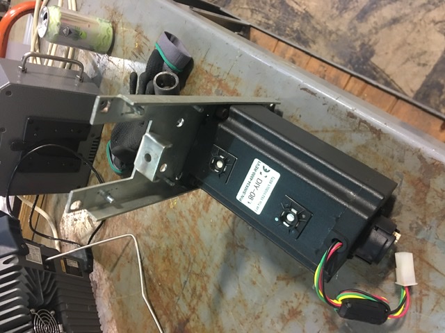

    UPDATE: I now have an AccuForce DIY kit replacing the old 270deg arcade system, having dismantled the old mechanism and drilled new holes to fit the motor (was snug and worked out perfectly). With that done, I’ve decided to hold up on replacing the mechanism for the pedals, as they work well enough for testing until I can get the rest sorted out.
    The current issue I’m running into is software related. As stated before, I can get the system to work with a proprietary program made by InMotion simulations, but this program only works with nascar 2003. I’m trying to find a workaround so I can get the hardware to work with other games (assetto, project cars 2, iRacing, etc.).
    I have tried talking with a guy at SimTools but he hasn’t been very helpful or doesn’t seem to understand my inquiry. The correspondence we have had led to him asking about how I’m communicate with the controller, which I responded that I can, and then he asked if I could “write some code” for the controller to operate. I don’t know how to do that, so I’m at a loss.
    I really want this to work but I need some real assistance. I’m ultimately stuck on trying to get some solution to this other than NR2003 as my only playable game with motion.

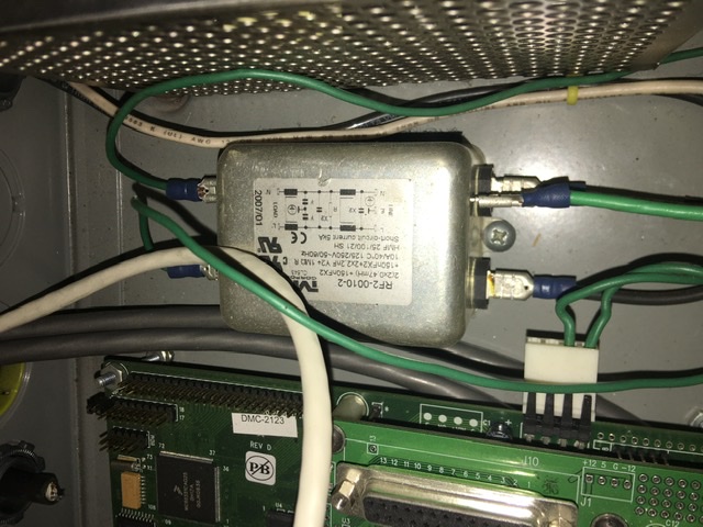

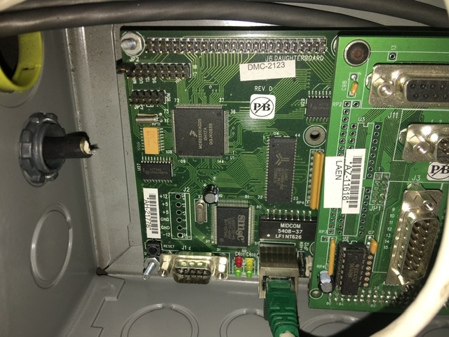

    the controller is a DMC-2122 from Galil. I have it properly communicating with my hardware, using an Ethernet/network connection to my pc and the controller set to 192.168.1.50. The two programs, GalilTools and DMC Smart terminal, both connect and are communicating with the controller. The motion software, InMotion program with embedded telemetry acquisition for Nascar2003, works as well once these are connected. This means to me that the InMotion software is obviously sending some set of commands directly to GalilTools and making the controller do its thing. So, to me, there must be some “code” already being administered I should be able to use.
    Any ideas?
    Also, here are some pictures of the controller (DMC-2122) and the modification I did to the steering system.

    At this point, I feel like I am so close to the finish line and just can't cross it...I know how to communicate with the controller, I've figured out what functions make the motors work within the Galil software, I know what each function does and yet, I am still not able to figure out the last steps to get a plugin that works with knowing these functions. It seems like a solution is there, and I just don't know enough about what the "code" that is needed for the plugin or commands with the SimTools software is required. I don't want to think that a motor controller and software that works needs replaced simply because the solution isn't right in front of me.
    Here is a text file showing all the commands that go into the Galil Terminal to get it to operate. Any help would be great, and I'm happy to explain in detail what each argument means (BG for begin, X and Y being the axes that it operates, etc.)
    I'm really trying here and I feel like a solution is within reach!

    I looked at the CODE .txt file and if I read that right, the different sets of numbers for forward, back, right, and left are described as speeds in Hz and not as positions?
    Code:
    MOTOR 1 IS X, 2 IS Y
    JG COEFF ARE Hz SPEED OF JOG
    In that code.txt file, is that something you can send to the controller where if those numbers are changed the rig goes to different positions, or does it go to the same positions (the various extremes of travel) at different speeds?
    The forward/back/left/right stanzas are all 515.54 with only the sign changing. What I’m wondering is if the control is proportional where you can send it to specific positions? Are you able to make the rig move using that text file somehow?
    I’m trying to sort how the thing works and what tests can be done to better understand the control scheme. What I’m afraid of is that it’s a throw you around at different rates kind of control and not servo positioning control.

    Hi @Zed ! Thank you for your response.
    Yes, the values after JG ("Jog" in the 2-character code that Galil responds to) represent the speed variable (in this case, 515.54 roughly translates to about 1Hz on the motor); however, the absolute positions can also be sent via the PA (Position Absolute) command with values for X,Y following (as shown in this document for the "Center All" command, which shows them being sent back to 0).
    Considering the InMotion program shows Forward/Revers limits of the encoder counts at +/-4800, this would mean the absolute limits are within this range. Thus, a value of 2400 would be 50% of overall limit, 480 @ 10%, and so on.
    I believe the system can work as both a speed variable or absolute, but once the InMotion software acquires telemetry from NR2003, there are no longer feedback commands being presented, so I wouldn't know which of the two that particular program is using. There is absolute positioning too, however, so I would assume that could also be used if necessary.
