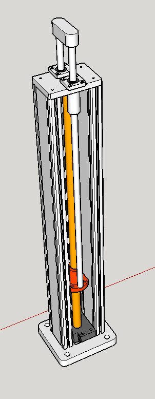

    I thought upgrading my actuator with something similar, but, my fear is that most vibration is comming from my cheap 1605 from china, are they really straight ?
    The goal of my design is to keep compatiliby with my current actuators ... I don't have a spare motor to manufacture a 7th actuator :/ and I already have 2 spare 600mm 1605 ..
    The part that link the 2 10mm rod to the red piece is missing. The rod would be 10mm x 700mm from 3d printer parts.
    What do you think ?

    0.48 layer height 0.72 width and im using a 0.6 nozzle 30-50% infill depends if you can be bothered waiting the extra time for it to print

    Ok last questions(I Hope!). What filament did you use? ABS, PETG, PLA, PLA+, CarbonX?
    Also, watching your videos you talk a lot about the noise. Do you find it takes away from the experience? If you had it to do again would you stick with the ball-screw actuators you built or go with the AC motor style like thanos has done?

    PLAplus j used first but now use PETG dont think it really matters tbh
    Its the ballscrew that makes the noise so no getting away from it but I can't hear it at all in my headphones its only when I listen back to my strea. I can hear it
