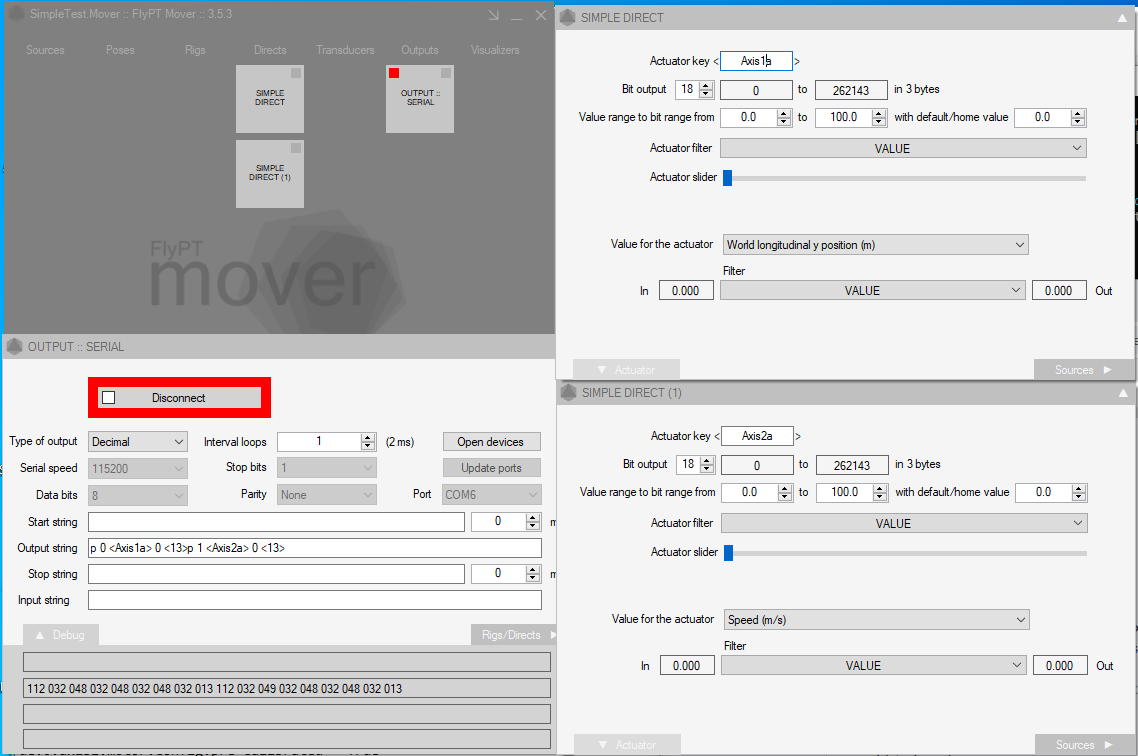

  4. jimmejames
    jimmejames New Member
    Mar 28, 2015
    15Coins
    This wasn't requested in the original post, but given FlyPT is opensource, an excellent tool, and an easy way to verify operation of the Odrives, here's the configuration I used. Note, the intent is simply to verify the Odrive is responsive to inputs, this could not be dropped into a trainer as-is (there are plenty of other examples in the forums of others' setups).
    This was done on an opensource Odrive running the 0.5.4 firmware (board from the post immediately above) and on FlyPT Mover 3.5.3.
    If difficult to read, I added:
    • (qty 1) Serial Output
      • Type of output: Decimal
      • Interval loops 1
      • Serial Speed: 115200
      • Stop bits: 1
      • Data bits: 8
      • Parity: None
      • Port: [computer specific- click "Open devices" and located your port for your Odrive]. And/or, click "Update ports" and select from the available.
      • Start string: [blank]
      • Output: p 0 <Axis1a> 0 <13>p 1 <Axis2a> 0 <13>
      • Stop string: [blank]
      • Input string [blank]
    • (qty 2) Simple Direct
      • Actuator key: Axis1a [for one simple direct and Axis2a for the other]
      • Bit output: 18
      • Value range to big range from: 0.0 to 100.0
      • Value for the actuator: [doesn't appear to matter what you select]
    Then, sliding the Actuator slider on each Simple Direct will cause your motors to spin.
    Now, it appears the <Actuator key> in the simple directs can be about anything you want to be AS LONG AS they match what you have in the Output string in the Output Serial.
    For example, this works:
    • Serial Output:
      • Output string: p 0 <IamAxis0> 0 <13>p 1 <IamAxis1> 0 <13>
    • Simple Direct (#1)
      • Actuator key: IamAxis0
    • Simple Direct (#2)
      • Actuator key: IamAxis1
    But, the names are case specific, so Actuator key: Iamaxis0 will fail as the "a" is not capitalized.
    Troubleshooting:
    The first time through, my Axis 1 did not spin. I reopened Anaconda and checked for errors:
    Code:
    dev0.axis0.error
    dev0.axis1.error
    Both had in Out of 0 (signaling no errors). I then reset the requested state and startup information for Axis 1:
    Code:
    dev0.axis1.requested_state = AXIS_STATE_CLOSED_LOOP_CONTROL
    dev0.axis1.config.startup_closed_loop_control = True
    dev0.axis0.requested_state = AXIS_STATE_IDLE
    dev0.axis1.requested_state = AXIS_STATE_IDLE
    dev0.save_configuration()
    I have not been able to replicate the original error, so perhaps I had a typo in FlyPT?!?
    I'm not allowed to upload my *.mover file (too few posts?)- hopefully the above instructions an image will suffice.
