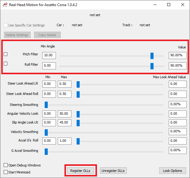

    Real Head Motion Allows you to have a mix of locked to horizon and car and filter bumps.
    My settings keep the car locked to horizon up to 10 degrees of pitch which gives good experience through normal and extreme (monza banking, eau rouge) situations:
