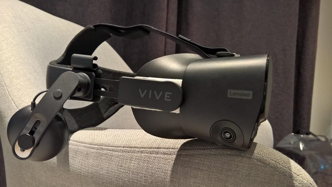

    ahh but i plan on modding my rift s out of the box. ive ordered some additional parts. ive tried the rift s before but not so good with my gaming headset. ive captured a couple of photos to share my ideas.
  17. Tags..(VR)
    Tags..(VR) Member
    Aug 28, 2017
    237
    indiana
    - 6Coins
    +29 / 2 / -0
    though you see the deluxe here, i'll be going with the vive head strap instead.
