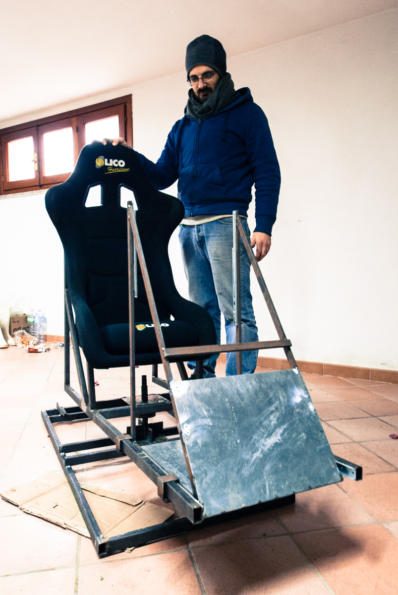

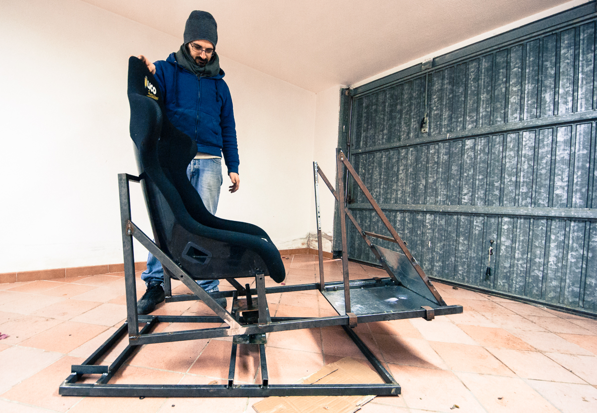

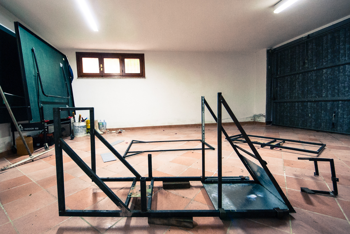

    after a productive day the frame has been almost completely welded. Not big issues so far..
    But from now the challenge will be harder! Can't wait to see the sim moving!
    @bsft, thanks, definitely 150mm CTC is too much, i will look for another solution…

  13. bsft
    if you are going to use 25:1 boxes, and a full frame, go no more that 40mm CTC levers.

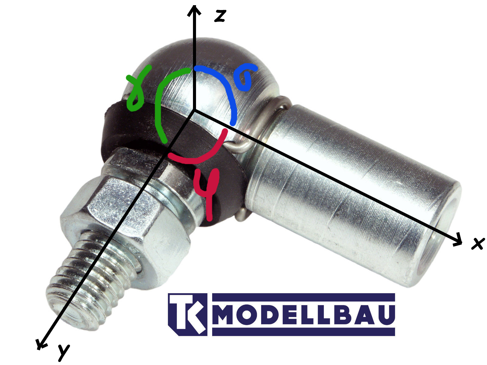

    Has anyone ever tried to use a long screw (like this http://www.bricoman.it/negozio/ferr...a-friulsider-m12x1m-acciaio-zincato/10009913/) and those joints (http://www.ebay.it/itm/221474536259?ssPageName=STRK:MEWNX:IT&_trksid=p3984.m1439.l2649) to link structure and motor? Would it be weak in your opinion?
    Second question relates to Hbridge. I'm thinking to build my own Hbridge capable of driving the ZYT90 motors with 25:1 gearbox. Does anyone have tried to do the same?
    Thanks in advance
    Marco:thumbs

  16. RacingMat
    2,237
    21,028Coins
    hello Marco
    M12 rod should be fine! Is it a shoulder mounted setup? or feet mounted setup?
    my 2DOF shoulder mouinted was Ø12 (but not threaded)
    For the unijoint, you have to check if their angulation meets the angulation needed by your sim.
    Ebay didn't specify the angulation...

    Regarding unijoints, mine is a shoulder mounted setup. Sorry Mat I cannot understand which angulation you mean. Would you mind to indicate me which one is it?
