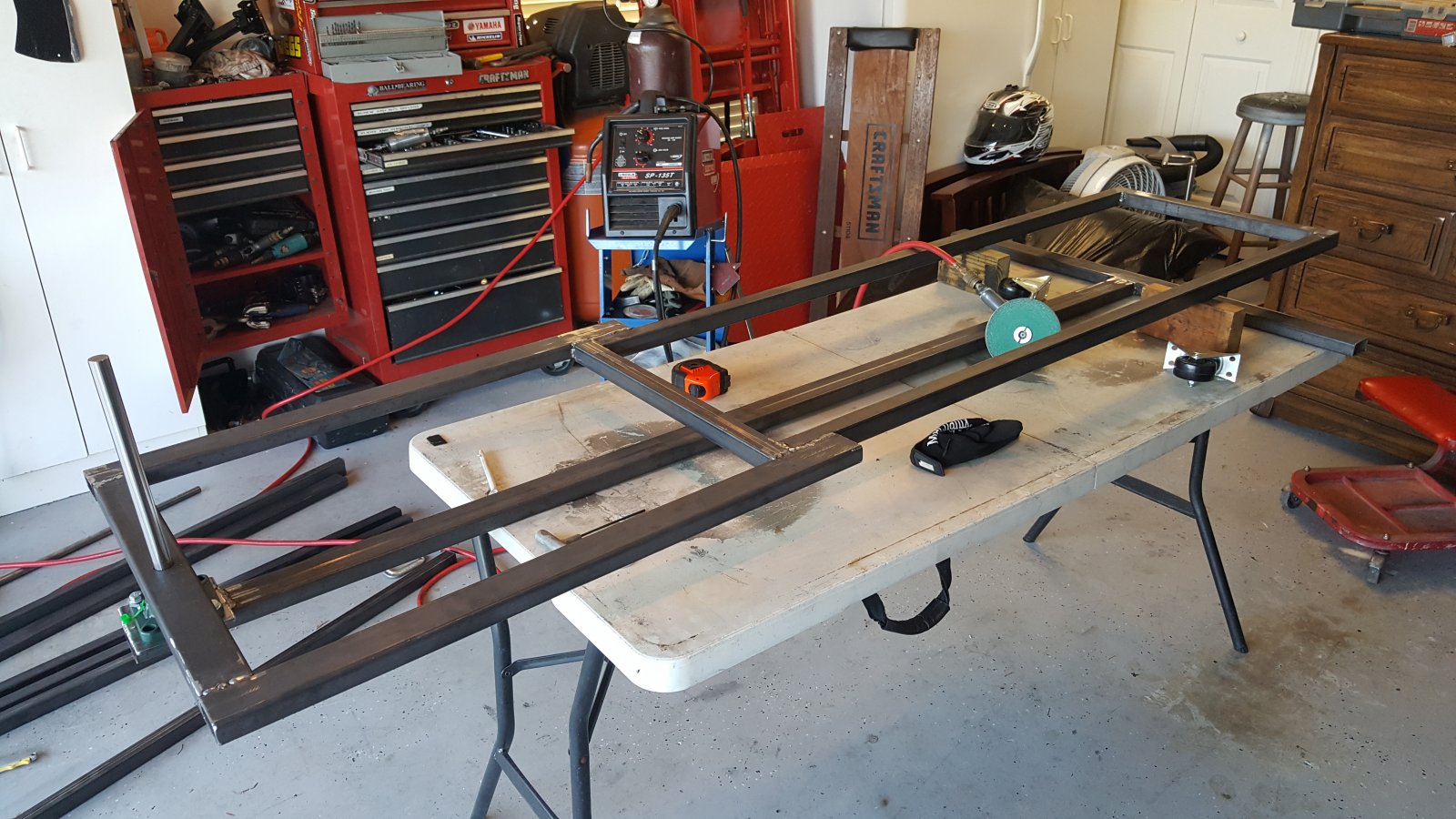

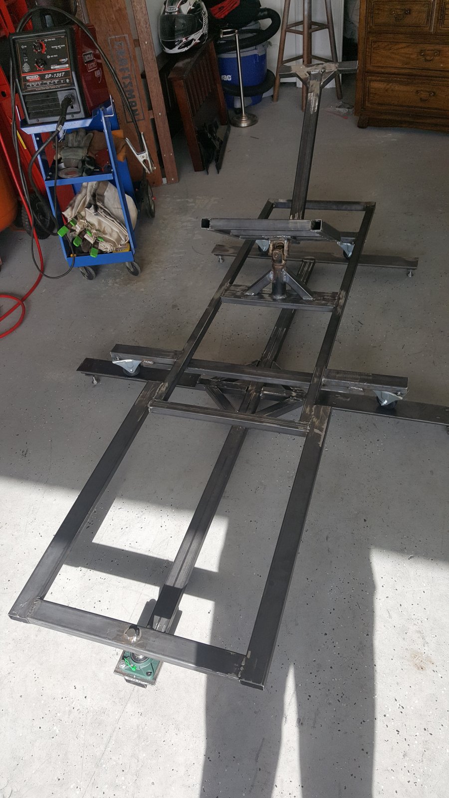

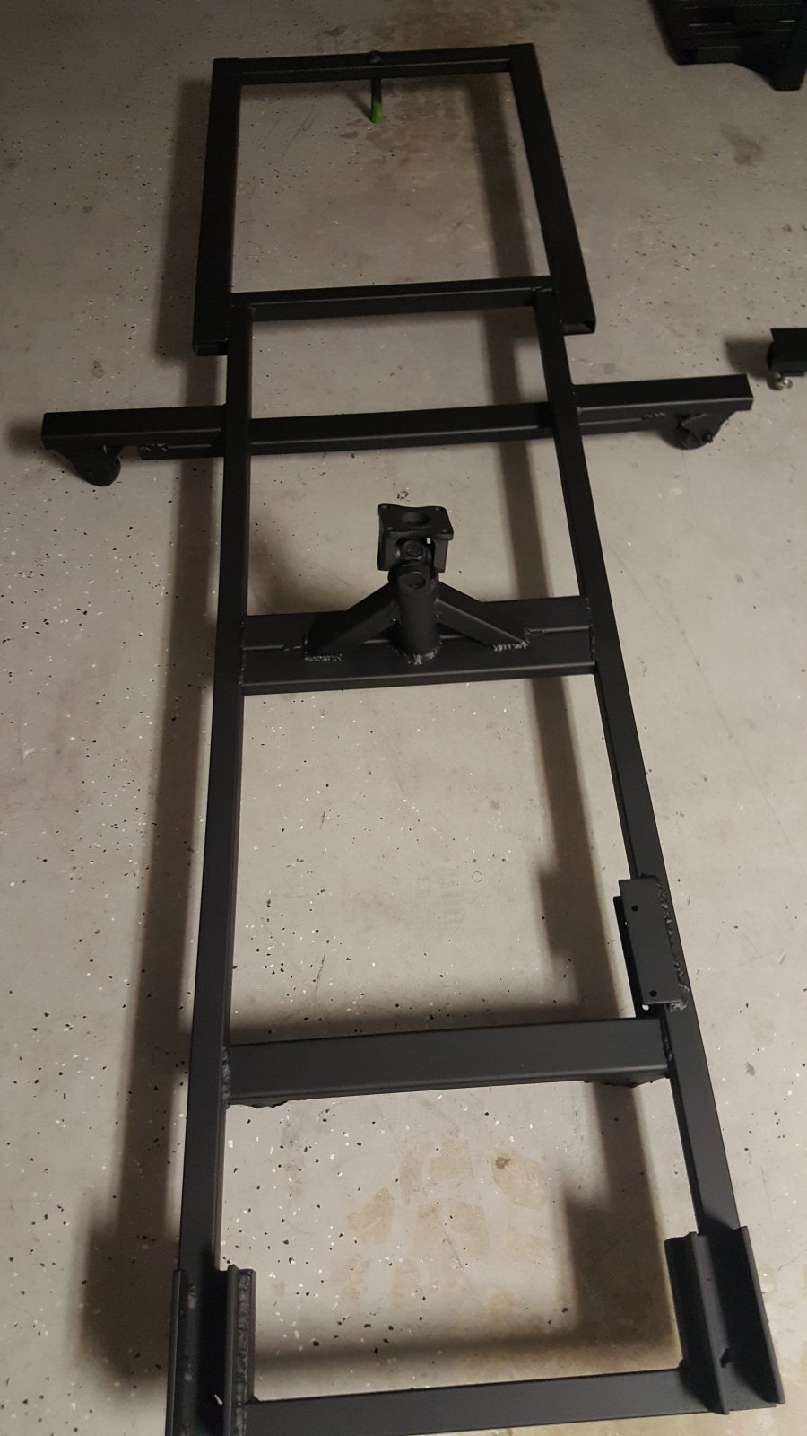

    The only concern I have at this point after seeing the rig in real life.... (drawn in CAD) Is will the whole rig be top heavy under extreme motion? What is the general consensus on width? I can add out riggers easily at this point, and anything else you guys might suggest.
    Here are pictures from today's build....

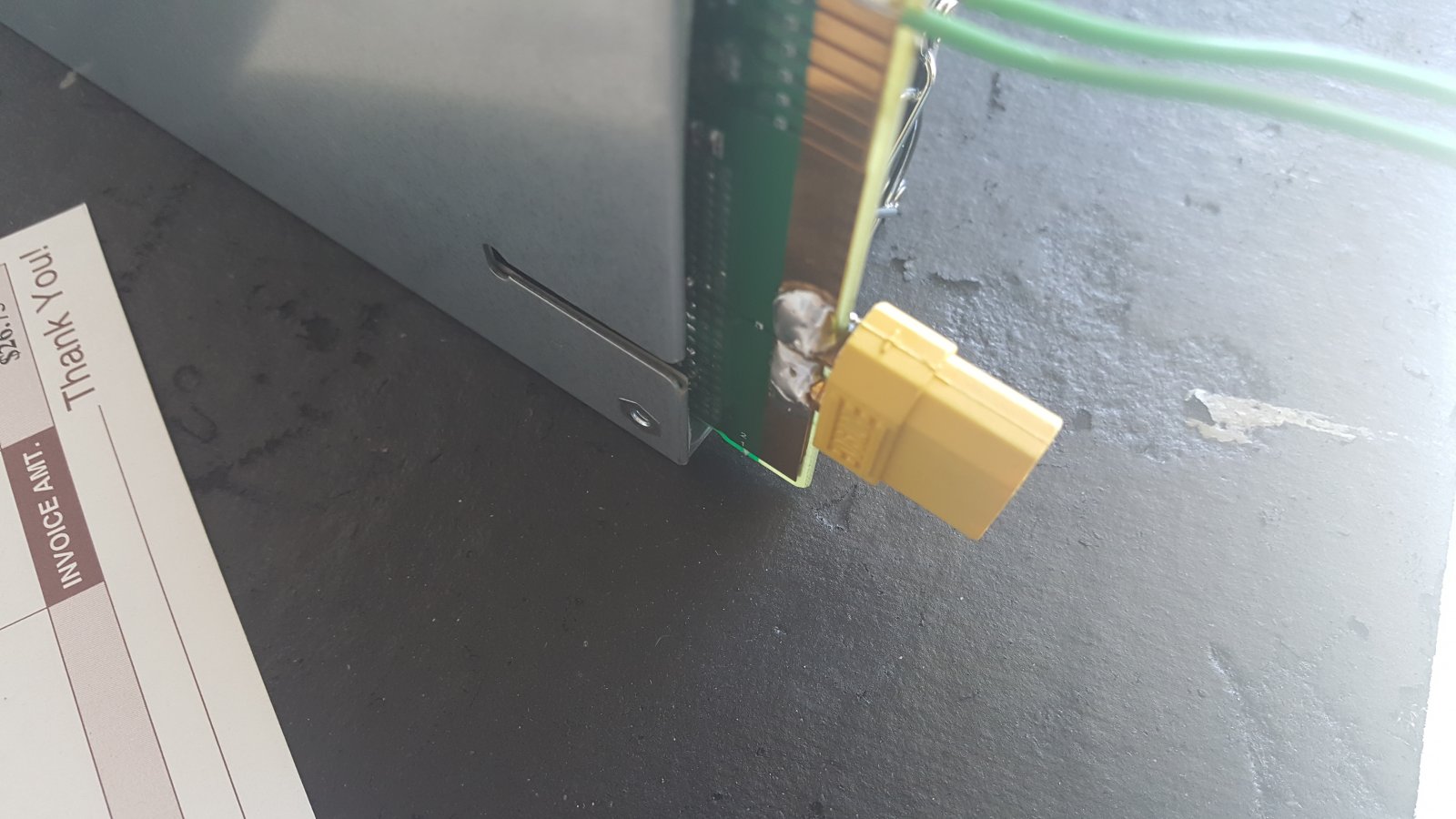

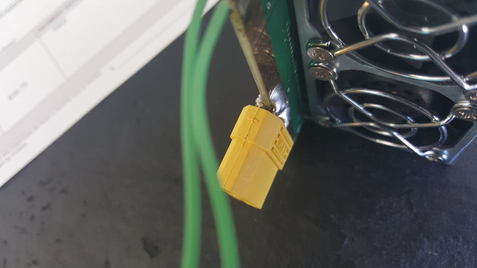

    The PSU's are working fine. Here is a picture of my solution for connectors AND bridging the top and bottom contacts.
    I put a slit in the XT90 connectors with a dremel and then soldered them onto the boards. Works like a champ and are good for 90 amp continuous.
  5. Nick Moxley
    17,057Coins
    +2,506 / 30 / -2
    I highly suggest more than just 2 castor wheels, 2 up front is a wise idea.. Also you'll want to widen your base frame as well. Check out @Avenga76 build....you'll see what i mean about a wider more supportive frame.

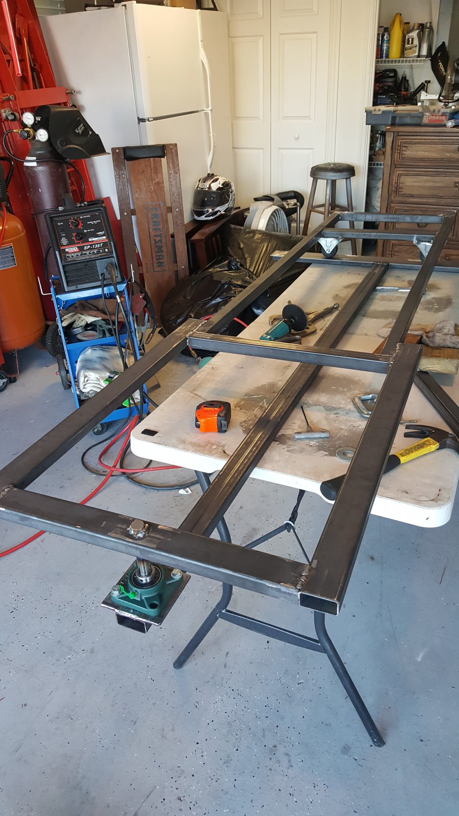

  6. Brett Horton
    Brett Horton Active Member
    Aug 18, 2016
    310
    Program Manager / Pilot
    Tampa FL
    118Coins
    +202 / 2 / -0

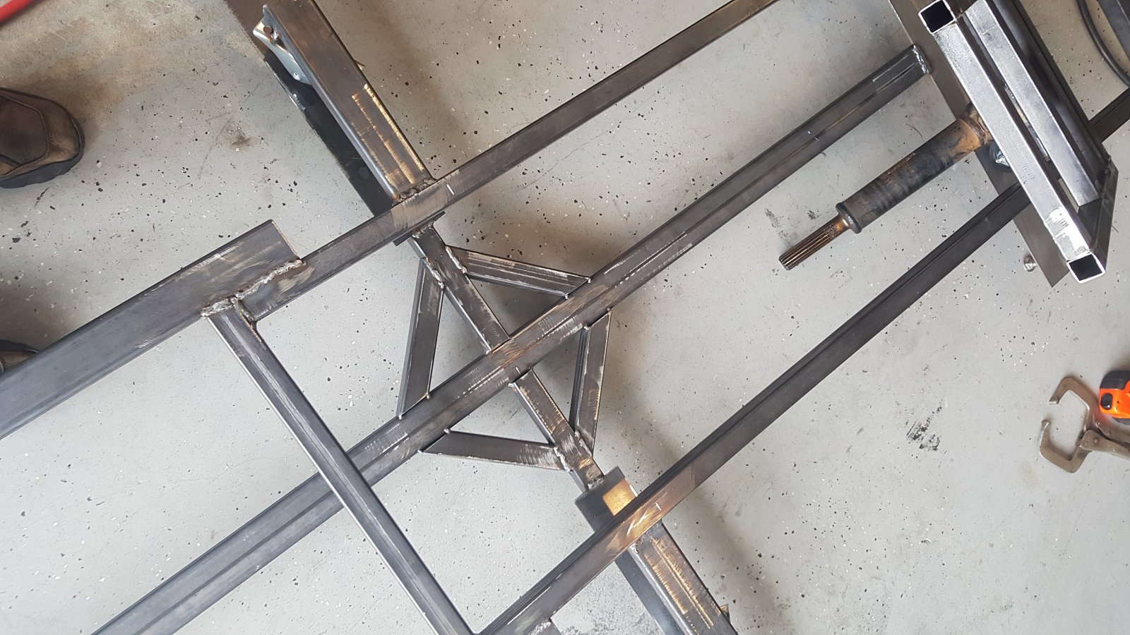

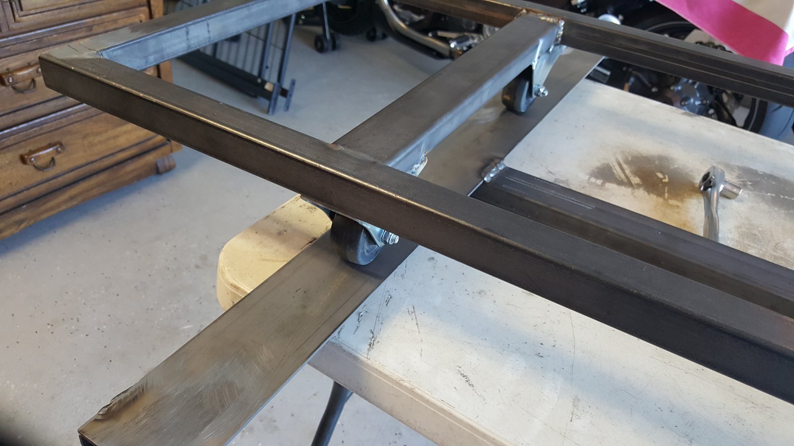

    Yep, I agree, I was in the middle of this all day... Getting close with the mechanical build portion...

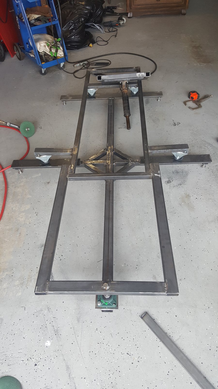

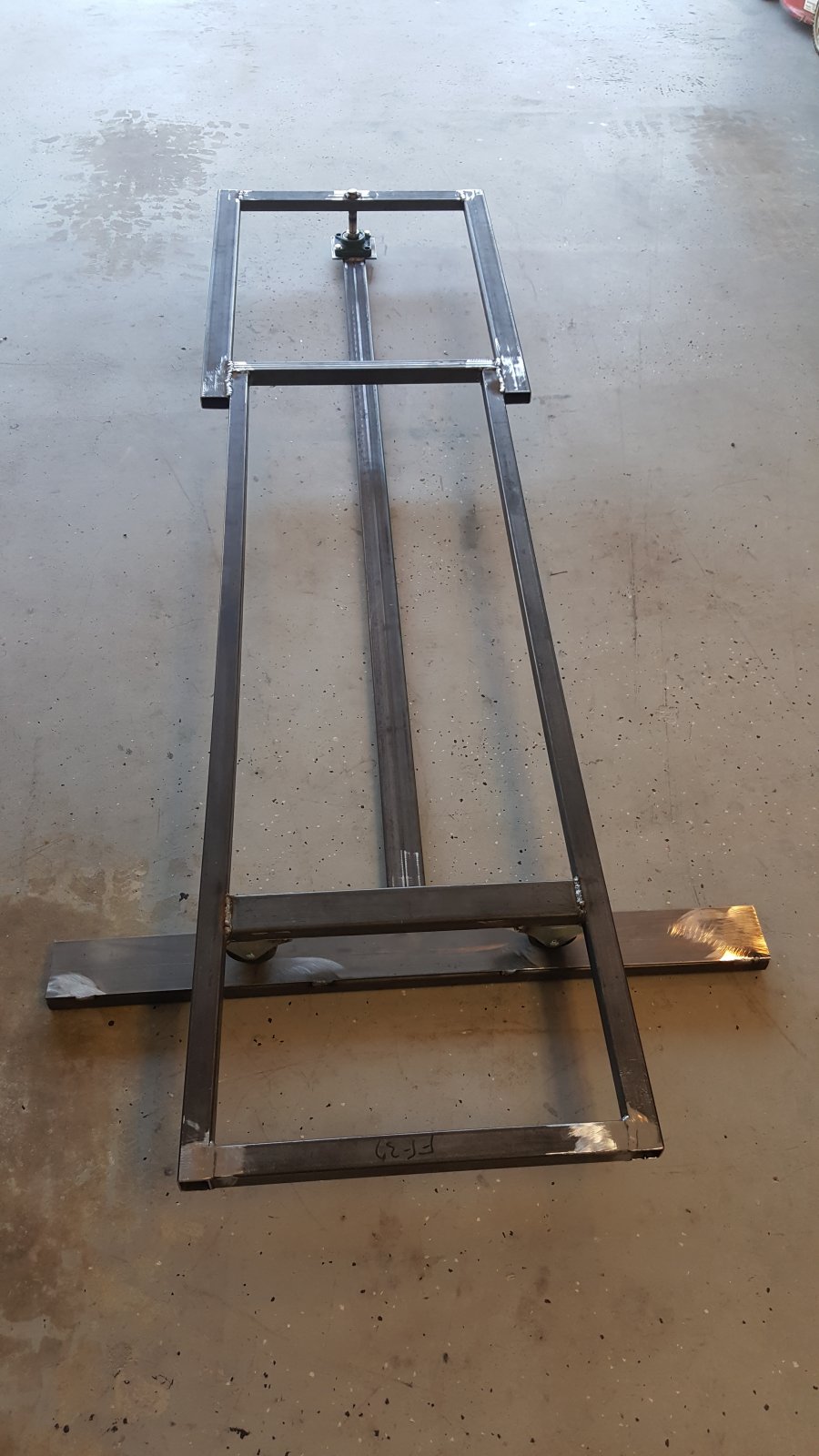

  7. Brett Horton
    Aug 18, 2016
    310
    Tampa FL
    118Coins
    +202 / 2 / -0

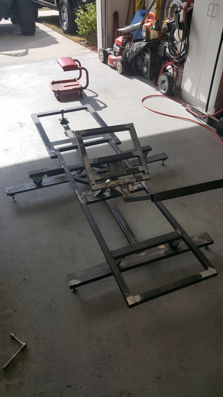

    Still need to add a couple braces for the front casters, since these pictures, Iv'e added the seat universal stalk.

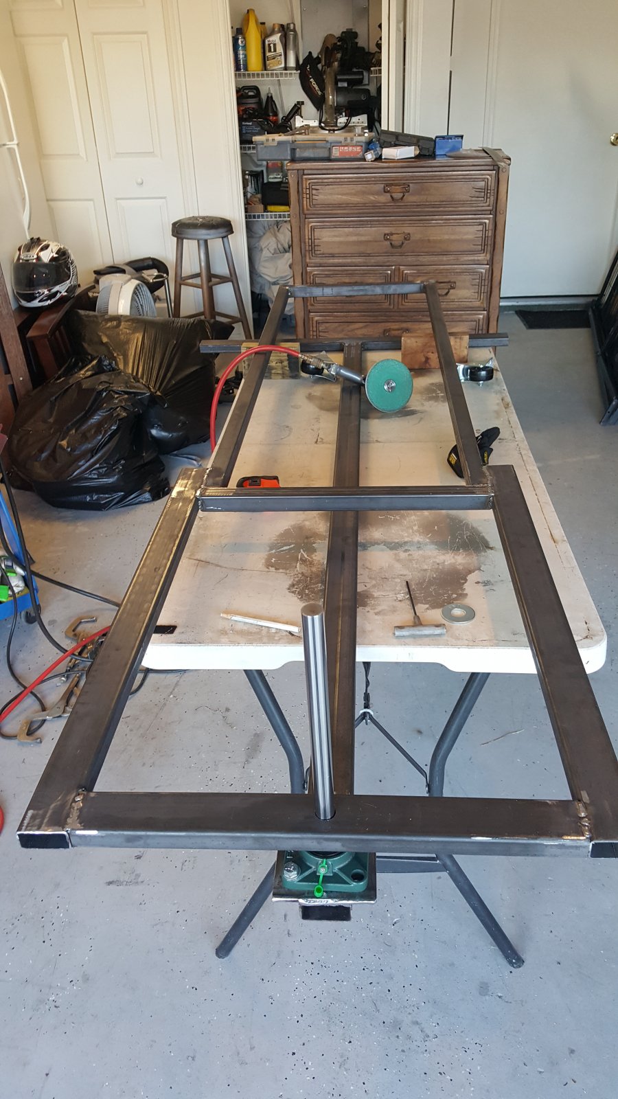

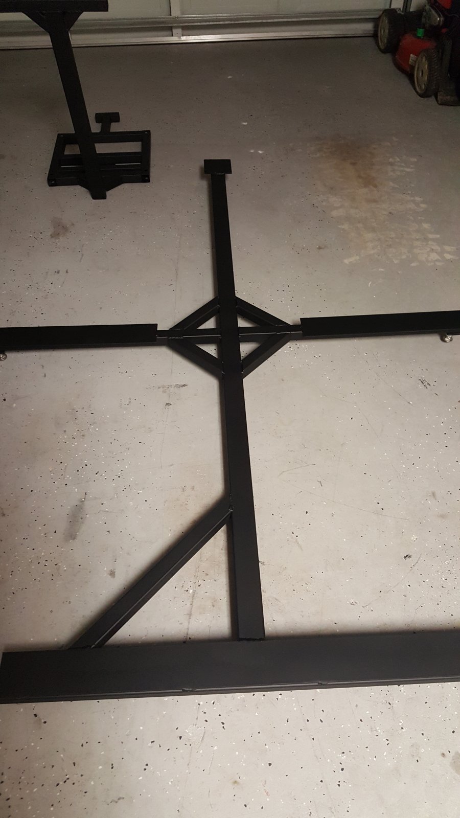

  13. Brett Horton
    Aug 18, 2016
    310
    Tampa FL
    118Coins
    +202 / 2 / -0

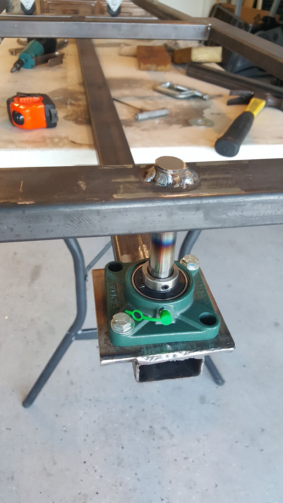

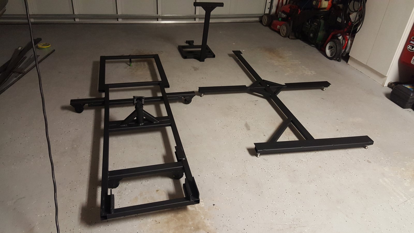

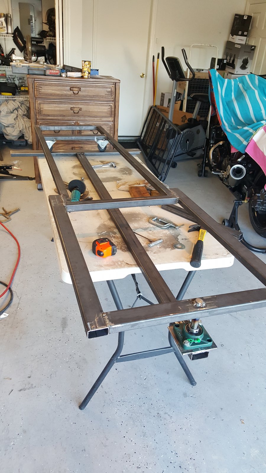

    Great progress today!
    Mechanical almost done, Rig painted, starting electronics final installation tomorrow...
    20161112_101152.jpg 20161112_101201.jpg 20161112_193124.jpg 20161112_193134.jpg 20161112_193141.jpg

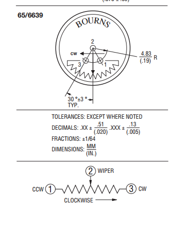

    could be 1 negative 3 positive and 2 feedback
    or 1 positive 3 negative and 2 feedback.
    wiper is alwawys your feedback line
    pic is from datashheet
  19. Brett Horton
    Aug 18, 2016
    310
    Tampa FL
    118Coins
    +202 / 2 / -0
    "could be", does not matter ? Sorry not really familiar with pots
