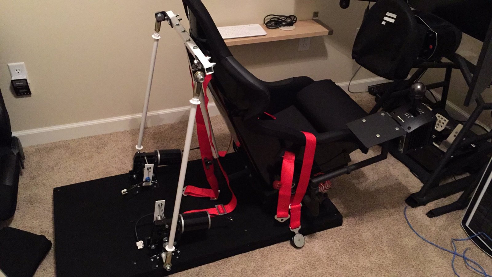

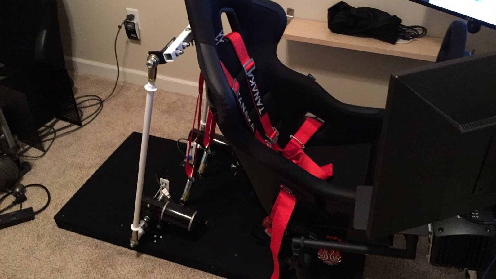

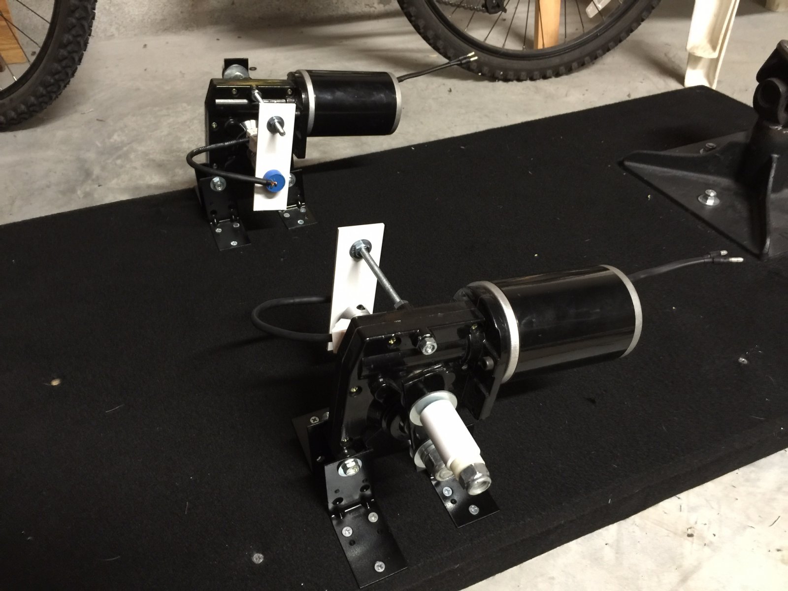

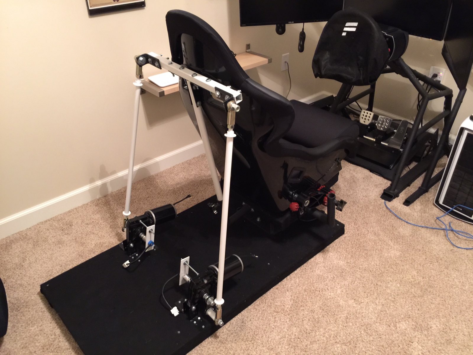

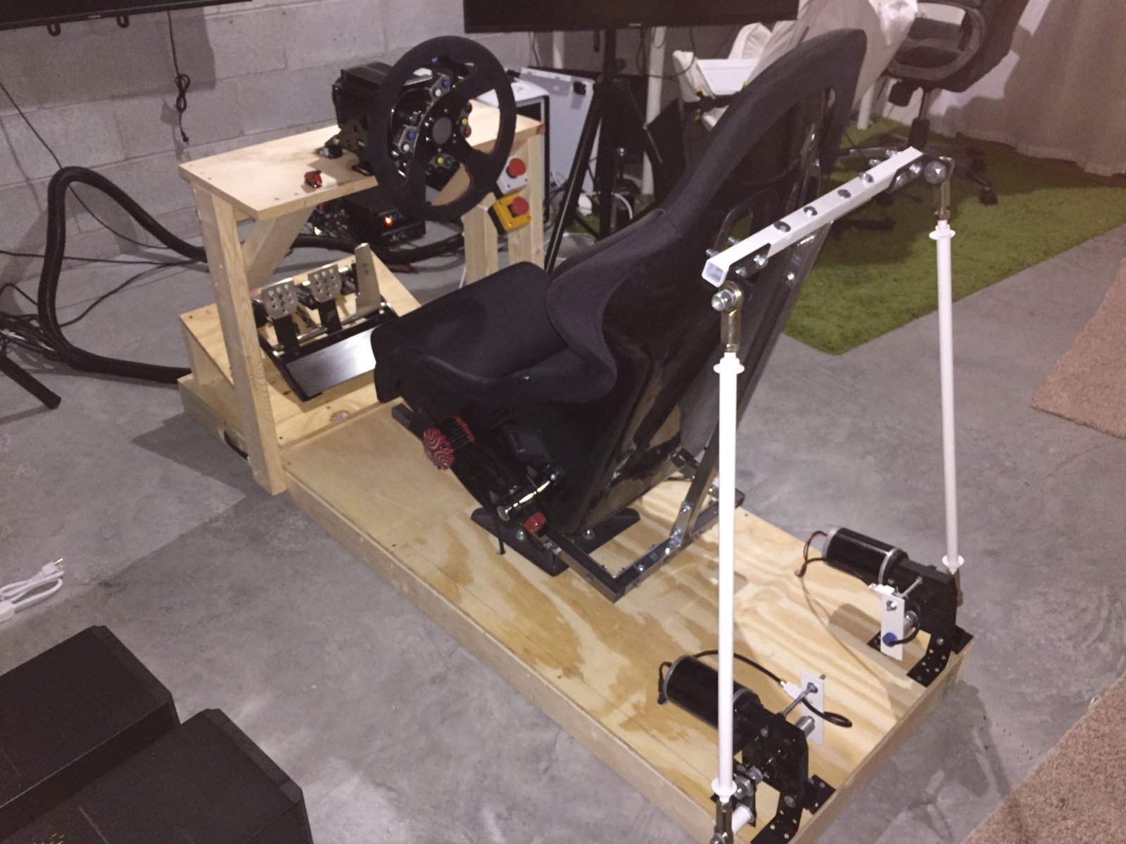

    so another small not so informative update. Havent posted pictures of the rig since i painted everything and cleaned it up more and added seatbelt. I moved it to my basement so the wiring has gone to shit again, but don't plan on redoing all of it until i get my 80/20 design ordered and built. Also are two simple shots of the OSW (which by the way is everything you can hope it to be).
    Any questions please ask id be happy to help. Will post more pictures of the OSW box once i get all the mounts designed & printed and have it looking pretty (right now its just a wirey mess)

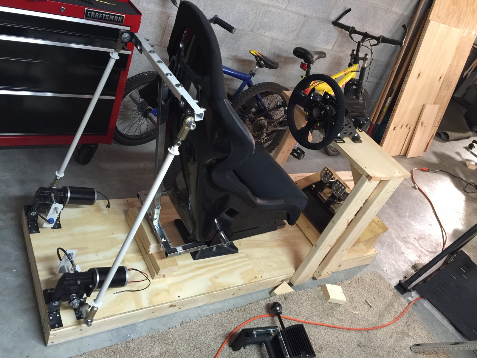

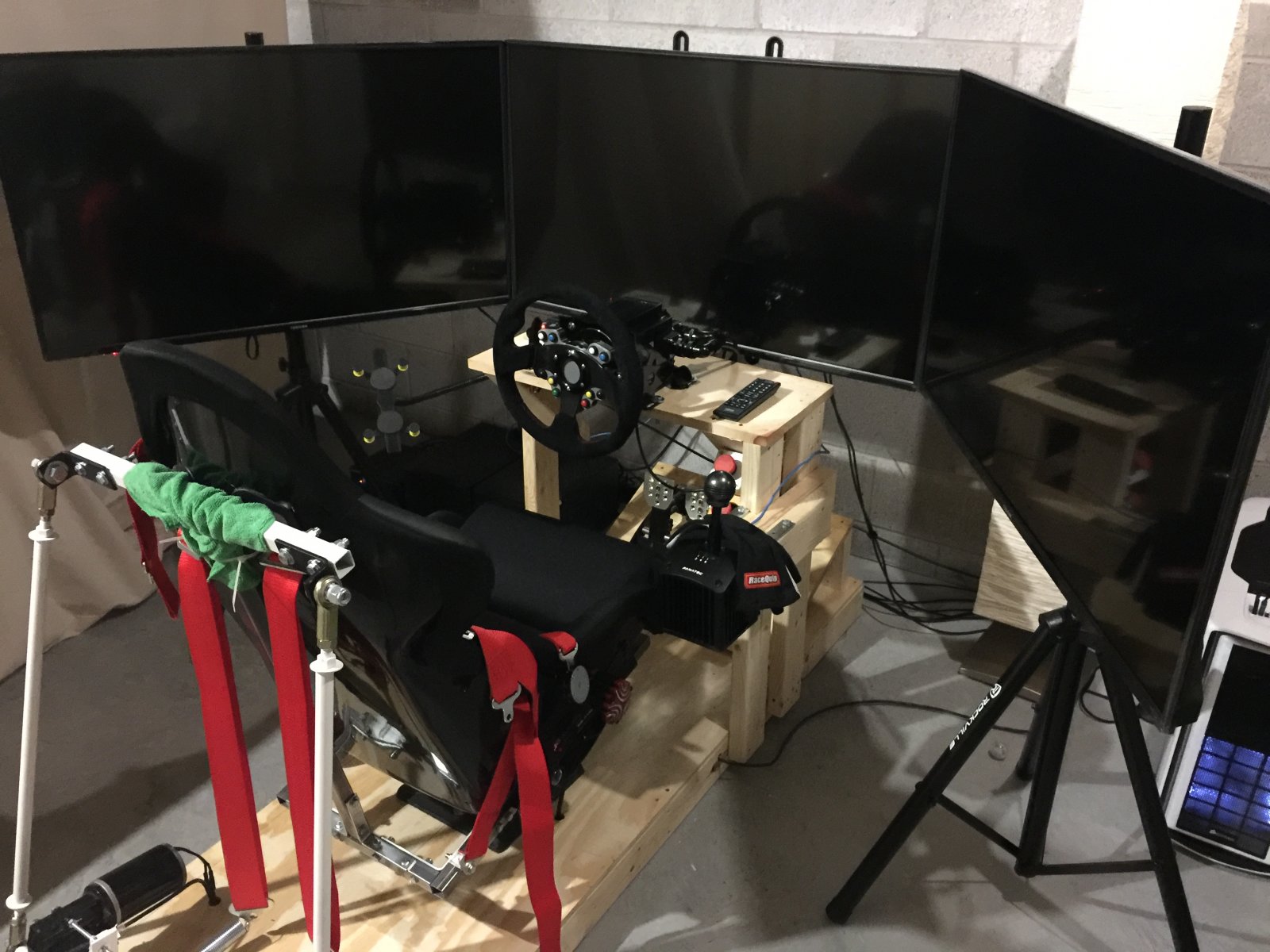

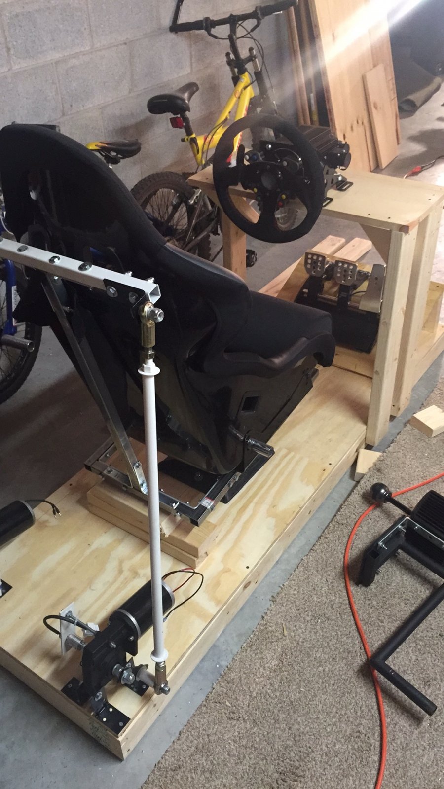

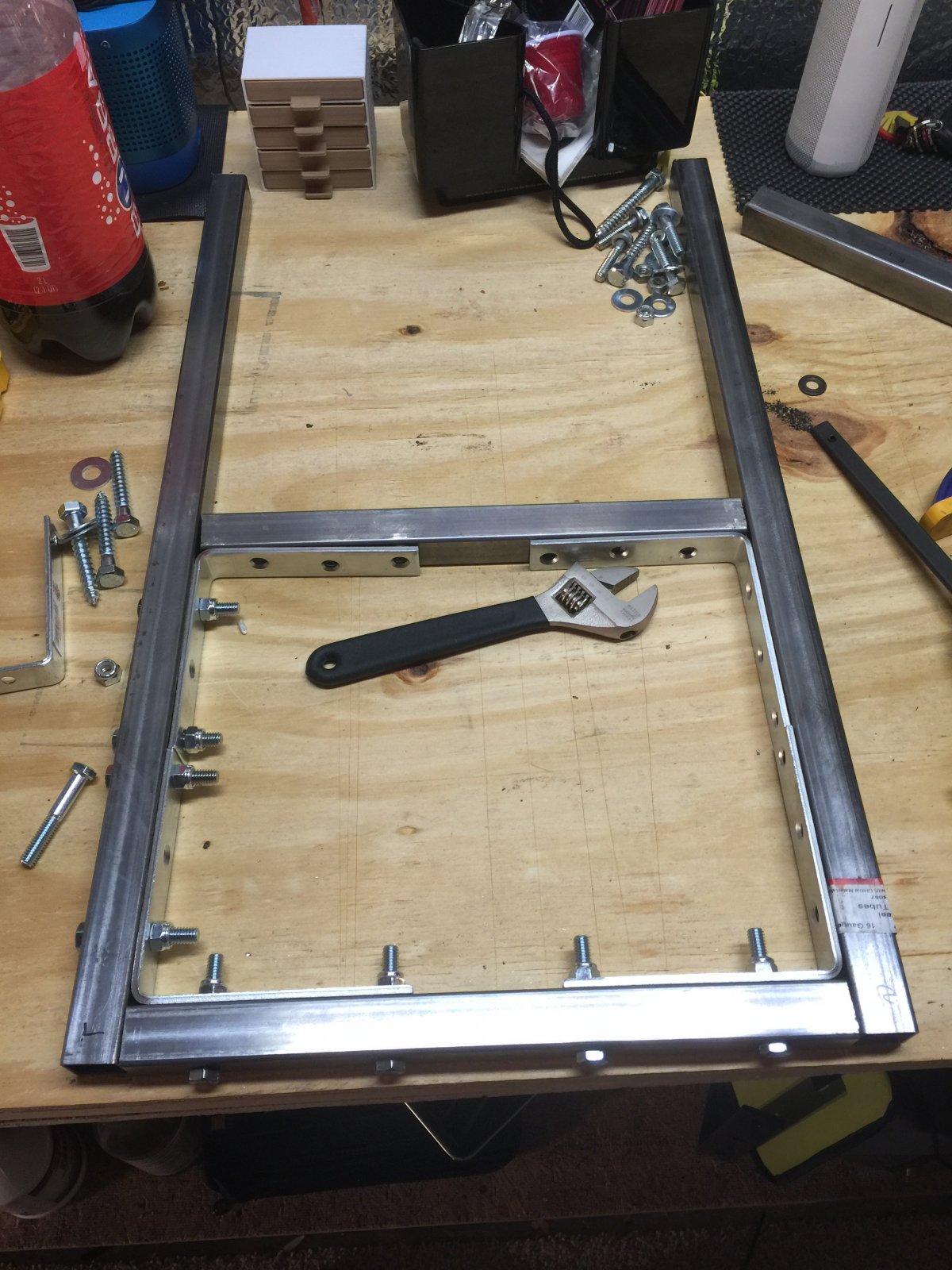

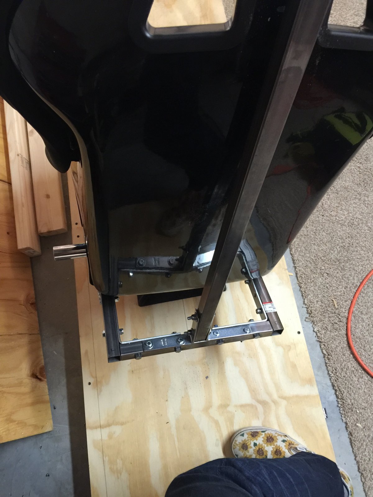

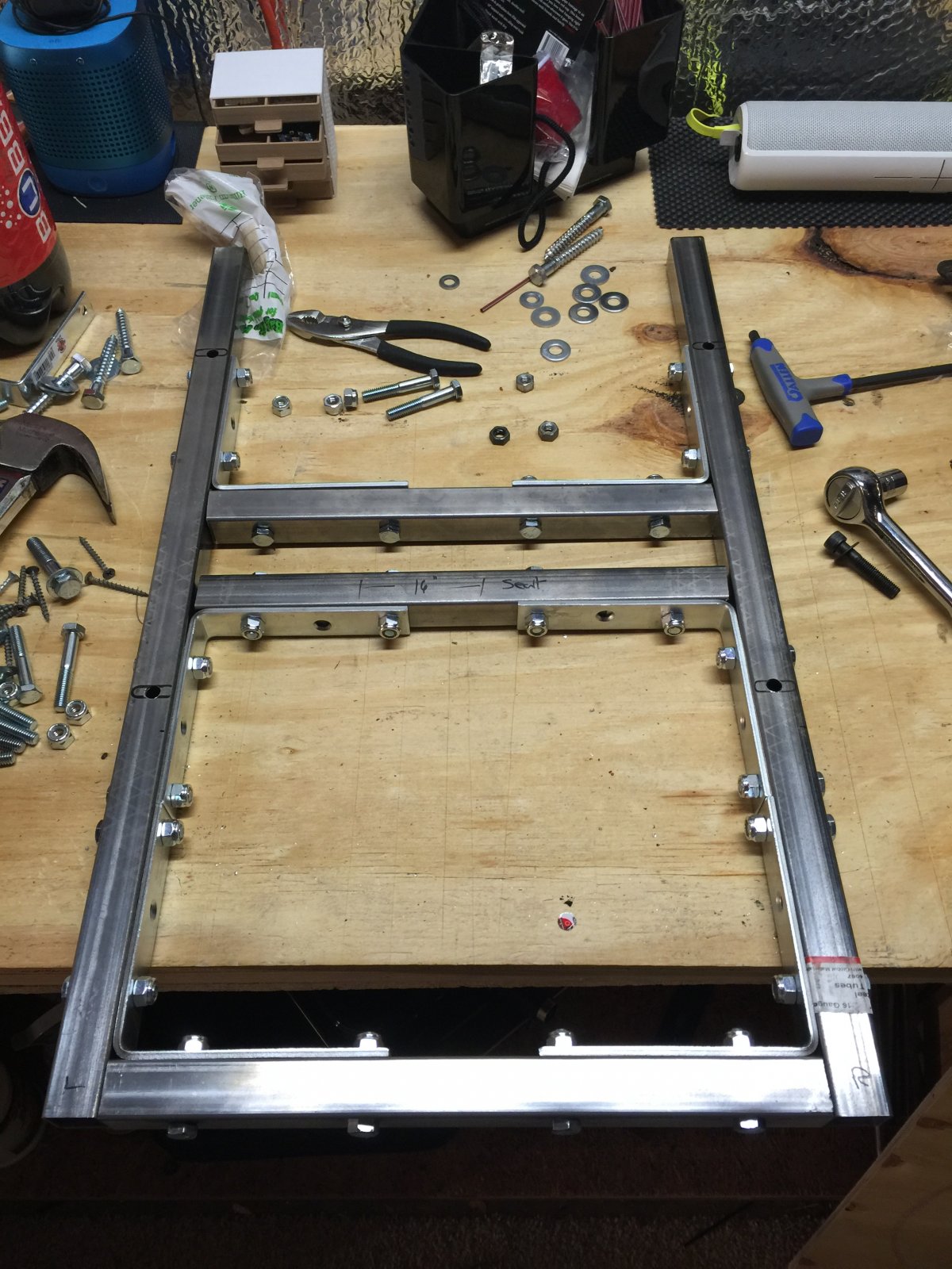

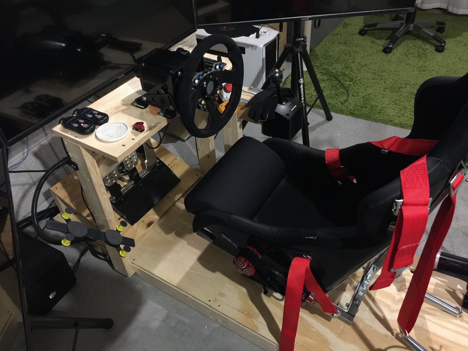

    Hey @BondeX there was 3 major reasons I changed the seat out and then a few side benefits to doing it in the process. The main reason is that after spending a little over $1k on the Revolution and only using a few bits of it i knew that id rather build an entire platform and sell the Rev to recoup some costs which would mean replacing the parts i was still currently using, 2nd when adding 3dof (still havent gotten around to doing yet) the Obutto stuff doesnt really work anymore without it looking very hacked, third i knew i wanted to add bigger screens that the triple monitor mounts couldn't support...after replacing the screens 1 month later they released the preorder for Rift CV so that could turn out to be a waste of money on them but we shall see.
    The side benefits of replacing the seat are one its much much lighter, two its much more ridged since its a solid construction seat with less points of flex/play, and three it just looks badass, however there are some cons, the cheap and easy way to monting the seat to the base and the back rail became much more difficult which i will post some of the pics of the frame i made to support the new seat properly
    Starting out modding a Obutto rig is definitely the cheaper way to go and reduces the amount of build for going motion, but as you go down the rabbit hole that is sim rigs you'll probably quickly realize you want to make your own rig entirely to make it exactly how you want but i have to say the initial build i did felt fantastic
    Attached is the current status of my rig and how i went about replacing the Obutto in a budget conscious way, no surprise i took some notes of my brothers rig and refined where i could.
    if you have any questions or need help if you decide to convert it just let me know id be happy to help

    @rundmg, first of all I would like to say that what an amazing job you have done here. While going through your thread I got so excited that I asked the question first instead of commending your work :)
    So yeah the reasons you have given definitely make sense. I have an obutto ozone and I was thinking about few options: 1) Move the whole obutto rig (3dof) without the monitors. 2) Just use the obutto seat and the base the seat is on as a seat mover.
    Now i know revolution is much more expensive so using bit sand pieces of it does not make sense but since I own an Ozone which cost me only $434, I believe if I can make use of any of its parts, it will be worth it.
    Any thoughts would be appreciated. Thanks
