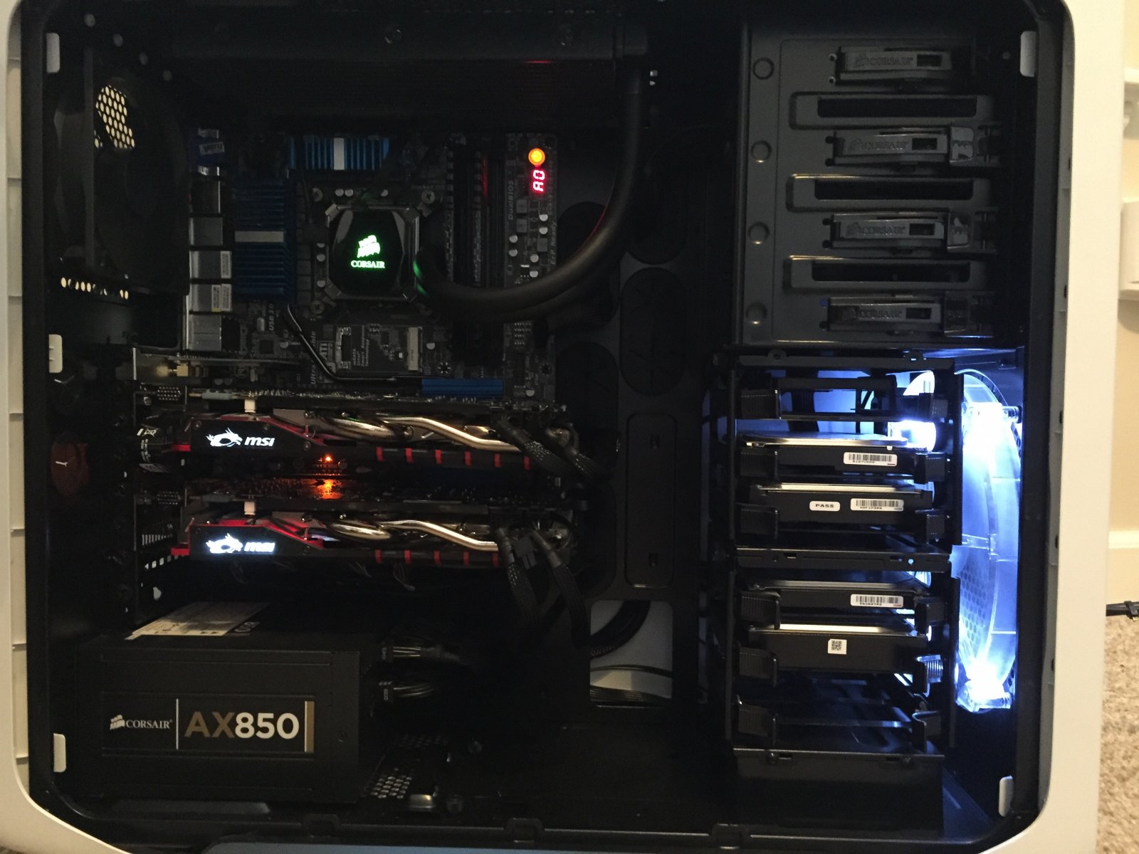

    Quick (small) update. 2dof still going strong; however, many changes are in the works for the rig. Taking everything to a metal frame and adding drift to her. Fanatec v2 base (is suppose to) ships end of this month, recently upgraded shifter to Fanatec ClubSport shifter. Also plan on redoing my box that contains the electronics as well as changing out the current PSU to either batteries with a charger or just better power supplies. Will start posting more when work begins to take shape on frame..
    oh yea ps: I recently ditched my GTX 670 with two sexy GTX 970's

    Haha we got my dad into sim racing so he is currently using it in his computer. If he upgrades to a better card I'll let you know; however, my 670 was only a 2GB card so it might hurt you more than help you when you SLI because it will only use 2gb on your 4gb card then

  18. noorbeast
    21,722
    152,045Coins
    +11,062 / 56 / -2
    Very nice @rundmg :thumbs
    I just ordered a single Gigabyte G1 GTX 970. Overclocked they will match the GTX 980. Excellent value for money.

    Oh yeah they will and then some. These overclock right aroun what the Gigabyte ones will do. Currently have mine at 1501mhz on gpu and 7410 on memory. It'll go a a little higher but I wanted to keep them super stable seeing as a crash in a long race would piss me off
