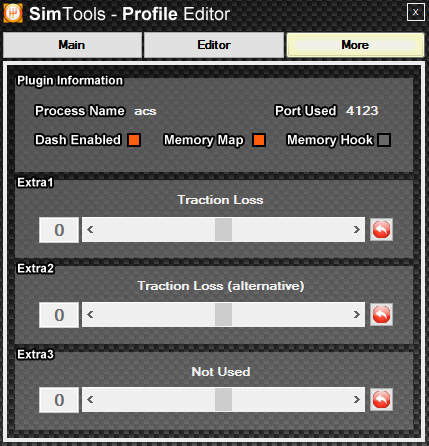

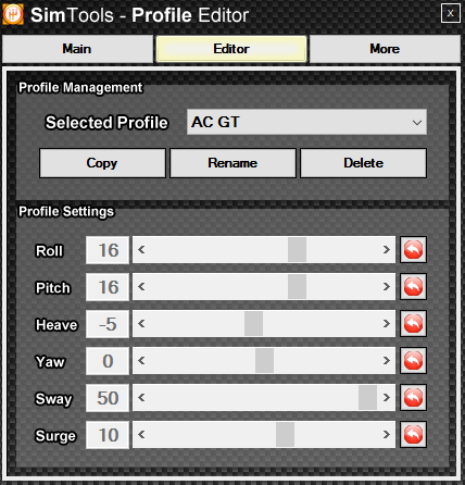

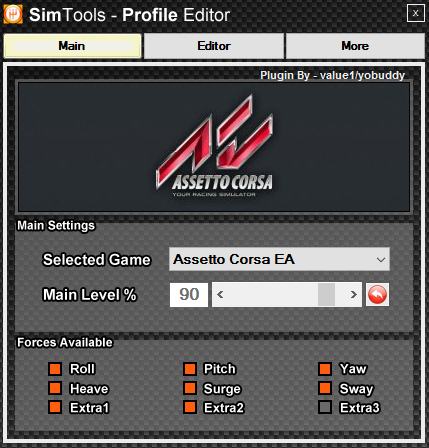

    So, as promised, this is my settings for AC with the T1000 3 motions.
    At first, Game Engine :
  12. dJuL
    dJuL yes !
    May 1, 2015
    137
    None
    9,424Coins
    +86 / 0 / -0
    3DOF, SCN6
    Game manager :
    This is my standard setting, but I have other ones, for specific cars...
    You should practice to define your own setting.
    It depends what kind of sensation you want to feel more...
    Maybe you won't like what I like and vice versa
  13. dJuL
    dJuL yes !
    May 1, 2015
    137
    None
    9,424Coins
    +86 / 0 / -0
    3DOF, SCN6
    And tunning center :
    I set value to 4 / -4 for extra 1.
    It is the way I choose to set traction loos without setting a low value in game engine to keep a good amplitude.
    Hope it can help.
    regards ;)

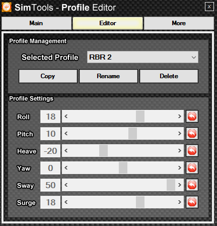

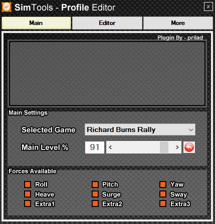

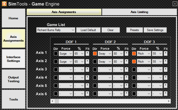

  15. dJuL
    dJuL yes !
    May 1, 2015
    137
    None
    9,424Coins
    +86 / 0 / -0
    3DOF, SCN6
    Yep no problem...
  16. dJuL
    dJuL yes !
    May 1, 2015
    137
    None
    9,424Coins
    +86 / 0 / -0
    3DOF, SCN6
    Game Engine :
  17. dJuL
    dJuL yes !
    May 1, 2015
    137
    None
    9,424Coins
    +86 / 0 / -0
    3DOF, SCN6
    Game manager :
    You will see it is a "strong" setting.
    I love that personally :D
  18. noorbeast
