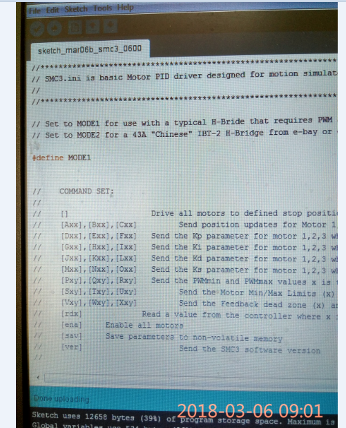

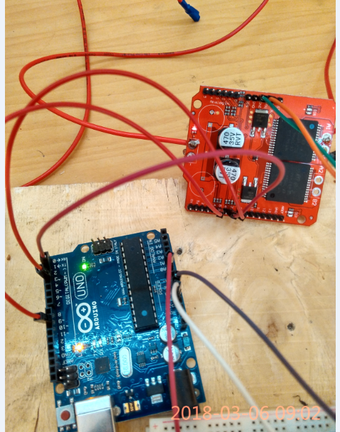

    I have Dirt Rally to inteface with Simtools for 2 dof of seat play. But I am getting problem as expressed :
    1. My motor is moving forward and reverse in IBT2 driver.
    2. Bu it is running only one direction while interfacing with MM shield. I have edited the code by (#MODE1) and also followed the forum of x simulator but the problem remains same. I have checked pin connections as per your suggestions in the forum.
    My pin connections as:
    Arduino>> MM Shield
    2 >> 7
    3>> 8
    9>> 5
    4>> 4
    10>>6
    5>> 9
    Currently I am using one motor to check its performance. Once it works, I will connect second motor too.
    Kindly help me.

    what code are you using?

    SMC3.ino and editing the top of its code by # MODE1.

    be sure pot scaling has not been turned on without a pot connected to the arduino in the scaling configuration. smc3 does not need editing if you are using mode 1.
    EDIT you should be testing initial movement under output testing

    you may have a faulty monster moto
    include screenshots of your settings and photos of your wiring etc

    include screenshots of your settings and photos of your wiring etc[/QUOTE]
    Thanks Stephen. I changed the MM driver and now it is giving some response in reverse direction. But the response is slow as compare to forward direction. Please find the screenshot of pin connection and SMC3 utl. PLease suggest me to make the response as of forward direction.

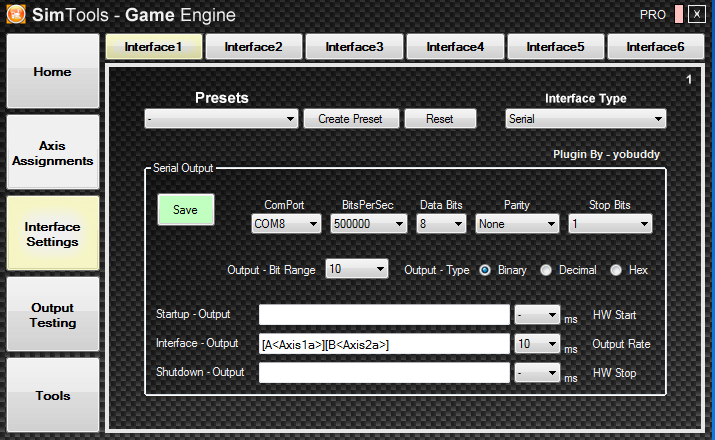

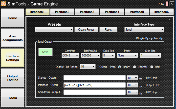

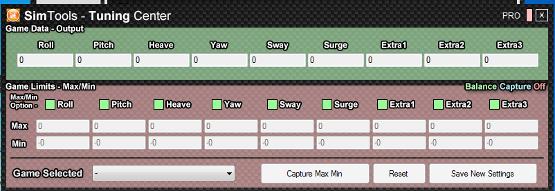

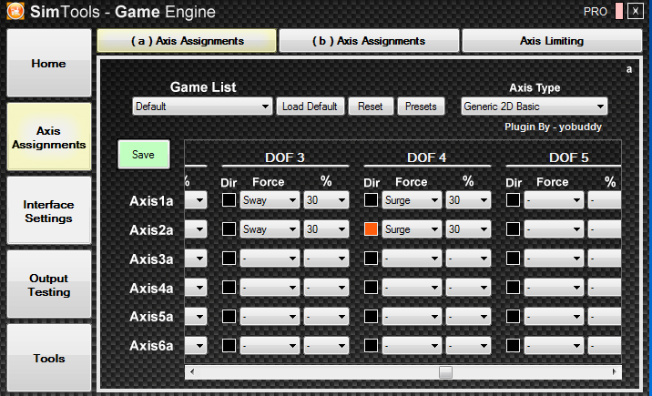

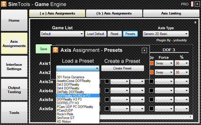

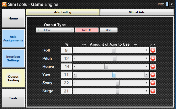

    I have connected motors with IBT2 driver and tested with smc3 and hand potentiometer operation, it is working fine. Now I started testing with game engine without running the dirt rally game, my both motors are not working. please help me.
    The setting of game engine as follows. I also tried with different % setting of roll and pitch, it doesn't work. I tried with dirt rally DOF Reality and again, it does not work.
    21,514
    150,704Coins
    +11,018 / 55 / -2
    Instead of axis defined like this <Axis1> it now has designate grouping for a or b in SimTools 2 for each axis assignment, like this <Axis1a>

    Startup and shutdown output should be 0 also. You may have better results with surge and sway instead of pitch and roll.

    Yes I also tried with <Axis1a> <Axis2a> and also kept surge and sway from 0 to 100% but no response in the motors.
    Is there any other reason?
    21,514
    150,704Coins
    +11,018 / 55 / -2
    Please post pictures of your Axis Allocations.
    Does the Sim respond and move in Output Testings?
    If so then the issue is on the game patching side.
    If not then the issue is on the hardware/interface side.

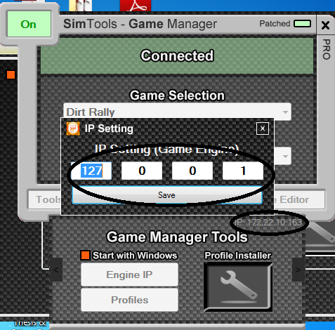

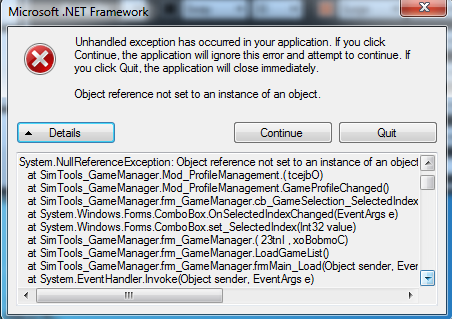

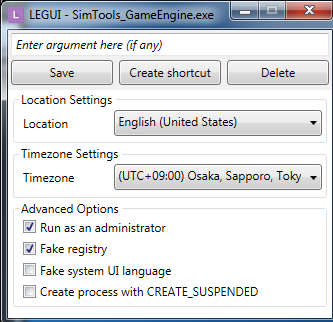

    Yeah game engine is responding. Also I am getting .net error this may be the reason not to get response.
    What kind of hardware/interfacing problem it may have? please explain me.
    please find the screen shots as :

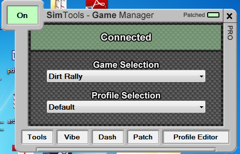

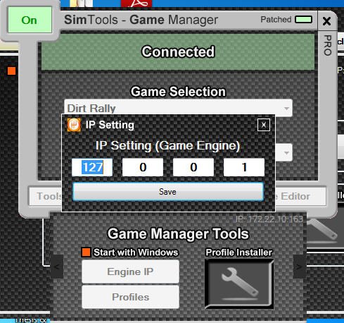

    Pls. find the screenshot of game manger as:
  18. yobuddy
    5,384
    50,383Coins
    +5,154 / 18 / -0
    Are you running version 2.2.5?

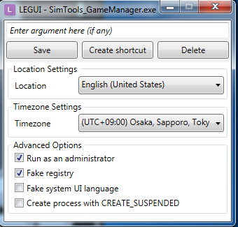

    current version is V2.0.0.2
    The language is English. Still not working. Is there any other area to check?
  20. noorbeast
    21,514
    150,704Coins
    +11,018 / 55 / -2
    I am not sure if a language emulator works or not, to be sure change your actual system setting to English Local.
    Can you confirm previous issues with SMC3 have been resolves and that motors respond properly there.
    When do you get the .NET error message?
    Can you please post the full details of the .NET error message.
