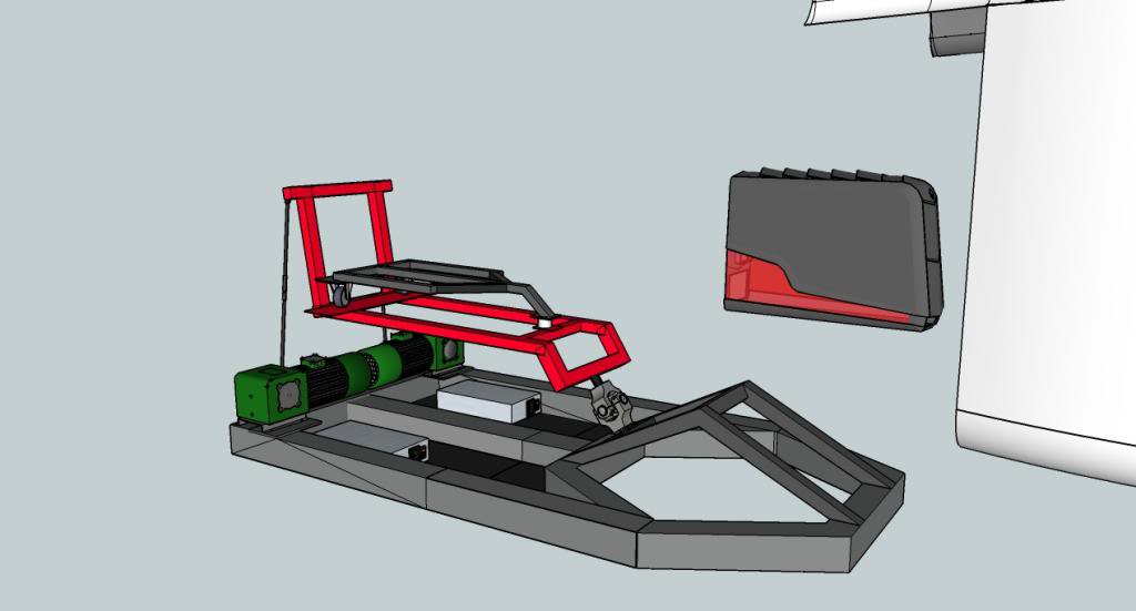

    So here's where I'm headed,
    Thanks @SeatTime for the rec' on the worm-gear motors. Thats the route I will be taking.
    @bsft, I've currently been drafting designs with the linkage connected at a lower distance and closer together, as I though it would create a more desirable motion. Do you think the mass of the cockpit with them in this position put too much strain on the motors?
    Thanks to @Historiker for his expertise on appropriate Power Supplies per axis of motion.
    Moving slowly on this and may not get too much of a start on it until June, but here's what I've been thinking. The traction loss axis is either going to get rethought with a different approach, or be made twice as wide to handle the off balance weight the rig will get.
    [​IMG][​IMG]
    [​IMG][​IMG]

    Oh that diagram tells a different story. Recommend the following: Arms should be driving at the top of the seat as advised by bsft. With that design the seatmover may be difficult to balance. Traction loss should be under the seatmover and motors to remove weight off the seatmover. I chain drove my traction loss to move the added weight (also had a surge table which it had to move) as it does not need to be as reactive as the seatmover. This is mine - a picture tells a thousand words. http://www.xsimulator.net/community/threads/seattimes-dc-motor-sim.5024/

    Uni needs to be under best balance point, where you have it in the diagram is wrong.

    Having the joint at the front will cause a hell of a lot of weight on the motors. They'd need to be huge to support the weight and movement. I don't know if this is the case but having the pivot that far forward may well feel quite strange and could contribute to motion sickness as well.
    I'm working on a frame design at the minute as well. My traction loss wheels will basically be an inch off the ground under the motors.
