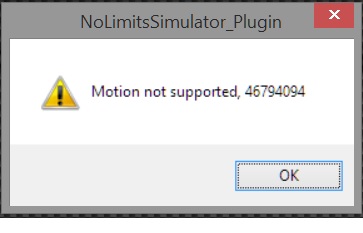

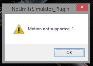

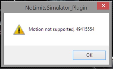

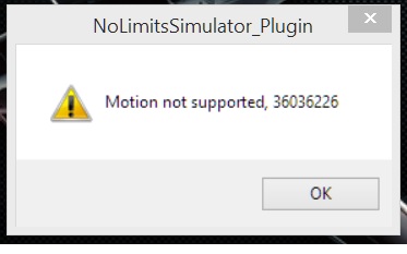

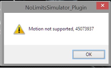

    The numbers keep changing.
    The strange thing is when I kept restarting NLR2 to capture the sequence of numbers in the pictures below it worked on the 5th go and I had motion, then it stopped again when I closed then reopened NLR2 again.
    The worst type of bug, an inconsistent one!

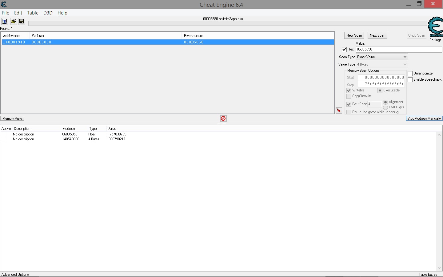

    What concerns me though is that these numbers are exactly the numbers that are used by the plugin.
    Does it help if you run the GameManager in Admin mode?

    Yes @value1 I do get the same error if I run Game Manager in Admin mode.

    I had another bash at totally removing then reinstalling the NL2 plugin but still get the motion not supported message, any ideas @value1 and would it help if I ran through the Cheat Engine steps again?
