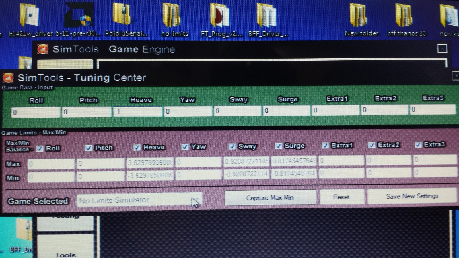

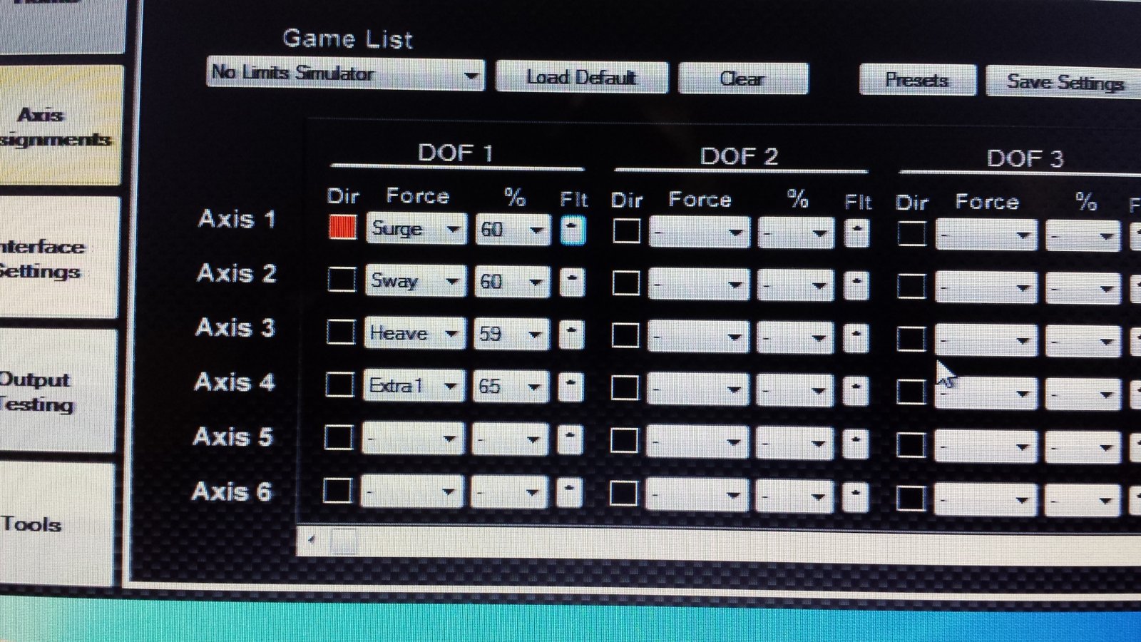

    So I've been playing around with NL2 and well its hard to get some movement . I get some shaking and back and forth but not so happy so far. I know I have the AMC 1280 set up because in FSX with Ians BFF software I can get the simulator to stand on its head . Now for the life of me I cant find the "Tuning center"? My heave doesn't seem to make any.
    from what I have read there is no such thing as pitch or roll in NL2. That's what I need to make this thing feel real. Side to side is better than nothing but Pitch not going to happen or is there something a person could do. Attached is my setting in the interface and axis. any suggestions I'm all ears! Anybody else using Thanos MAC1280 ? 20141122_173043.jpg 20141122_175301.jpg

    @iamcanadian2
    Please show a screenshot of your Tuning Centre.
    (Right-click on the GameEngine icon in the system tray and select Tuning Centre)

  4. iamcanadian2
    iamcanadian2 Member
    Oct 7, 2008
    68
    floating docks
    surrey bc canada
    90Coins
    +44 / 0 / -0
    Motion platform, 6DOF

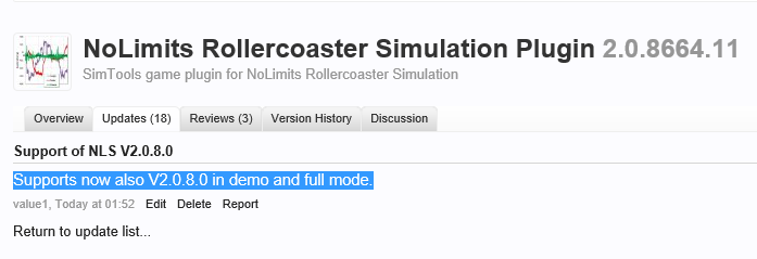

  14. value1
    Jan 9, 2011
    2,192
    Zug, Switzerland
    14,267Coins
    +3,361 / 13 / -1
  15. SilentChill
    2,645
    20,602Coins
    +3,570 / 34 / -0
    @value1 wow that was quick thanks !! yes it picks it up now ..........but then the dreaded pop up window "Motion not Supported"

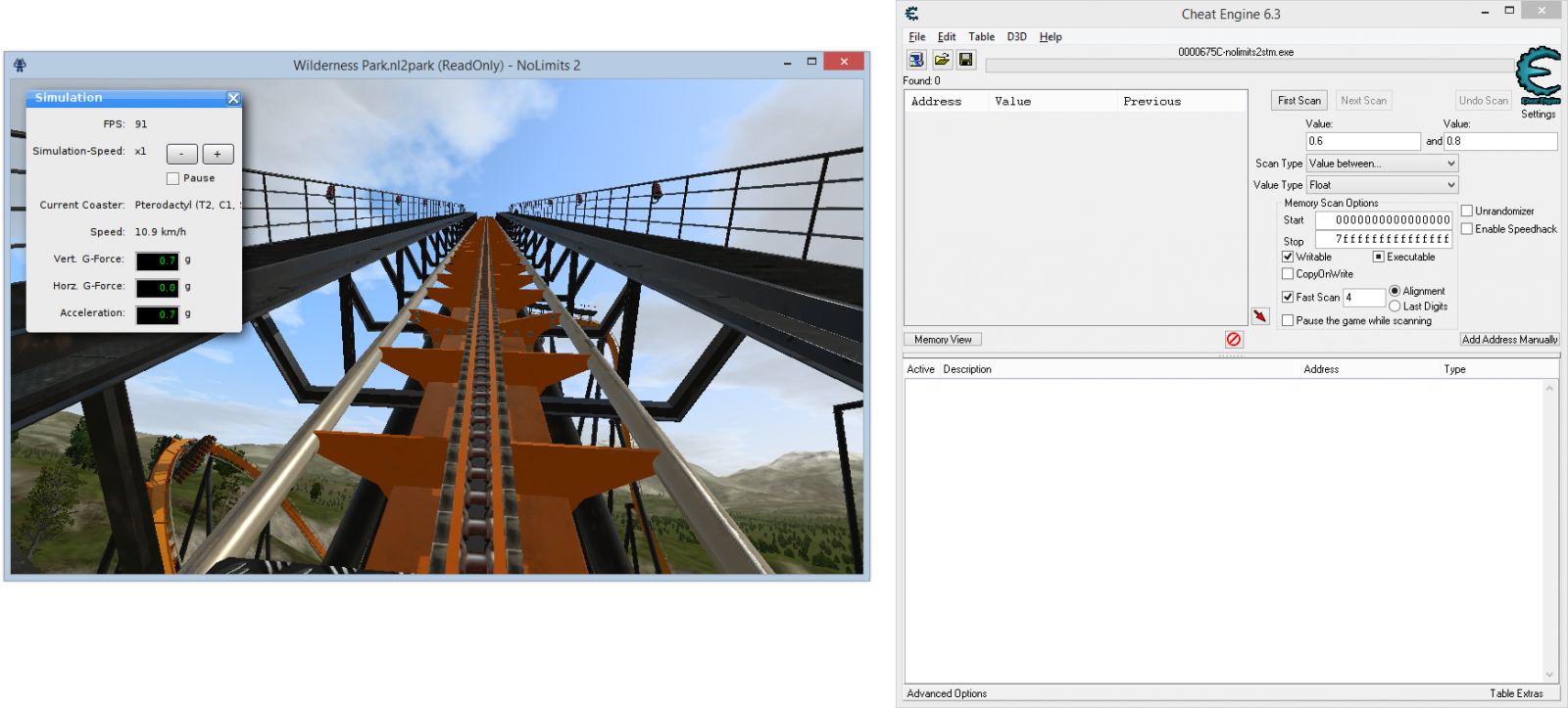

    So this is how you can find the g-forces in NoLimits:

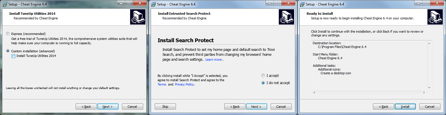

    Download and install CheatEngine.
    Don't select just "Express" installation but choose wisely! ;)

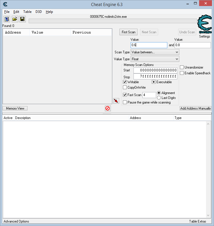

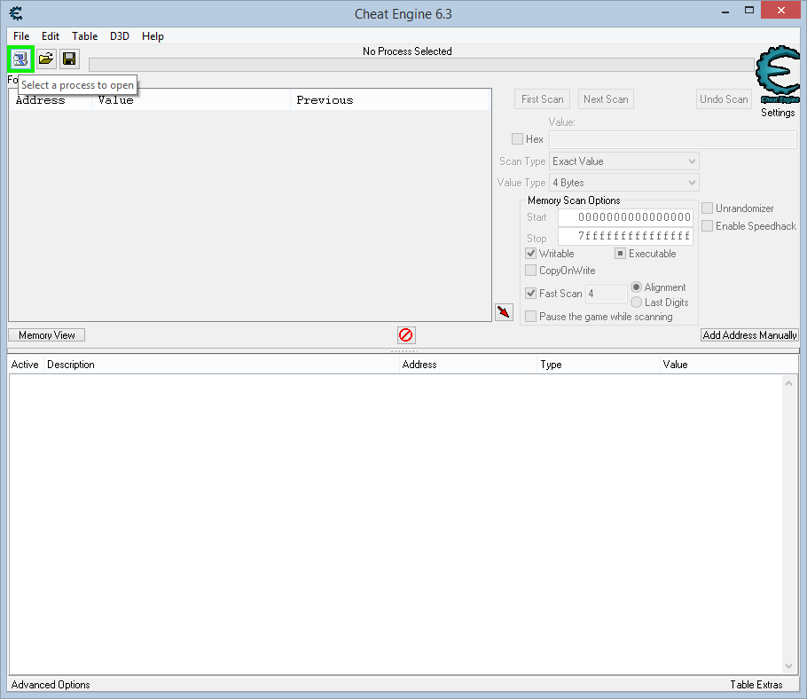

    Start CheatEngine
    Start NoLimits 2 Roller Coaster Simulation in Steam
    Switch back to CheatEngine and click on the Select a process to open button

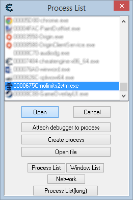

    This opens the Process List window where you select nolimits2stm.exe and click the Open button which closes the window ;)
    In CheatEngine under Value Type select Float, under Scan Type select Value between…
    Enter the values 0.6 and 0.8 in the Value boxes
    Switch back to NoLimits 2 Roller Coaster Simulation
    On the start screen click on Setup.

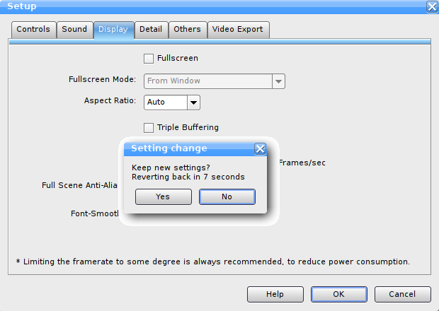

    In the Display tab uncheck the Fullscreen box, click on OK and confirm
    Start now the simulation with Play and select the "Wildernes Park" and click OK.

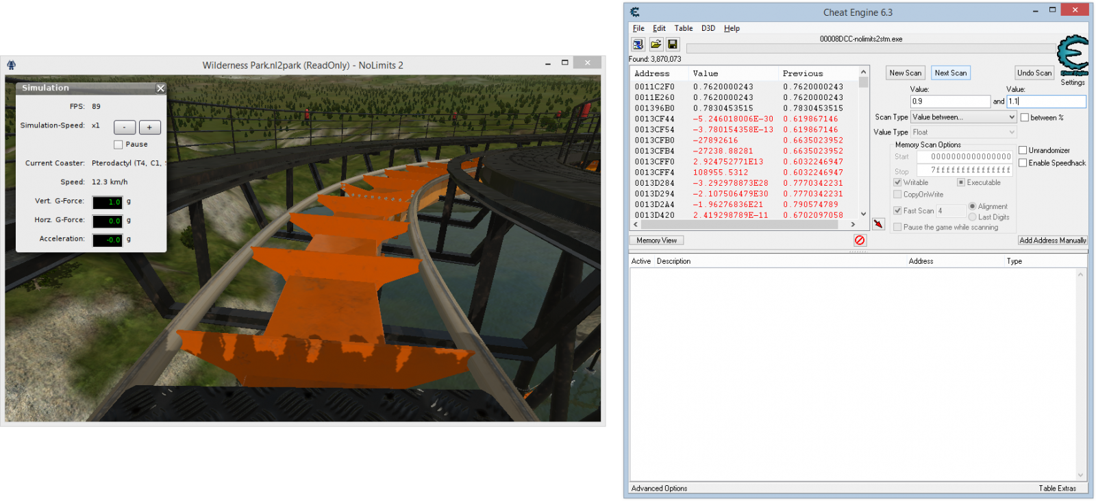

    Once the simulation has loaded, press F2 to show the simulation window.
    Wait until the coaster is in the lift area and the Vert. G-Force shows 0.7
    Click on First Scan and then a few times (10×) on Next Scan.

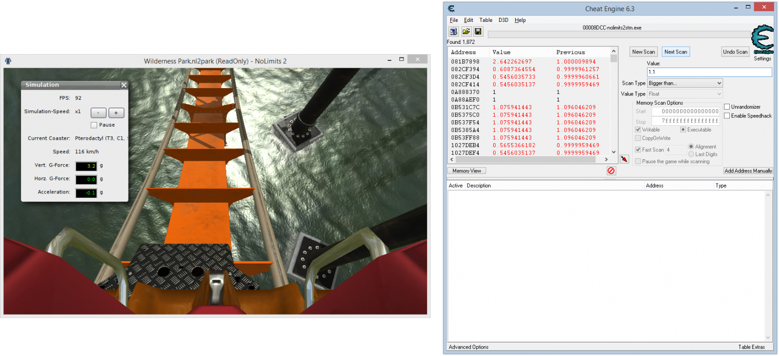

    Change then the search values from 0.6 - 0.8 to 0.9 - 1.1 and wait until the coaster is on the peak and the Vert. G-Force shows 1.0
    Click on the Next Scan button a few times (10×) again.

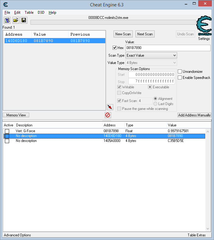

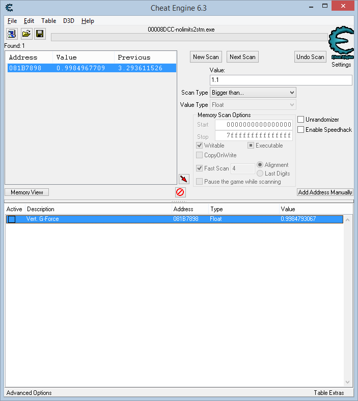

    When the coaster approaches the edge, change the Scan Type to Bigger than… and type in the value field 1.1
    When the coaster descends, the Vert. G-Force will quickly reach values well above 1.1 g. When you see such values in the simulation window, click on Next Scan.
    Should there be more than 1 single remaining addresses, click on Next Scan again when the Vert. G-Force is well above 1.1.
    Now double-click on this address to add it to the observation window of CheatEngine.

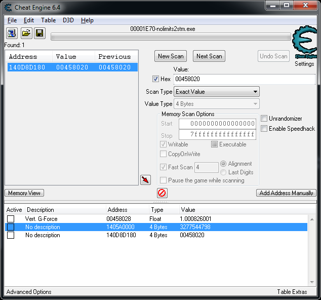

    Press New Scan and select Value Type 4 Bytes, Scan Type to Exact Value, check the Hex box and enter the address you found into the value box. Replace the last "8" with a "0" and click First Scan.
    There will be one green address in the Address window. Click on the Add Address Manually button and add the address 1405A0000.
    Take a screenshot and post it here.

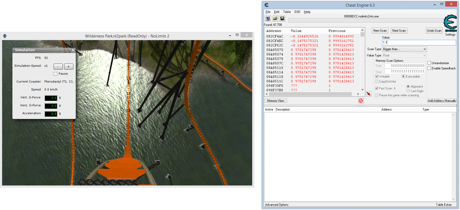

  20. SilentChill
    2,645
    20,602Coins
    +3,570 / 34 / -0
    Hopefully I have done it correctly :) Looks like same address to me ?
    Thanks again for your time and help @value1
