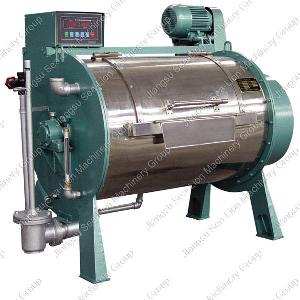

    Ever seen those industrial washing machines? :cheers
