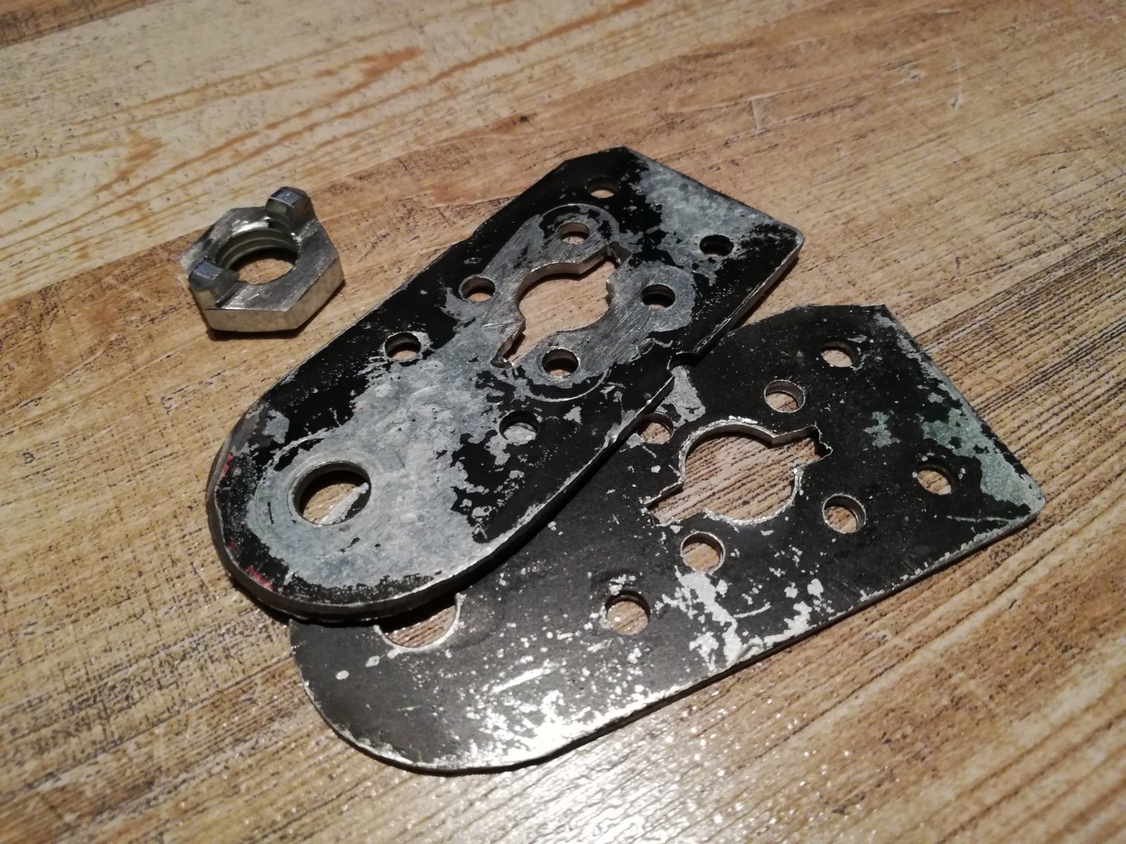

    If you are like me and can't weld and have no resources to have the levers welded than you can try this method:

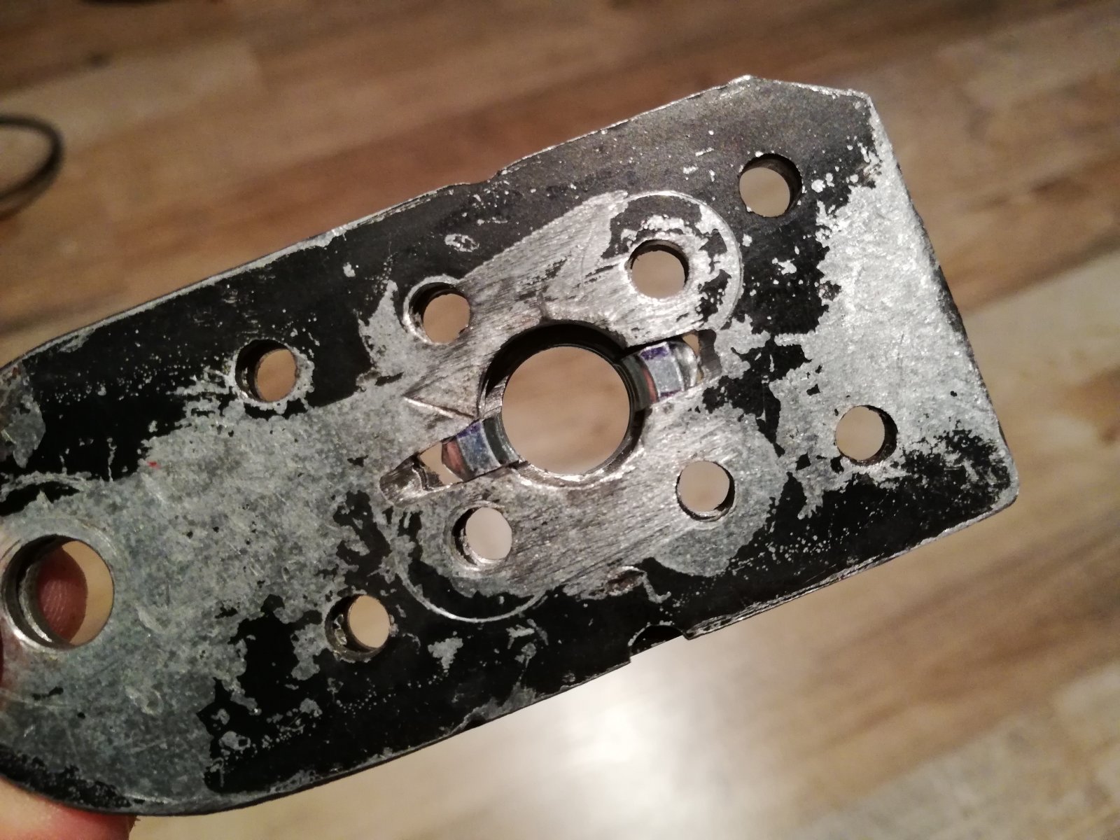

    Basically it's a keyhole principle:
    I used some standard steel plates you can buy everywhere and cutted them to shape with my dremel.
    You need two per side as the 2mm are to thin and might bend under weight.

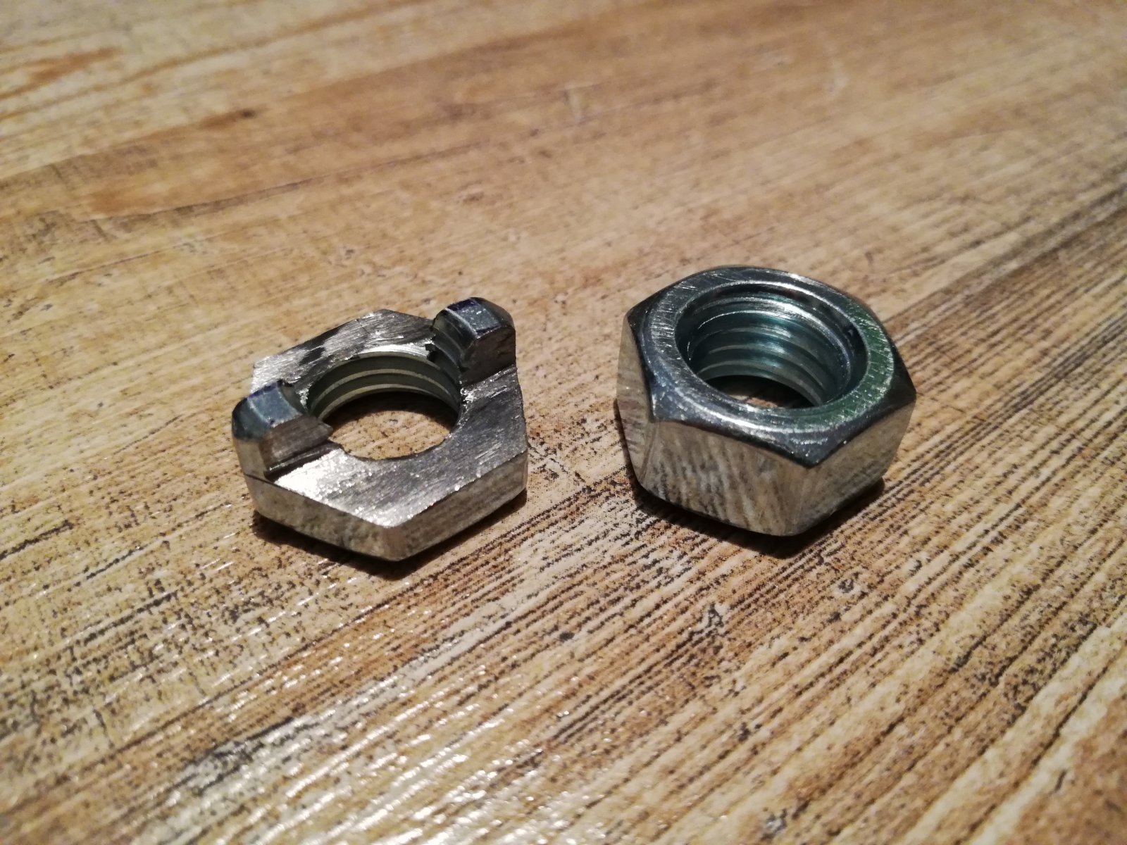

    The idea is to cut some kind of tooth into the nut so it holds your lever:
    Be aware you have to make it a tight fit between the positive and the negative shapes to prevent it from wiggling.

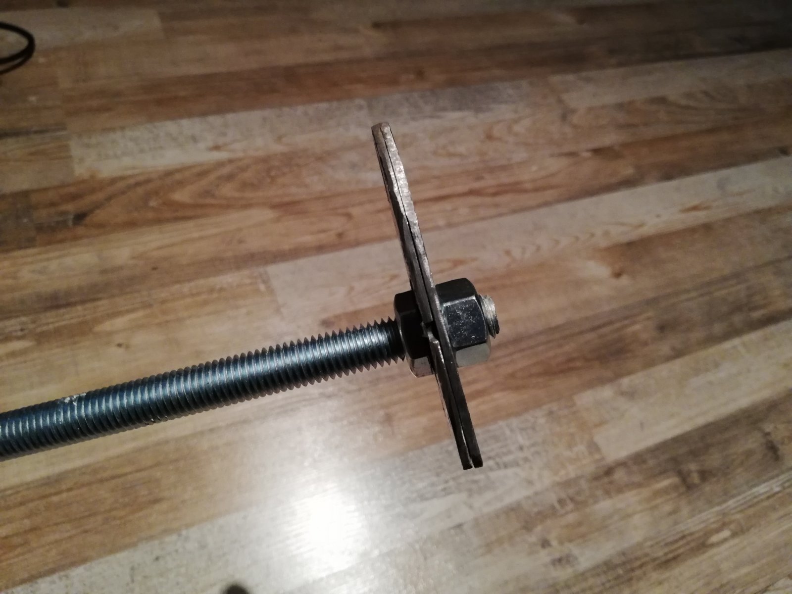

    I had to hammer it in place and it is rock solid:
    To be on the save side you should also strengthen it with 2 components adhesive.
    Better be save than sorry!

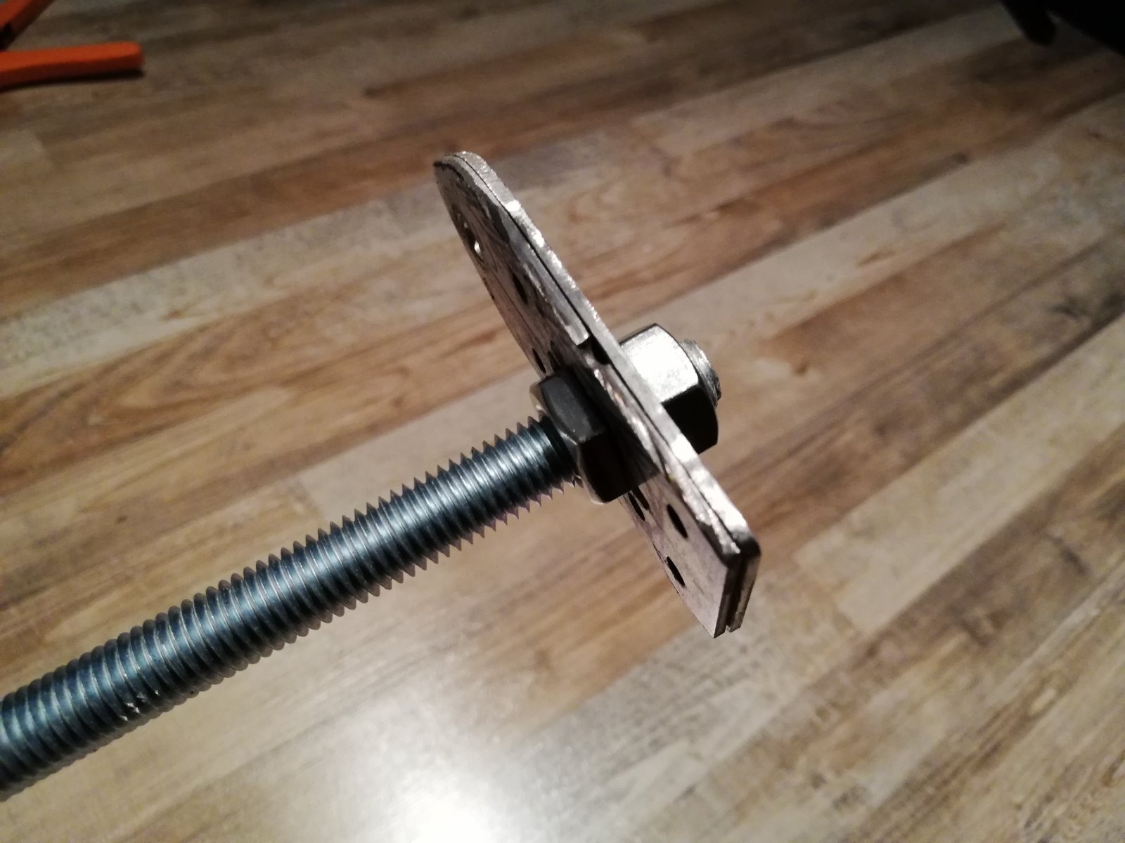

    You can then counter it with another (self-locking) nut and there you go!
    Your finished lever looks like this:
