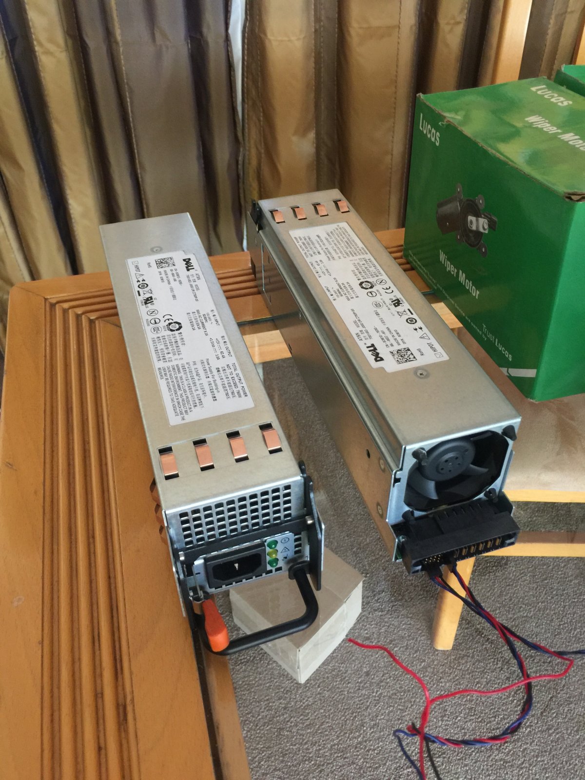

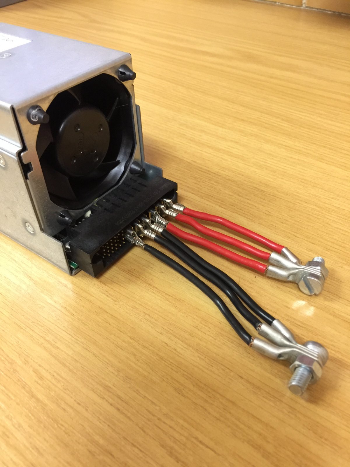

    Dell Server Power-supplies 750 Watts each, got 2 for R550 each (Around $40 a piece), Should be able to manage with just one as they are rated for 62 Amps, but its nice to have a spare.
    Modular power connectors for the power supplies: (They have since been heat shrunked and cleaned up.

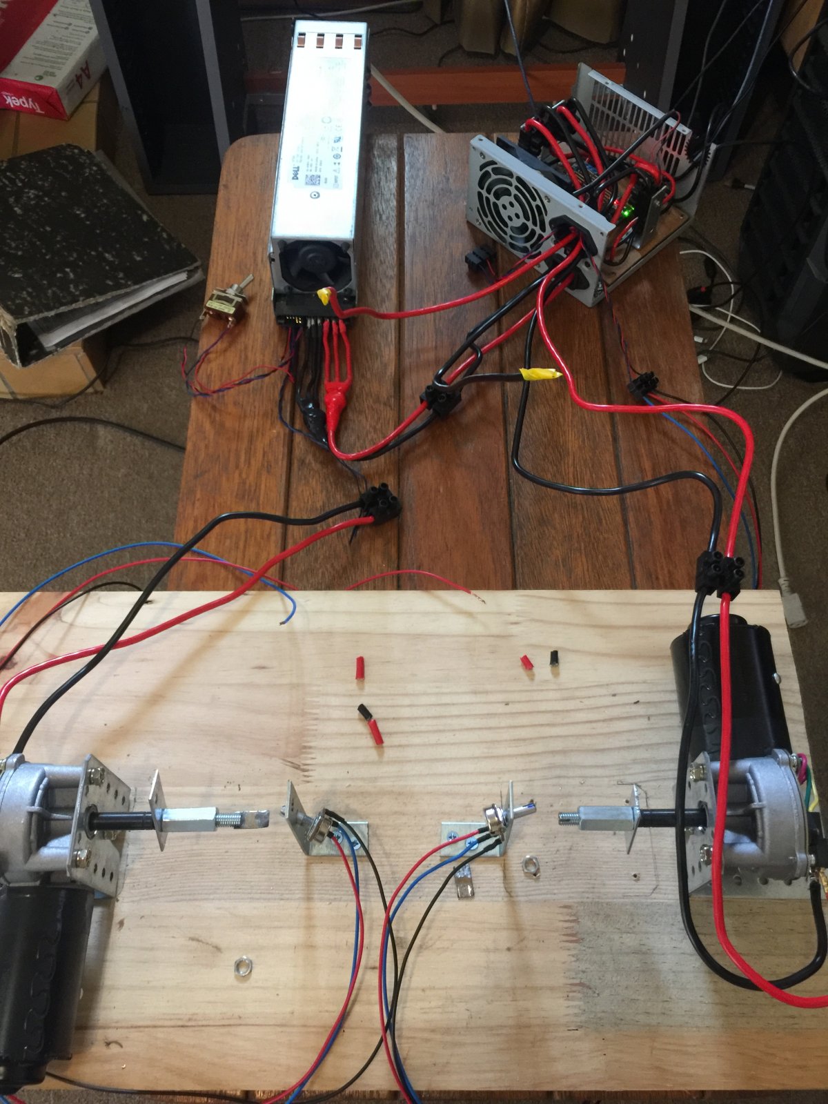

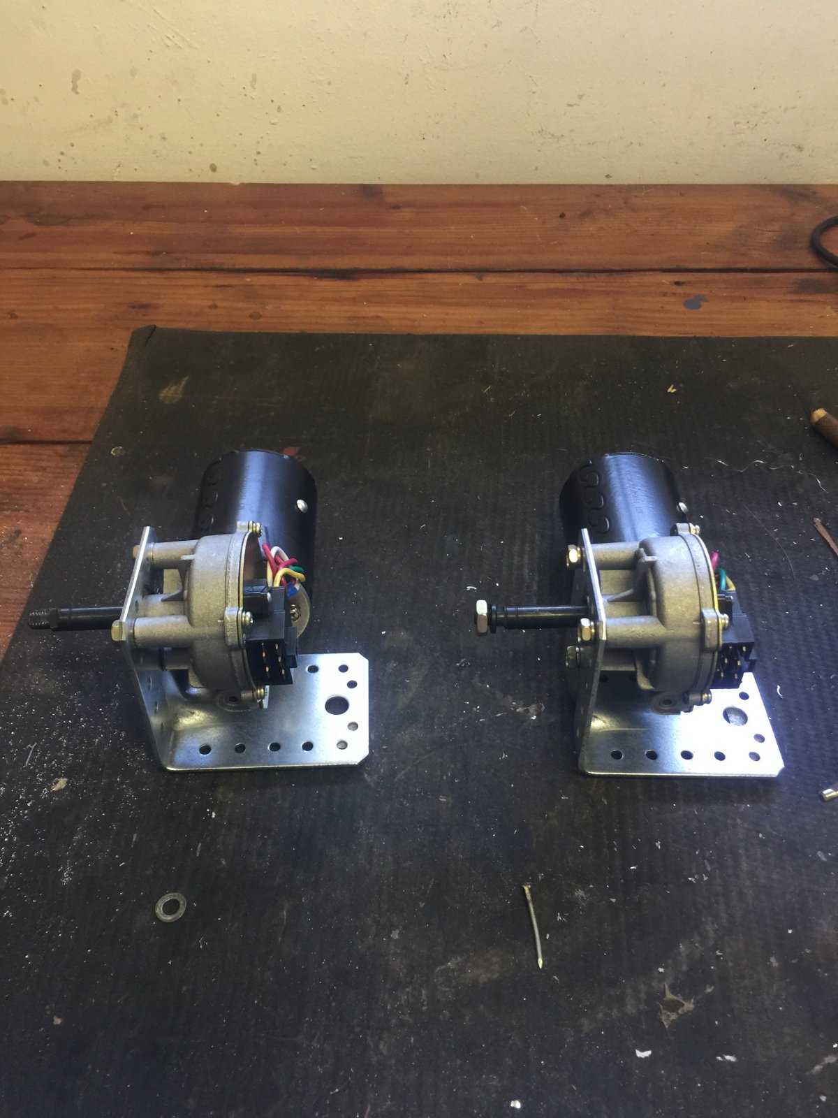

    Windscreen Motors attached to their test mounts, was waiting for bigger brackets to be in stock so I am using these small ones to setup everything and test my wiring is working, will move to bigger ones soon. As with these ones I cannot mount the second motor inverted.
    Windscreen wipers are from a Mitsubishi 300 Series Light truck (AKA Bakkie in South Africa).

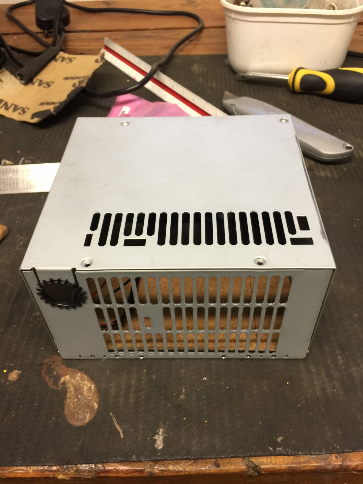

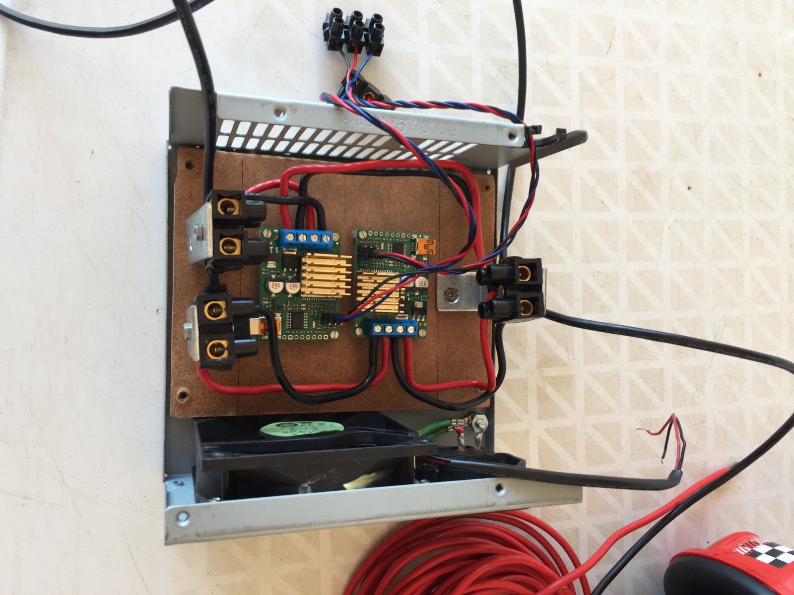

    Using an old PC Powersupply case to store all the electrical bits, idea borrowed from @RacingMat :)
    I also made a little chip board plank to fit inside to bolt everything to.

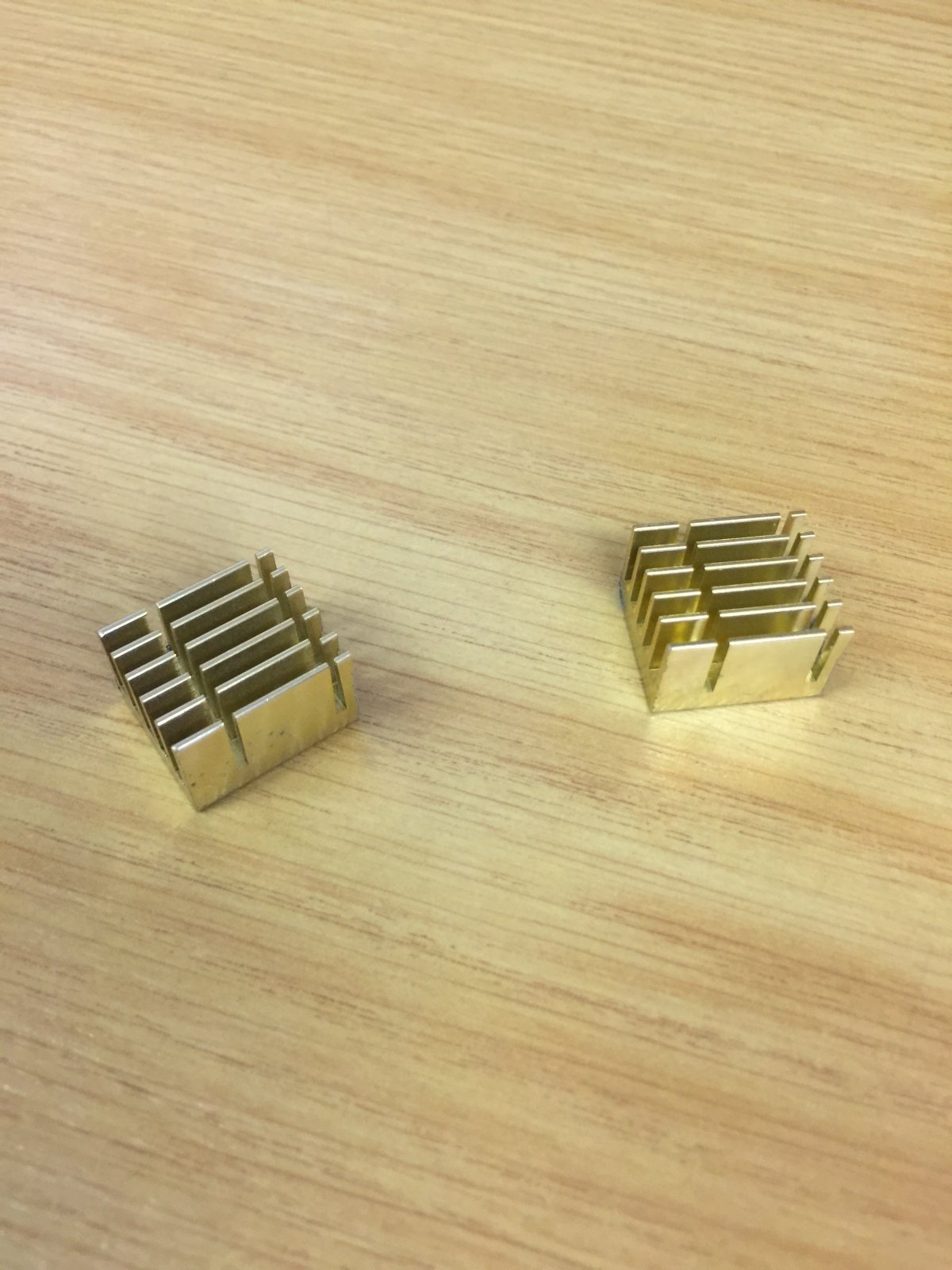

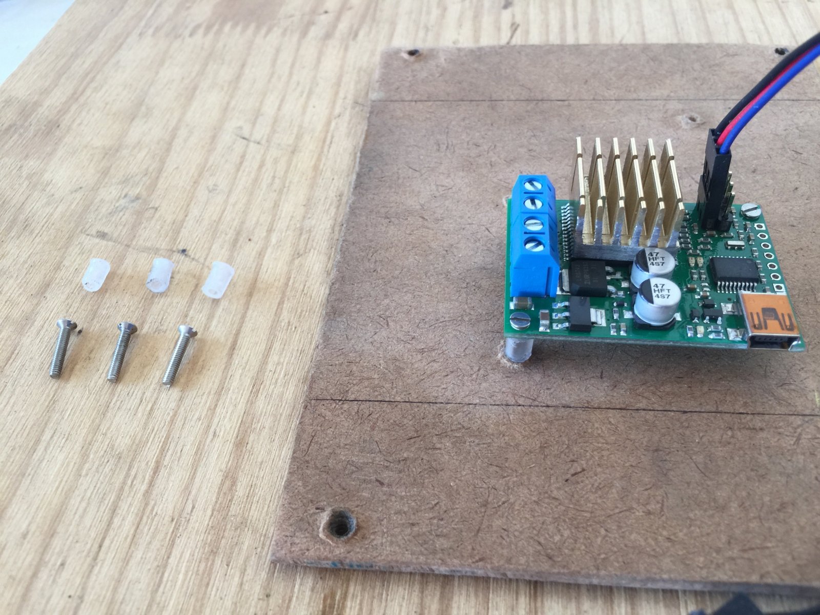

    Made some nice gold coloured heat-sinks out of an old mother board heat-sink that I salvaged.
    And some custom see-through plastic risers for the JRK's
    And finally started getting the wiring underway

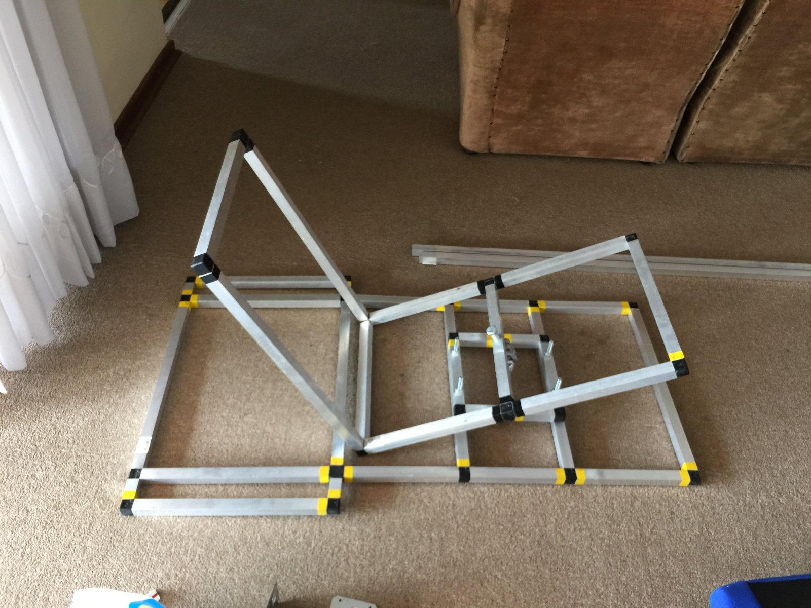

    Here is the base and chair frame laid out, just need to add reinforcement and set the height of the chair base correctly.
    Finalized JRK Wiring

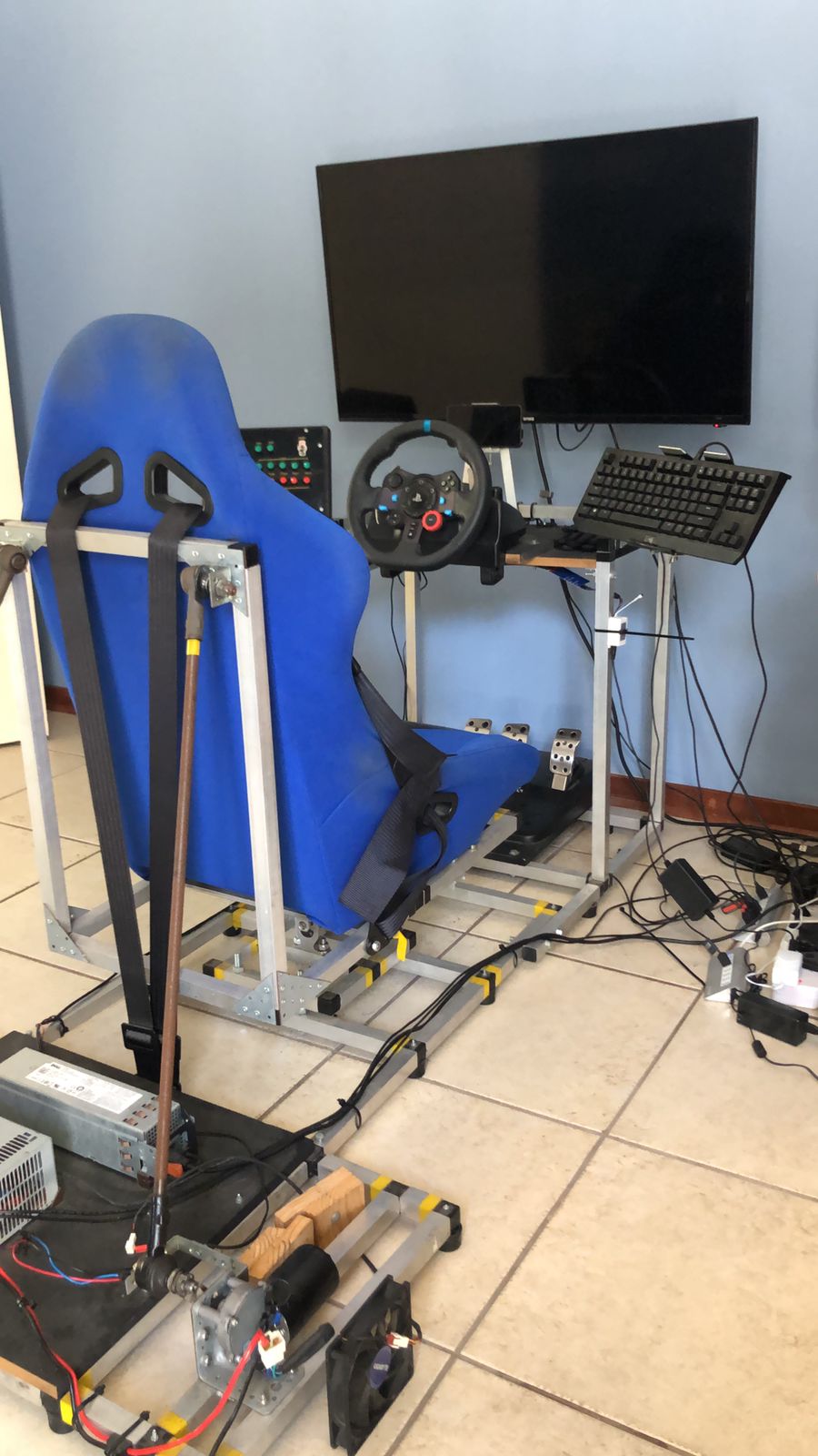

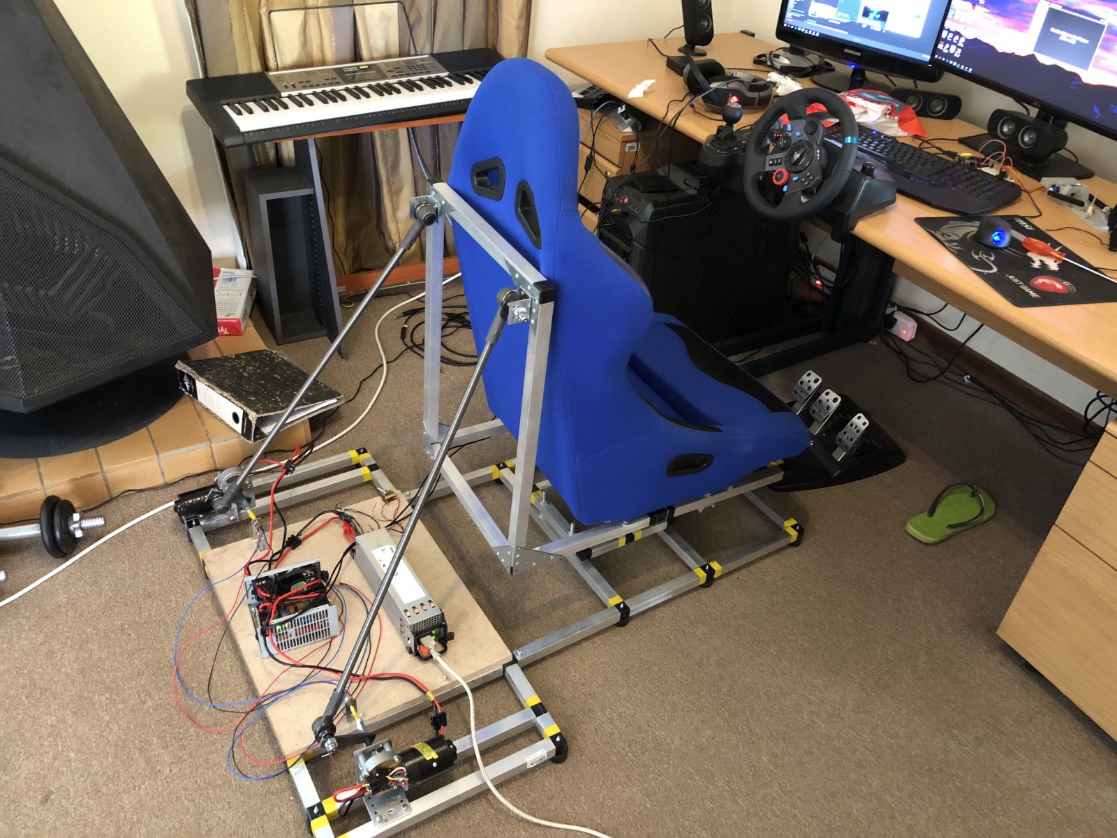

    Hey there all you DIY guys!

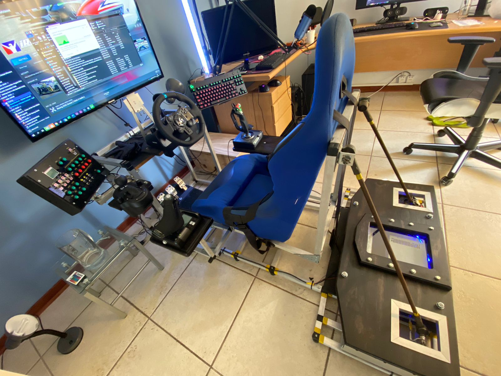

    Its been over 3 years since my last update but just like to let you guys know the rig is still going strong!
    Other than a couple of replacement Pots every half year or so, the rig is working reliably and excellently!
    I have made many many additions to it over the past 3 years but the basic layout and mechanicals are all the same.
    Here are a couple of pics:
    This is just before my final update over the past few months, you can see all the workings and the mess of cable management!
    And this is how it looks now, i also added some side platforms for my HOTAS setup for flight sims and space sims.
    These can be removed with just 3 quick bolts.
    Also added some RGB, because, you know... you need RGB :p
    Hope that this maybe inspires a few guys to go out and build there own, as it is totally worth it!
