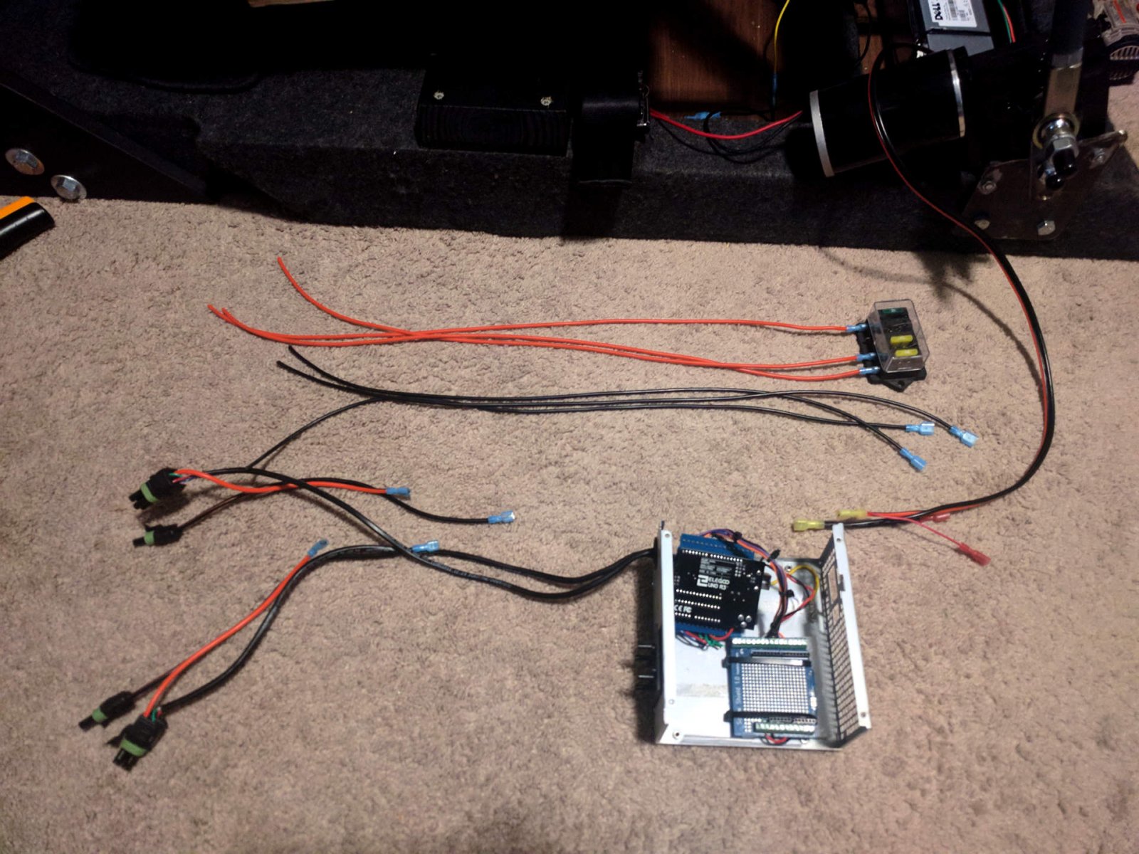

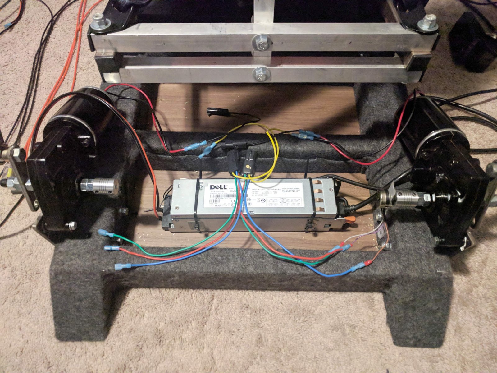

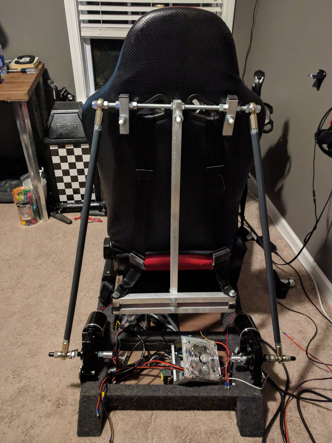

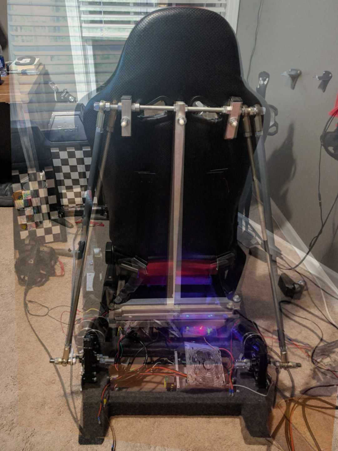

    Small update...
    While I'm waiting for the new monster motos to come in, I decided to go ahead and adjust the mounting points at the top so that the angle is less dramatic.
    I also bought some PVC pipe to cover the threaded rods just to clean up the look a little bit, swapped out some of the nuts on the motor axle with locknuts, and am working on redoing some of the wiring
    ( overlay compared to before: )

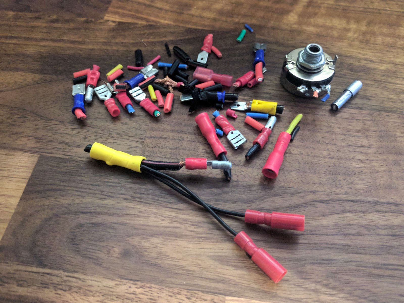

    The old wiring graveyard. These walmart connectors and my cheap-o crimping tool were junk, plus I didn't have much experience crimping so I'm sure I didn't do it right; I even had one (the main 12v+ coming off the fuse box) that was loose and was showing signs of overheating.... I'll keep a closer eye on this new batch, but I used much higher quality connectors and got better crimps
    Unrelated, one of my pots over-rotated with a runaway motor a couple weeks ago when I hooked up the new motors for testing, I've replaced this but it wasn't hooked up for the pictures.
    I have much more confidence in the new connectors, if I notice anything funky going on with these after use, I'll make direct solders where possible after I do some shakedowns with the new motors.
    I've now done everything I can think of while waiting for the motor controllers... time to twiddle my thumbs

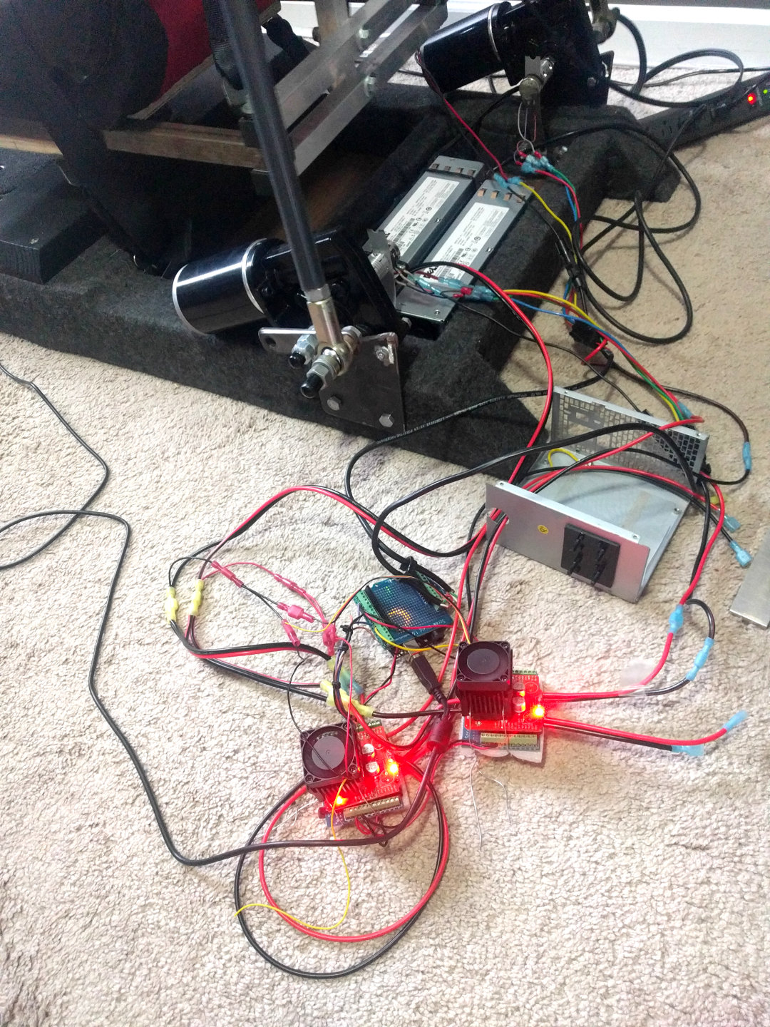

    Well guys, the 3 new motor controllers FINALLY came in after 2 months.... and they are all 3 bad. One board has one underpowered chip, one had no working reverse for either chip, and one sent my power supply into protect mode regardless of PWM setting.
    From ebay seller alice1101983, and they were also not helpful with the shipping issues and I had to twist their arm (and get ebay involved) to get them to do anything. I'm marking that seller off of the list of 'good sellers'.
    One of the new ones and the original old one I was using both have one chip each that are good, so my next step is to wire up one chip from each one of the boards to each motor; hoping to make progress on that early next week.
    I've ordered more from another seller, so once those come in since I'll already have the "one dual chip monster moto per motor" setup in place I'll go ahead and wire the (hopefully 100% working) new boards up as 2-into-1 to get 60 amps per motor.

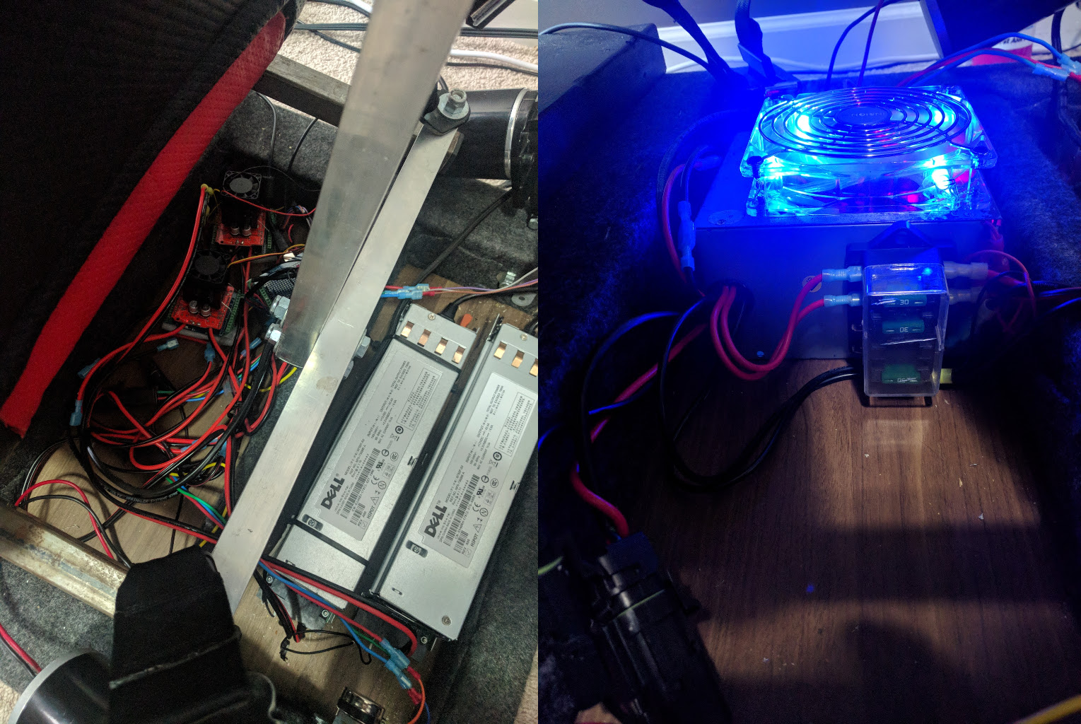

    I ended up waking up early this morning and getting right into the dual-controller setup before having to leave town for the weekend... IT WORKS!
    My wife thinks it's going to catch on fire, can't say I blame her haha! I'll work on tidying it up when I get back, I'm also going to wire it up for one power supply per board. Right now the second one is just sitting there unplugged and I made a split for the power from the other one.

    I just got done with a shakedown run with a single power supply for each monster moto, everything worked great for about 2.5 hours then I started noticing motor fade. I was in the middle of a 'ring lap so I waited until the end to check on things and the motor housings were too hot to touch for more than just a couple seconds. I measured them at 145F.... the motor controllers were just barely warm to the touch so the new heatsinks+fans are working great there.
    Is this kind of temperature common? Should I consider lowering the pwmMax to keep the temps down, or just look into adding some fans to aid in cooling? I have some room to play with the pwmMax, I was running at 255 and some car/track combinations were actually hurting me from how aggressive the motors were during shifts or running off the track.
  15. noorbeast
    21,669
    151,668Coins
    +11,045 / 56 / -2
    No that sort of tempeature is not common and either the design, settings, or both, are overstressing the motors.

    Thanks, the settings are the easiest to take a look at so that's where I started.
    I had a sneaking suspicion that the constant electric buzzing from the motors wasn't normal (you can hear it if you crank the volume up in the last video I posted), I assumed it was from having a pwmMin set of 30 that was causing them to never be able to rest fully, but it ended up being more than just that.
    I poked around in the SMC3 code and added some debug serial output and noticed that the motors were constantly fighting back and forth on themselves even when they were where they should be. Turns out my potentiometers don't have the cleanest signal (they are perfectly stable when I have the power to the motors turned off, so there's unsurprisingly some interference probably from the motor windings), so I added in a 'running average' style read for the last 10 pot values. I saw that a hardware fix for this may be ferrite clips around the signal wire or bridging the signal and ground for each pot with a '104' ceramic 0.1uF capacitor; I don't notice any delay or loss in fidelity from the 10 value running average, but if I do then I'll give the capacitor a shot.
    I also ran through the guide for the SMC3 first time setup to get new numbers all figured out.
    My idle holding noise is completely gone, along with all the buzzing and whining that used to happen during any movement at all.
    The motors are cold to the touch even after 30 minutes of running the SMC3 'motion' test, where previously they would be warm after just that.
    It's way too late to do another shakedown test, but that will be the next thing I do. I did a test using the joystick control plugin while sitting in it and the movement is noticeably smoother and more precise now too. I'm feeling really good about this fix.
    Just while typing this I had the Sine Wave test running and forgot about it, it's that quiet now!

    Are you still planning on running the capacitor or are you happier with the code running the averaging?
  18. armpit
    armpit Active Member
    Jan 7, 2016
    128
    Software Engineer
    SC, USA
    - 8Coins
    +132 / 0 / -0
    For the averaging of the potentiometer reading, they are polled once every few microseconds and the value they return (0-1023) is used to know where the motor is so the pwm can be calculated. I am still polling the potentiometers at the same rate, but using a rolling 10 value average, so if there's one or two numbers in that range of 10 values that are a little higher or lower, the overall average that is returned won't fluctuate as much so the pwm will be 'smoothed' over the next dozen or so microseconds. Not talking about a lot of time passing here, so the delay is negligible.
    I actually did change to using a 0.1uf ceramic capacitor '104' bridged between ground and signal on the potentiometer for each motor and made a before and after video I meant to post up here. You can hear the sound pretty clearly in the 'before', this video was taken with the 10 value smoothing workaround NOT in place. The capacitor method is the better choice because the real value from the potentiometer is being immediately used rather than a running average, though either way is about the same.
  19. nnamssorxela
    nnamssorxela New Member
    Jun 14, 2017
    Colorado, USA
    164Coins
    Great work! If I understand you correctly, you say that the video was filmed with the averaging not in place. Are the motors still staying cool to the touch after similar stress testing?
    Does using the capacitor to clean up the potentiometer signal still leave you with the noticeably smoother action mentioned in your quote above?
  20. armpit
    Jan 7, 2016
    128
    Software Engineer
    SC, USA
    - 8Coins
    +132 / 0 / -0
    Yes the motors are still staying cool, this is part because of the capacitors keeping the potentiometer signal clean and part because of fine tuning the pwm minimum, maximum, and ramp-up curve values in the smc3 application.
    The smooth action was also from going through and fine tuning the pwm values, specifically the pwmMin being set to zero instead of 30 so that small adjustments can happen without being jerky and overshooting slightly.
    Might have also helped that I cleaned up the wiring.... :)
