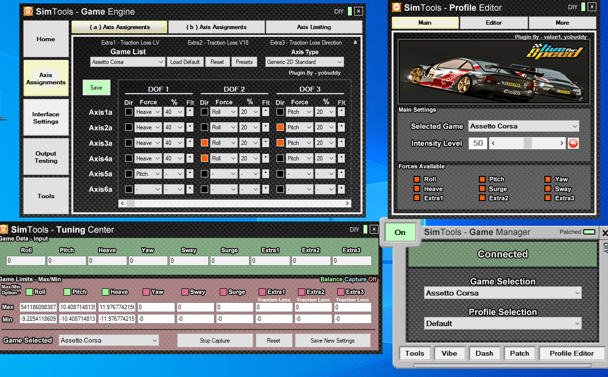

    Hi- I've just finished a DIY build of a DBOX style system. Everything works, except the signal from the game to Simtools. I have added the Assetto Corsa plugin, and Game Manager is showing as connected- but when I run the game, I get nothing.
    Any help appreciated.

    Can you please post pictures of all of your settings, including one showing the Tuning Center while the car is driving on a track.

    Sorry if I am being stupid! this is all very new to me. When the game starts, the actuators move up from their rest position, but don't move at all during the racing.
