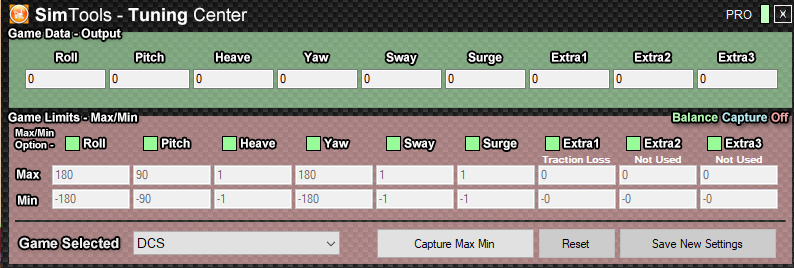

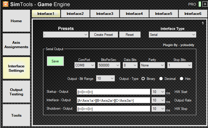

    Hey XSim Community i hope you all doin well i have received my DOF Reality H3 3DOF Simrig a couple months ago since that i tried getting DCS to work and i hope i will get some Help from you Guys.

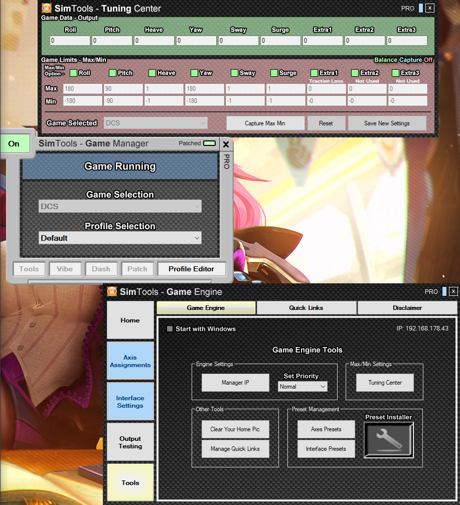

    i have the plugin installed via Game Manager and checked the Export file created under J/Steam Games/steamapps/common/DCS World/scripts <-- Export.lua was created
    green flag and blue flag ingame manager while DCS is running

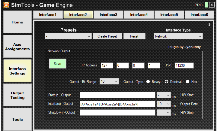

    axis configured as DOF Reality provided
    game interface as DOF Reality provided
    im using the Steam Version of DCS but already tried the Normal Version but the was no Output too
    i hope you guys as professionals can help a noob with his problem
    if there are any Questions or if you need moreInformation to understand my problem just let me know
    Best Wishes Niklas
    PS:(im sry for my bad english im not a native speaker)
    Export.lua down there...
