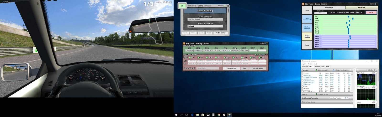

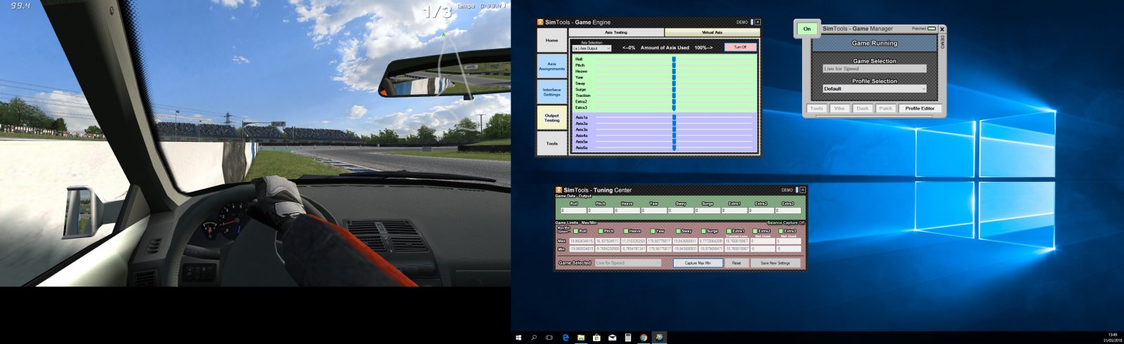

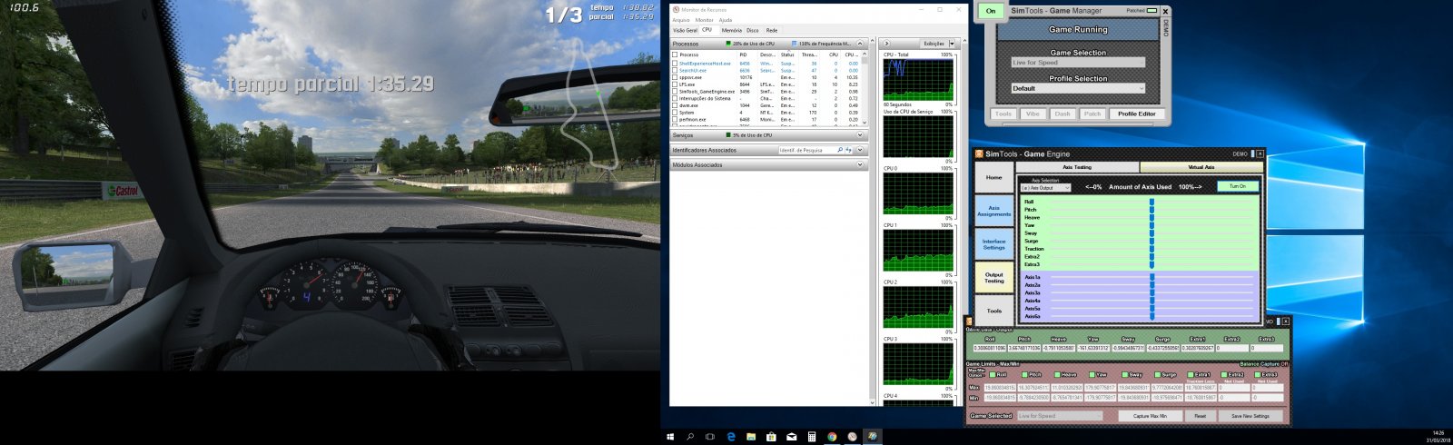

Resolved No game data output (LFS with demo simtools v2.2)
Discussion in 'New users start here - FAQ' started by Haraguchi, Mar 31, 2018.
  1. Haraguchi
    Haraguchi Member
    Dec 13, 2017
    77
    Gas rig operator
    Brasil
    120Coins
    +72 / 0 / -0
  2. value1
    Jan 9, 2011
    2,184
    Zug, Switzerland
    14,938Coins
    +3,328 / 11 / -1
    Install LFS and run it once at least. Only then patch it. Check in the file C:\Games\LFS\cfg.txt (or wherever you have installed LFS), if there are the entries
    Code:
    OutSim Mode 2
    OutSim Delay 1
    OutSim IP 127.0.0.1
    OutSim Port 4123
    OutSim ID 1
    OutGauge Mode 2
    OutGauge Delay 10
    OutGauge IP 127.0.0.1
    OutGauge Port 4124
    OutGauge ID 1
  3. Haraguchi
    Haraguchi Member
    Dec 13, 2017
    77
    Gas rig operator
    Brasil
    120Coins
    +72 / 0 / -0
    I uninstalled all sofwares, simtools, xsim, lfs.
    I downloaded the ccleaner and did a registry cleanup.
    I've reinstalled Simtools and LFS I played LFS I set the Game Maneger again.
    Now, it worked!
