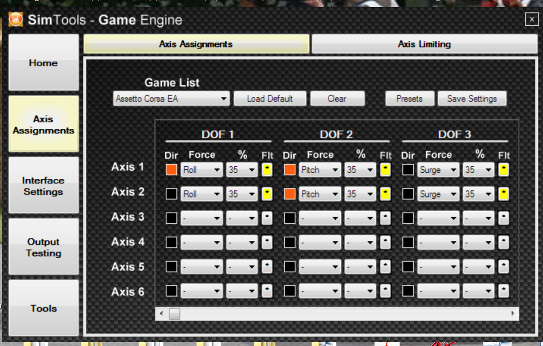

    Hi there.

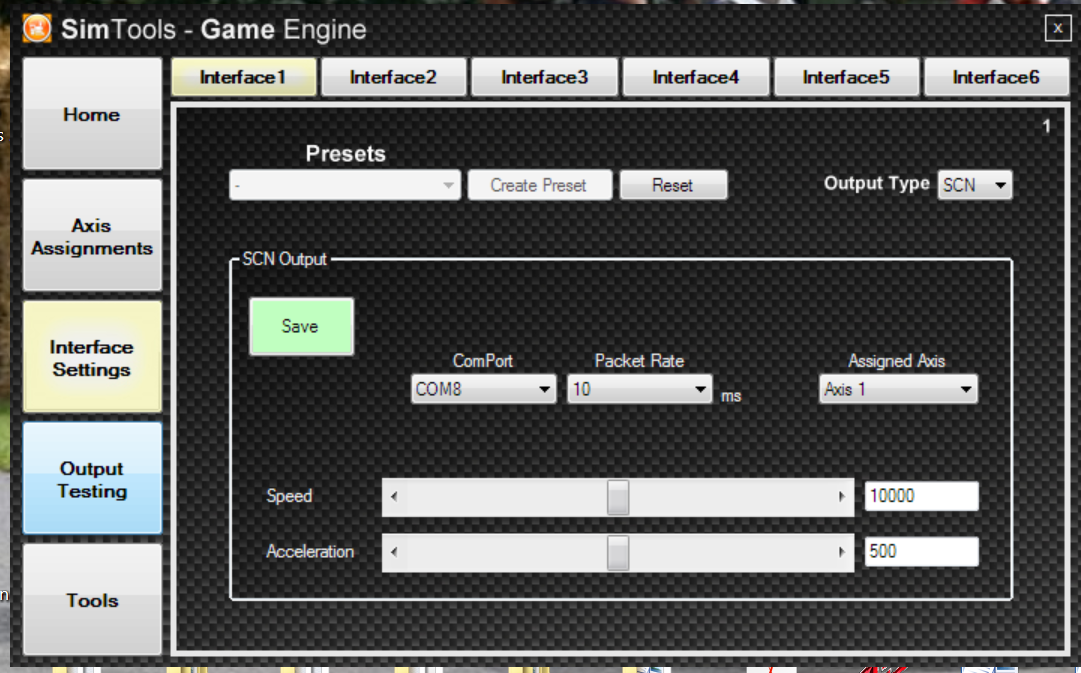

    Today I tried to connect two SCN5's, (the third is on its way) to SimTools.
    I followed the directions stated on the quick start, uploaded the plugin for Assetto Corsa, then assigned the axis, assigned the interfaces, COM8 and COM3. Both SCN5's have ID :0. I ran the game, saw movement on the Virtual Axis. I connected and powered the SCN5'5 and with game turned of, tried to test them. No movement at all. The green lights on the converters never blinked. (They blink when the converters are connected to the powered hub). I was concerned about the converters and ran a loopback test using Hyper Terminal. Text is sent from the keyboard was displayed and the green lights in the converter blink with each keystroke.
    I checked the support forum for the game manager and game engine, without a result that could help me, I am including screen shots of the configuration, and will continue to look for solutions, but any hint or workaraund would be greatly appreciated
    Axis Assign,.PNG Axis Assign,.PNG Axis testing.PNG Capture.PNG Interface 2 assign..PNG Capture.PNGGame Manager.PNG Capture.PNGInterface 1 assign..PNG

    @nclabs may be able to advise, as he is a SCN guru.
    I did notice your speed settings at 10000 are way higher than the SCN guide suggests as a starting point: With the Speed bar you can adjust the speed of the actuator, select a temporary value of 10.000 (value that you can increase after some testing).
    Can I just confirm that you followed the SimTools Quickstart guide and tested the actuator movements in the Output tab of SimTools, as it is not clear to me if you confirmed the actuators are communicating with SimTools or not: http://www.xsimulator.net/simtools-quickstart/

    Thank you very much for the prompt reply and for the suggestion

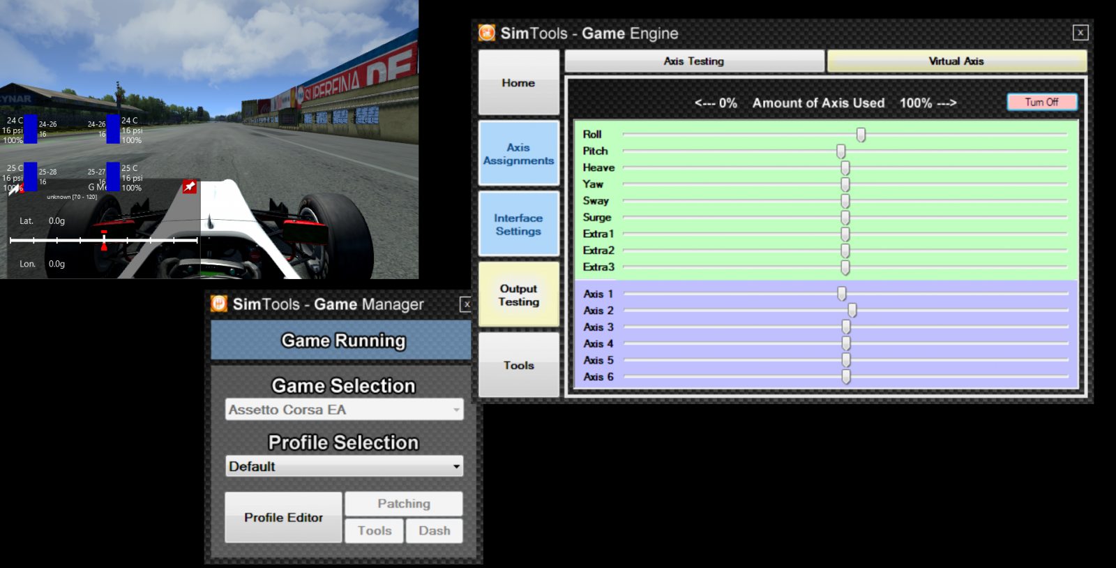

    I changed to 10.000. No change in behavior.I did test using the Axis testing tool, no movement of the SCN5's and the green lights indicating data transfer never blinked. They do when I test the converters using Hyper Terminal. Game engine is using data from the game, as the Virtual Axis screen indicate changes in all forces and angles.
    Before I tried the Axis Testing tool I ran the game in tuning center and saved the captured MaxMin. Tomorrow I will uninstall and re-install SimTools, and follow the quick install guide carefully, and see if I overlooked any detail, specially in the Game Manager.

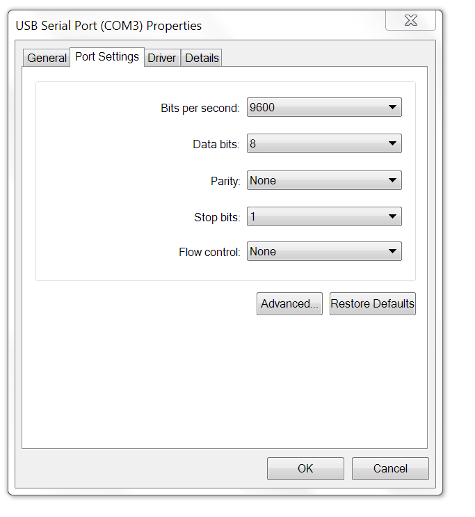

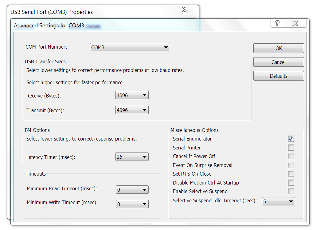

    Could you show a screen shot of the properties of the adapter in device manager?
    Other than that, I would check your wiring, and weather ink pin (pin 8 I believe) is switch the right way in order for them to startup.
    Please try one by turning the setting all the way un for each interface, save and restart Game Engine.

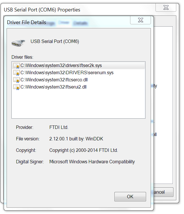

    Hi nclabs,
    The converters i am using are shown in the link below.
    http://www.banggood.com/USB-To-RS48...cpc&utm_content=saul&utm_campaign=xie-US&ebay
    The driver installed, 2.12.0.0 was selected by Windows.
    The driver details are listed on the screenshot.
    I checked power on the power connector of the scn5 and I see 24V between pins 1 and 2 and 19V between pins 2 and 8 .
    The schematic of the control box is shown in one of the posts above, in PDF form.
    Thank you guys for all the suggestions and tips. I should receive a scn5 this week and will try again. If it works , I might have a problem with the scn5's. If not I will order the Devantechs.

    Please try checking the 'serial printer' option for the converter and try Game Engine again...
    let me know how it goes!

    I tried with serial printer checked, and no response, even after i downloaded and installed the latest FTDI driver (2.12.6.0 ) for the chip in the converter. . I will order three Devantech USB to 485RS today. Simtools seems to configured right. The Virtual axis tool shows two interfaces in action, sway moves left and right when in turns, and surge moves a under breaking, acceleration and gear shifts. I measured the voltage between TRx+ and TRx- on the USB converter and it show 0.6V Voltage between ground and TRx+ is 1.3V, and between TRx- and ground is 1.23V. I don't know what I should expect in terms of voltage for the converter. Anyway, to eliminate the possibility that these converters do not work with SimTools, I am ordering the Devantech converters.

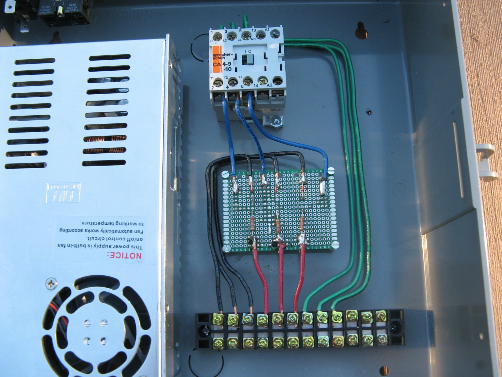

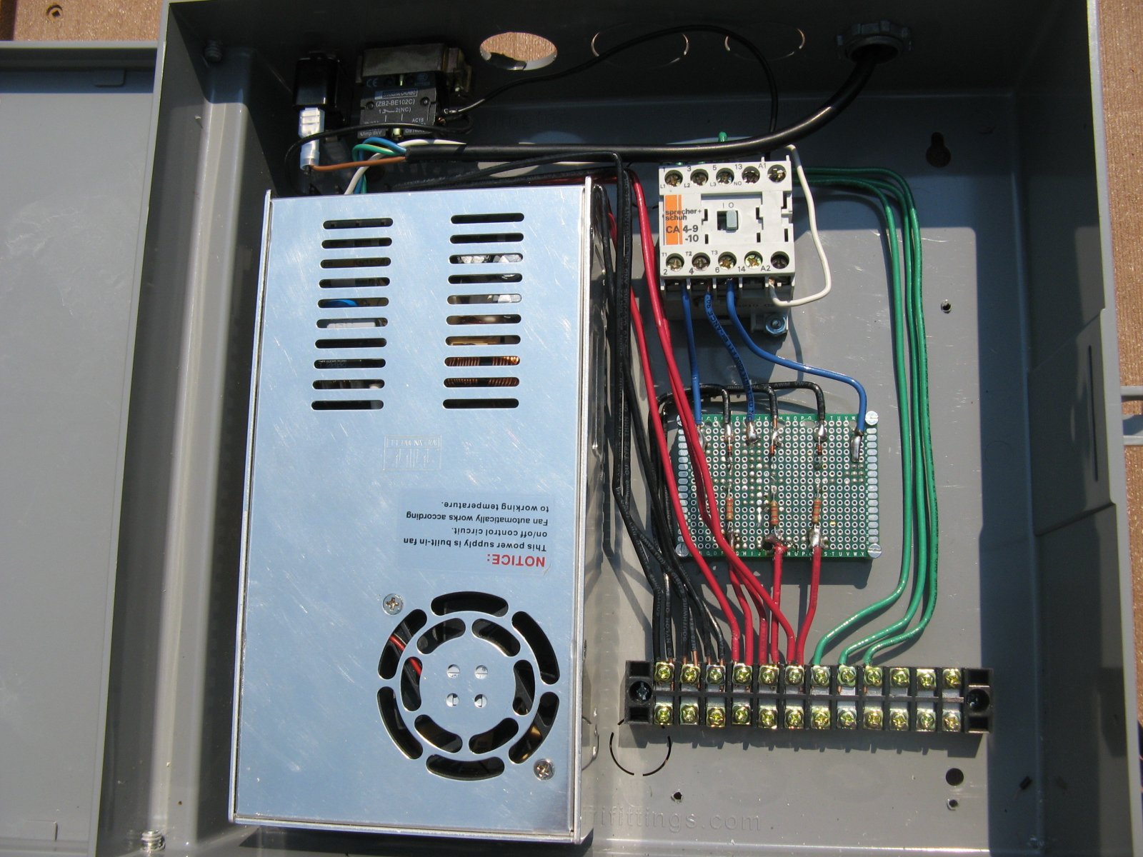

    I have ordered three Devantech USB to 485RS converters. After they arrive, together with the third SCN5, I will unninstal an re-instal SimTools, follow the Quick start guide and see what happens. It would be great if any of the experienced members here would have a look at the schematics I posted above and see if I didn't do anything wrong.
    I cannot detect anything out of the ordinary The photos show the control box. In the photo on the right, a partially wired box is shown. Black wires in the terminal strip are connected to GND (-) of the power supply and the anode of the 27V Zener and to and from the terminal strip to terminal 2 of the SCN5. The red wires in the terminal strip are connected to +24V in the power supply and to the 2.2 kOhm resistor, and through the terminal strip to terminal 1 of the SCN5. The tree short blue wires are connected to the junction of the resistor and the cathode of the Zener diode and to the bottom terminals of the contactor (which is triggered by the kill switch) The top terminals of the contactor are connected to terminal strip and to terminal 8 in the SCN5.
